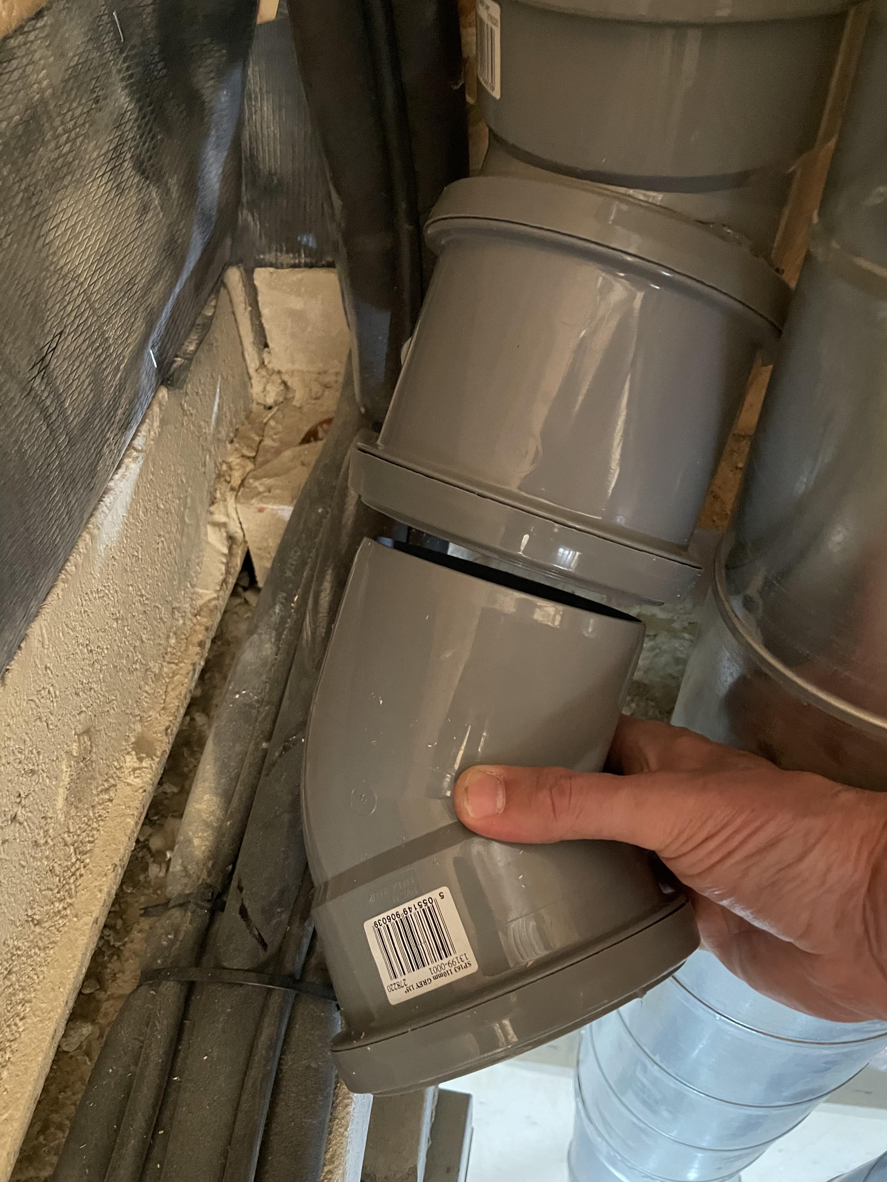

Stupid question. Are single jointed push fit connectors ok to fit upside down? E.g.
is there even a right way up?
Well I wouldn't, just because if there was a fault with the seal there's more likelyhood of a leak. I always think of things like that though and I don't know how often it would ever happen.

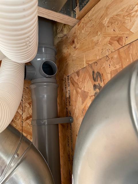

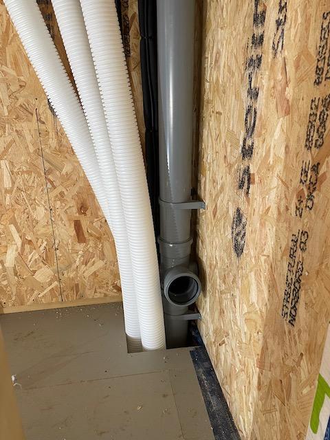

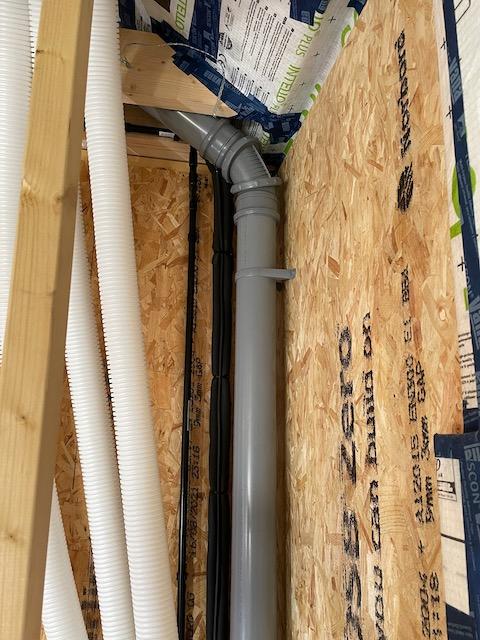

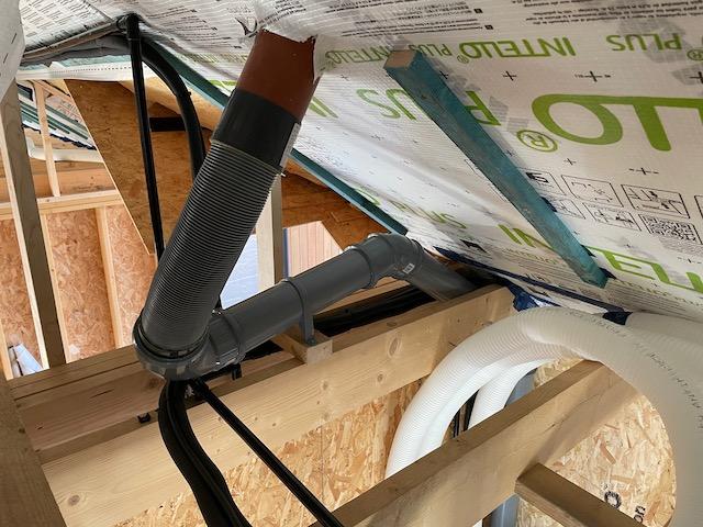

first bit of soil pipe done today. managed to join it up with our tile vent so I guess I now have an SVP. 🙂
above is the branch for our en-suite toilet. measured at 230mm center from FFL which seems to be standard-ish. it's only about 400mm from where the toilet will be so there shouldn't be any major dramas if I'm a little out I hope!

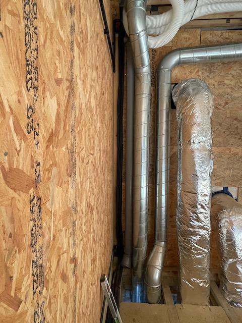

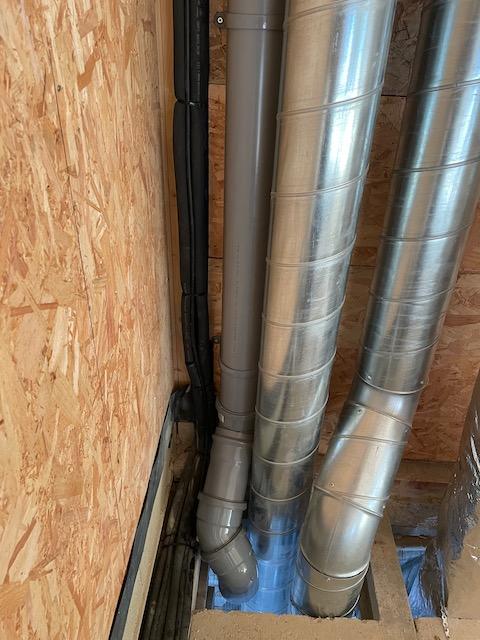

this then goes down through a service void where the ******* MVHR pipes/ducts are. damn they are annoyingly always in the way. I think I'd have finished hours ago if I didn't have to take 3 MVHR pipes off a manifold to move them out of the way to get the soil pipe through. anyway, it's done now and I'm happy with it so far.
MVHR pipes getting in the way of the boss fitting I installed. I was hoping to get to use 2 of the bosses but can only get to one of them now. will just have to run the shower, bath and sinks into the same waste pipe into the single boss hole.
will try and find a turd to throw down to test it.

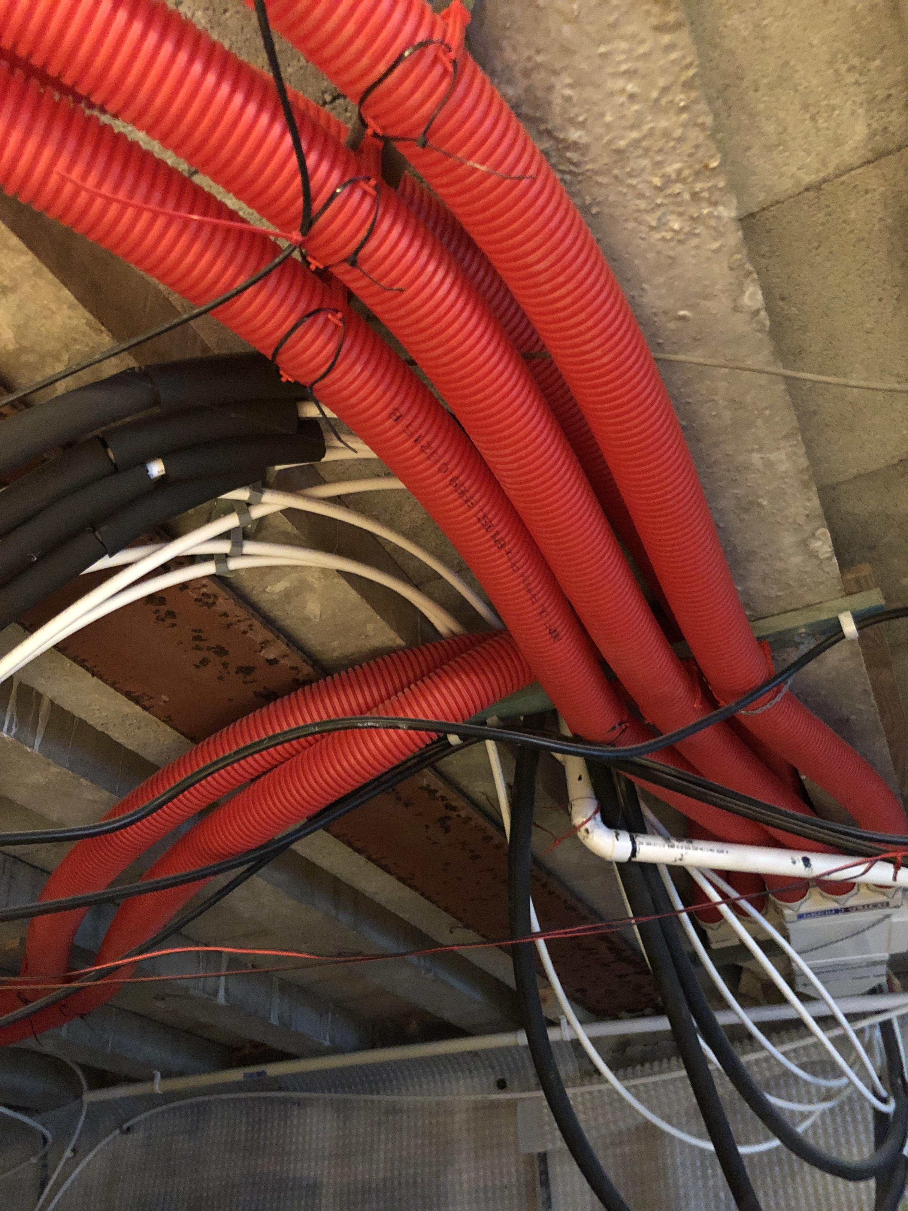

I’m waiting to see your hep20 mess 😁👍👍

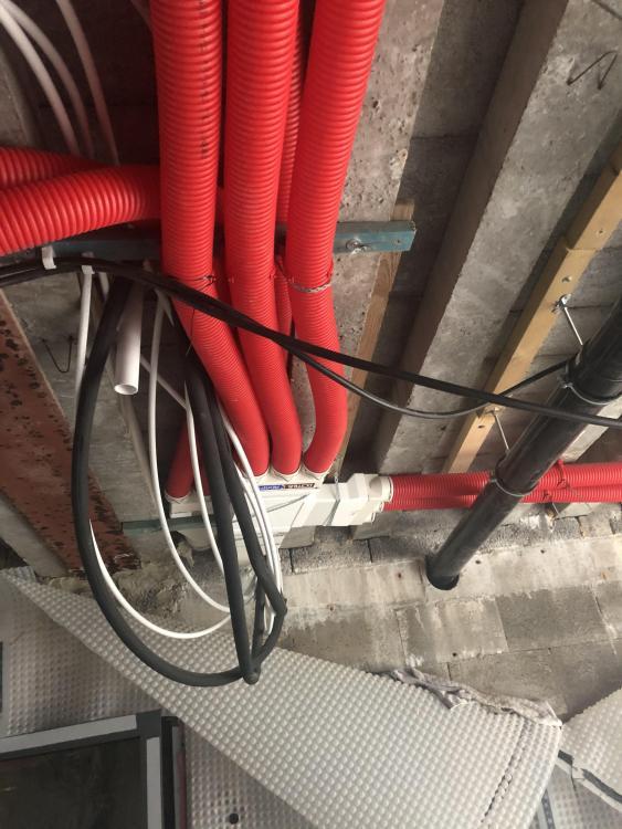

To make you feel better …..
It was all SO neat when I started with just 1 red pipe …. 🙄
Is that a camera angle thing or is there a bit of "downhill" pipe?
If so you have created a trap that could fill with condensation or leakage from the roof vent over time.
I'm glad you're here Dave! it is downhill but I didn't think it'd matter as it's just a vent pipe! didn't even think about condensation of leakage. I will fix that tomorrow. THANK YOU!!
