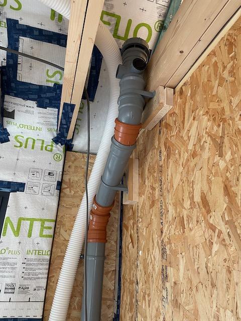

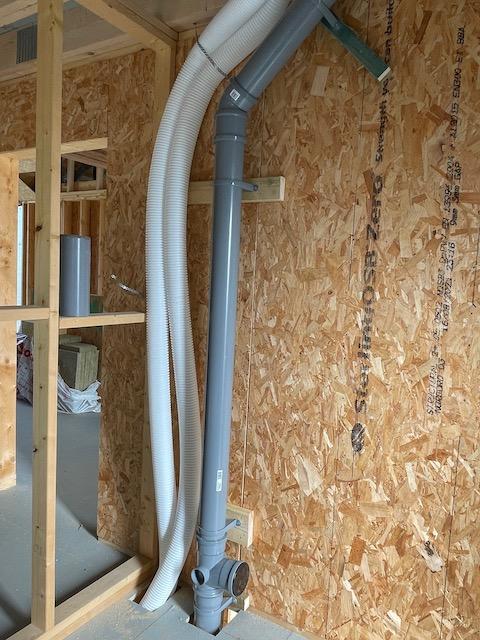

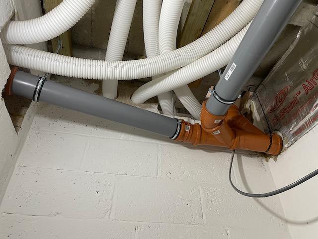

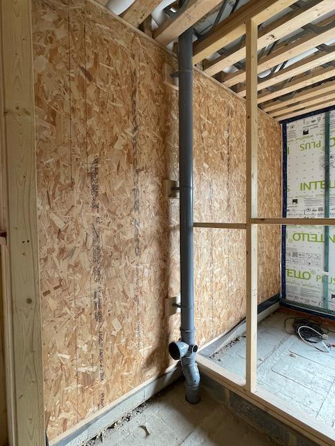

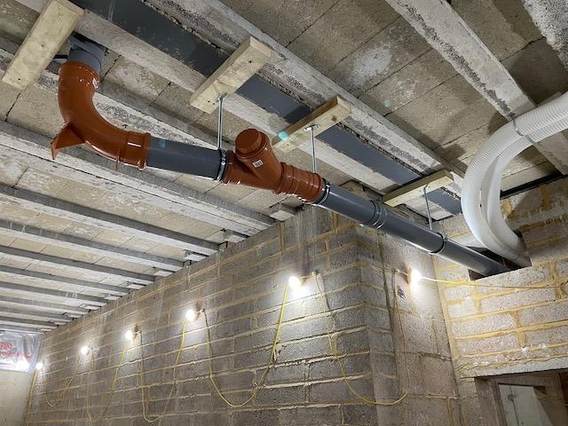

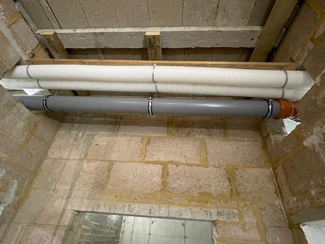

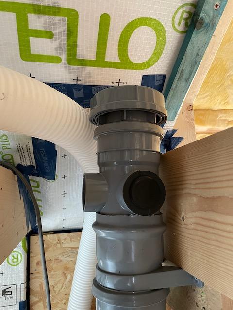

so I finished the internal 110mm soil pipes (mostly anyway, still go the en-suite above the garage to do). here's the 3rd run. starting in an en-suite
down to the downstairs WC
in to the basement where the rest bend takes it on the horizontal and I have a rodding point
across a hallway
to join up with the other 2 runs and out the basement wall
all look ok?

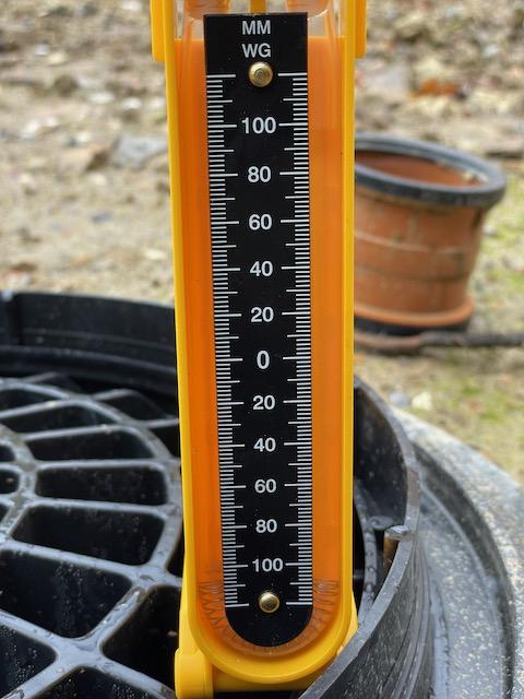

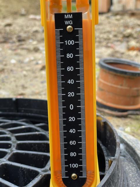

then I pressure tested the whole system (already did each run individually and was all ok so wasn't expecting any issues) and it passed with flying colours.
before:
after 5 mins:

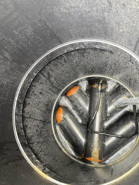

testing at the manhole outside

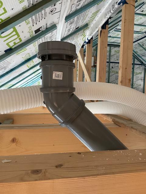

with all ok I fitted the AAVs on 2 of the stacks
IMG_4426.jpeg.353096dc655da55ea117b372b4fa2793.jpegIMG_4436.jpeg.dd478d1341e01c7ea35769a23ecc84f0.jpegIMG_4438.jpeg.ce8dede2324c035b4473e148273f88d0.jpeg
anyone notice any issues?

Don’t forget to strap the life out of that rest bend.
so what's there now isn't sufficient?

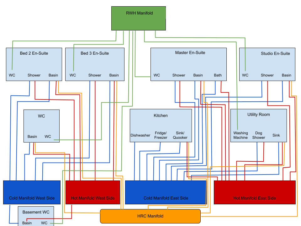

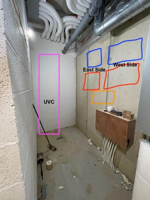

back to the plumbing manifolds. this is the design I've come up with. as there were no previous comments on the last design drawings I figured there weren't any major issues.
it's a LOT of pipe!
here's a photo of my plant room and where I was thinking of putting each manifold and the UVC.

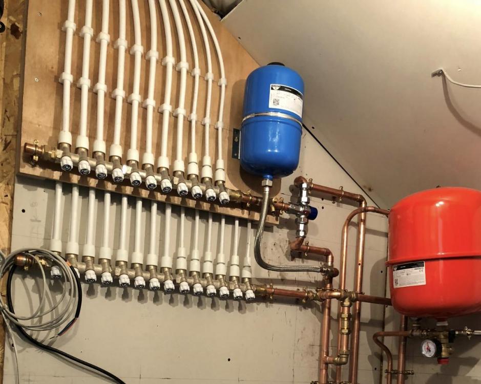

was going to put the hot manifolds against the wall and the cold ones sitting in front proud of the wall to save a bit of space (not that space is short in the plant room but I quite like the efficiency of the staggered manifolds like in this photo of someone else's setup taken from a thread on here.
02F17166-4C39-4692-8B10-1F4552F1ACCD.jpeg.18c1f84c6c475d30a6433c61fd275811.jpeg.1be3ba2c4edfcf311bcb1cd69f2ba5f6.jpeg
I have read many discussions on here about the size of pipe and have decided for simplicity to simply run 15mm everywhere and the HRC in 10mm. I know I could do the basins in 10mm but if I'm running an HRC to them then that will clear the dead leg and so I can use the 15mm without worrying about that side of it.
anyone got any comments/suggestions/criticisms/plaudits before I purchase the plethora of manifolds and start running pipework!

15mm everywhere . That’s means you purchase one lot of pipe and fittings . Easier if it’s all one size and (expletive deleted) anyone else who says different. I’ve built an entire house on 15mm ( as advised on this forum ) so why change .
THERE ! I’m right again .
Of course. Us professionals cannot possibly allow you, as a newbie, to get this right first time now can we?! :ph34r:
So;
OK.
The rest bend will eventually fall off. Do as Bruce says above, and clamp that well. The shoe on the bend is supposed to be where the thud gets arrested, but that’ll be off before you know it :/
