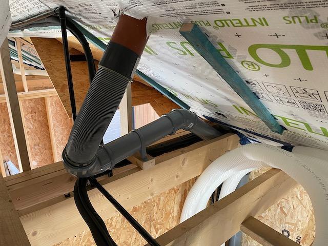

October 10, 20224 yr @pocster and @Thorfun those hangers, you get a length of threaded rod and cut it to length then you can make any hanger you want. As @ProDave said ,that bit in the loft is a bit horrid, the first bend coming from the vertical pipe need cutting back as you have a section of pipe with a back fall on it. If it looks right it generally is, if it looks a bit fugly then it’s normally not to flash. That bit in the loft is fugly.

October 10, 20224 yr Author Just now, Russell griffiths said: @pocster and @Thorfun those hangers, you get a length of threaded rod and cut it to length then you can make any hanger you want. As @ProDave said ,that bit in the loft is a bit horrid, the first bend coming from the vertical pipe need cutting back as you have a section of pipe with a back fall on it. If it looks right it generally is, if it looks a bit fugly then it’s normally not to flash. That bit in the loft is fugly. cheers. will post a less fugly picture once I've rectified it tomorrow. it'll be the first job I do in the morning. 🙂

October 10, 20224 yr Right…… Number one schoolboy error. On a run supporting something such as this, you need to fit a clip, on the pipework, immediately prior to each fitting either end. If it looks like a see-saw, gues what it'll do

October 10, 20224 yr Author Just now, Nickfromwales said: Right…… Number one schoolboy error. On a run supporting something such as this, you need to fit a clip, on the pipework, immediately prior to each fitting either end. If it looks like a see-saw, gues what it'll do I figured as this was just the vent part of the SVP and wouldn't take any liquid/solid support wouldn't be needed. I guess that was an incorrect assumption!
October 10, 20224 yr I’ve just realised, you’re causing yourself a bit of unnecessary pain and suffering by not using fittings from the underground ( orange coloured ) range. These will give you 15o and 30o bends, whereas it looks like you’re mostly ( ore exclusively ) using 45o ( aka 135o ) bends?
