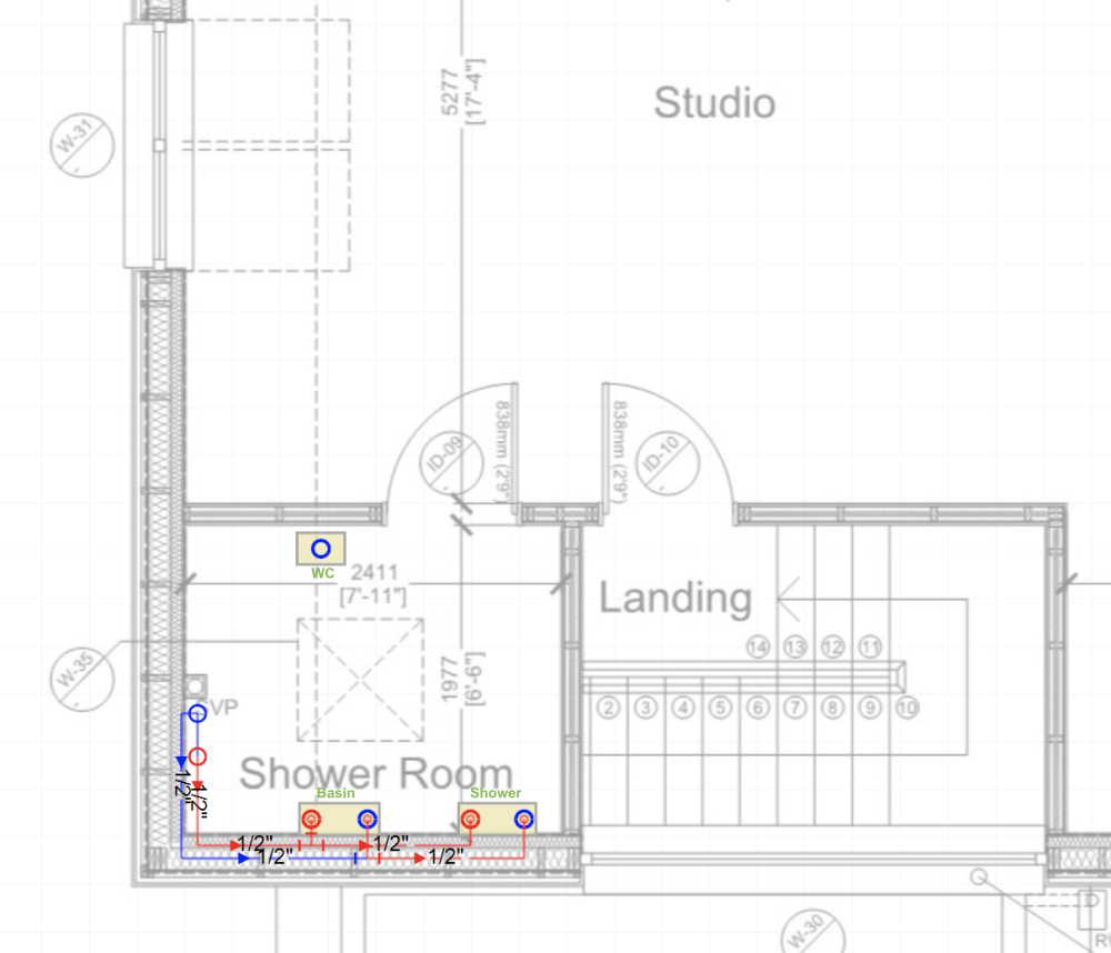

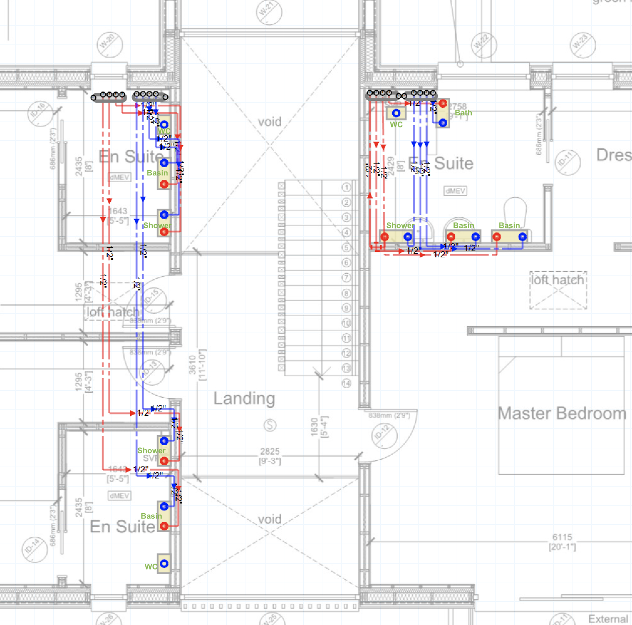

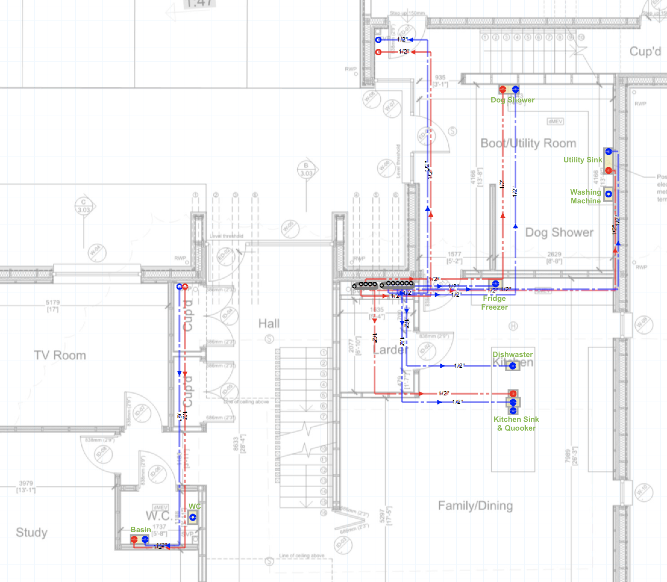

My self-build DIY plumbing
as I near the finish of the internal soil pipes (for now at least) my thoughts are now on the water pipes. I have decided to go with the radial manifold system. our toilets and washing machine will be supplied by a RWH header tank from the loft so they're not part of this plan but I am planning on putting a manifold in the loft to allow each toilet to be isolated individually if required.
Below are some screenshots of what I think I need but I have a few questions (btw, ignore any pipe sizes you might be able to see, I just couldn't be bothered to remove them and the software I used ignored my request for metric sizes anyway!).
In the master bedroom en-suite, we're having his and hers sinks. is it really worth having separate pipes for each sink or should I just run both of the same hot and cold?
In the studio it is a small and rarely used en-suite and so I figure I might as well just run a single hot and cold feed and run both the shower and sink of that. madness or justified?. it's also quite a long distance from the plant room (15m - 20m or so) so I presume it'll need an HRC?
Any of the other runs need an HRC? or should I just put one in regardless as it's a sensible thing to do even if our dead legs are minimal?
In the kitchen we'll have a Quooker under the sink. I've just got the single cold feed for the kitchen sink and Quooker as I see no reason to have the Quooker on it's own feed especially as they're in the same location. is that sensible or should I run a dedicated feed for the Quooker?
think that's it for questions for now. any other comments?

My view on this is simple . Had a manifold of manifolds and run a pipe to every outlet . My backs (expletive deleted)ed so I can think of nothing worse to getting under a sink etc. to isolate it . It costs more in pipework ( but less in fittings if you just let the pipe ‘ go where it wants ‘ .
For me to isolate in 1 place is fantastic - and I use this facility easily .
I’ve just added an outdoor sink and broke my own rule ; branched off the kitchen hot and cold - it just wasn’t worth the effort of 2 new feeds .
So in hindsight; an ensuite for example could just be 1 hot / cold feed rather than be a feed for each outlet I suppose . I guess it depends as well if you are living on a building site ( like I am ) ; the convenience of isolating each thing is great .

hopefully the house will be 'mostly' finished before we move in so won't really have a need day 1 to isolate, but the studio en-suite most likely won't be finished so will need to isolate that. I do love the idea of radial plumbing and the single point of isolation sounds great.
just looking at those plans and looking at all those pipe runs it brought it all home as to actually how many pipes that is! which is why I was thinking for the his/hers sinks we could isolate the pair from the manifold to save running an extra 2 x pipes. but, I think I'll probably just run them anyway.
ps. I have considered a hybrid version of two pipes to each room from a manifold and teeing off to each appliance from there. but, as you say, adds more in fittings even though it reduces pipe usage. but also adds joins which I'd like to get away from!

I guess it depends if you can get to those joins in the event of an issue . 95% of mine I can . But ; I’ve yet to have a Hep2o fitting fail !

I wish now I'd run a separate return from the basin hots. Could have had a bronze pump and "instant" hot, triggered maybe by occupancy switches.

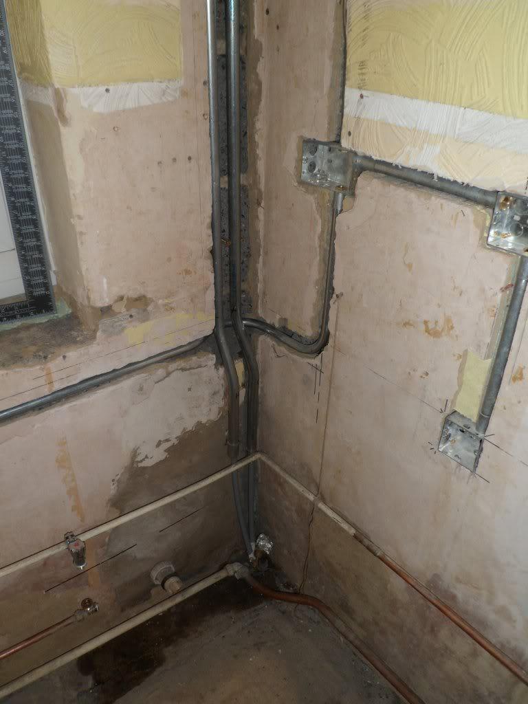

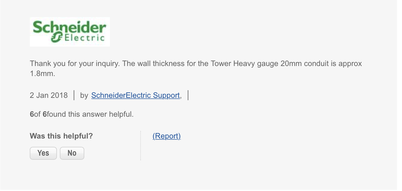

qq on this subject. I have a lot of 20mm electrical conduit lying around. can I use that for 15mm pipe?
according to this question on the SF page for it
so that will give an 18.2mm ID. a bit tight for 15mm hep2o pipe or should it fit like a glove?
Personally, I don't think that would be an issue, if it all fits, and you can push/pull through without bother and it stops the pipes being scratched/scored when pulling through something abrasive then all good.  maybe the quote is coming from the angle that when doing plumbing you are likely to have excess or offcuts of plumbing waste pipes to hand so that's what's used at the time as conduit.

I've put 15mm pipe in galv conduit before. Coming down in the corner of a wall. As a nod to mechanical protection:
It's just a sleeve so yes id it fits👍
The biggest killer of pushfit pipe is linear scratches caused by pulling long lengths in through cut various cut / drilled holes and notches which are sharp / abrasive / or worst, have a nail or screw in that you've not seen.
Pushfit fittings rely on the outside surface to create the water-tight seal, so be very careful to preserve this during 1st fix.
