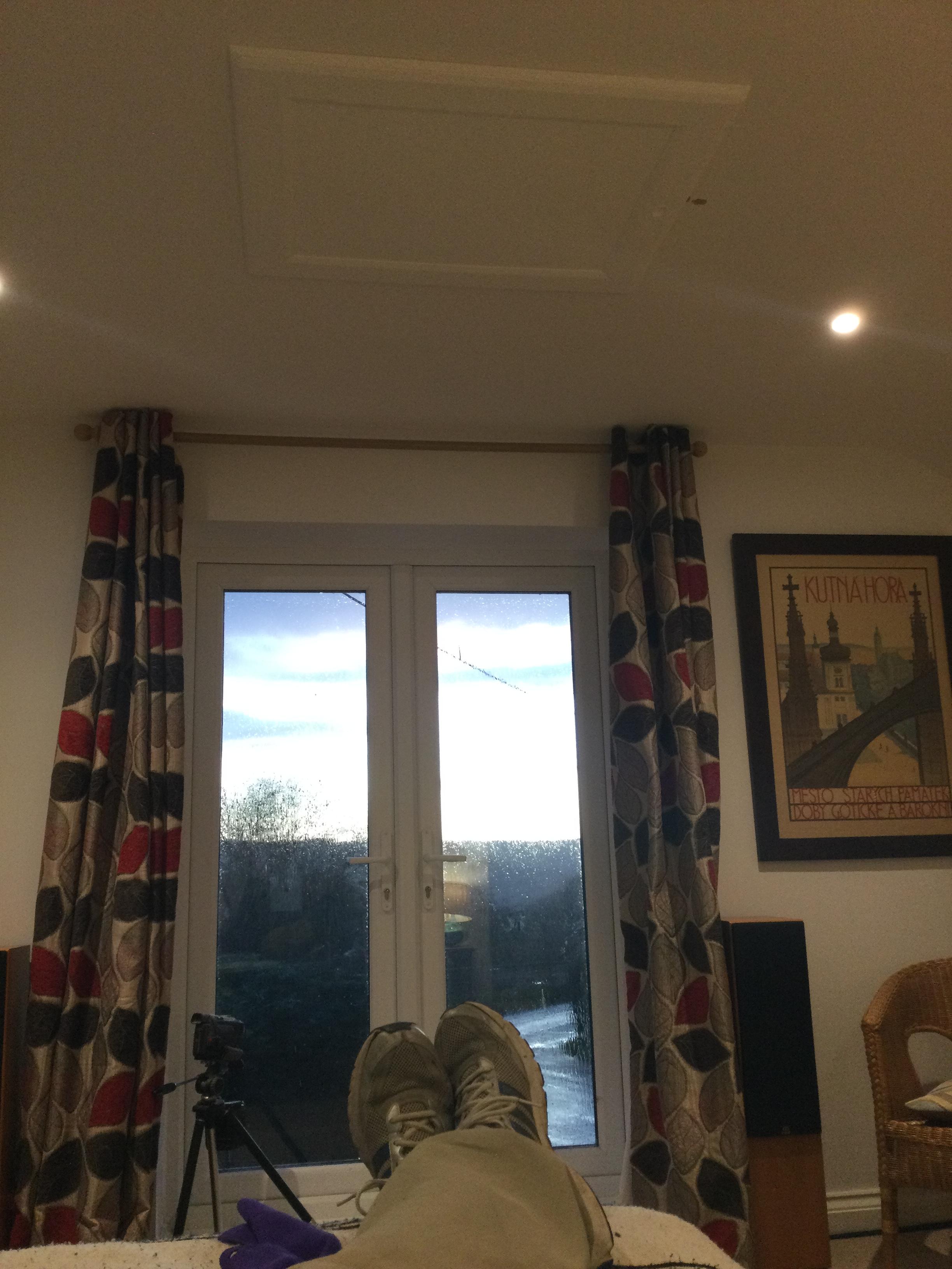

zoothorn Posted December 15, 2020 Author Posted December 15, 2020 (edited) 53 minutes ago, joe90 said: Insulation is fine but it only stops heat that you have from escaping quickly. If your heating is not working as it should all the insulation in the world will not make the place warm. I have masses of insulation in my new build but if the heating stops working eventually the place will go cold. Understood joe. But the heating is working as it should, in fact at 55* its working hotter than average for this system. The rad in this room is now quite often hot, and its a huge rad, but im always cold/ the room is never warm. Ive got it to 18*, once, but rad on all day to achieve this. Usually its 15.5* say, with rads on. Its hardly worth me putt8ng the ch on, like this ev i havent bothered just used my fan heater in kitchen & early bed ( now) in this cold room (with south park episodes on ipad). You get used to it, i am used to it.. but its galling knowing a toasty room is right below me, & without any use of the heat too.. in fact i think this situation might drive me bonkers tbh. Edited December 15, 2020 by zoothorn
zoothorn Posted December 15, 2020 Author Posted December 15, 2020 17 minutes ago, ProDave said: If the insulation just goes over the joists with nothing in between, then you will have a gap between the ceiling and the insulation. Understood. But what i found was altho its laid acroos the joists, bc theres another layer ontop of it, theres enoug( weight for it to sink prett6 effectively down between the joists, so very few gaps i found at all if any. why does thi# ipa£ do thes3 annoying symbols? I cant make i5 d9 it if i fkn tr6.
