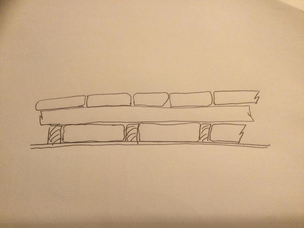

Sorry I'm not following your steps for the 2nd layer. I'm using the orange stuff for this (because its half filling the loft as it is, very hard to manoevre it away just to do the 1st layer, let alone pull it all out > replace with bought 200mm stuff > then put it all back up). Is full width 600mm?
I'm not following 'measure from hatch to builders sh*te..' nor the following 'now roll it up..' sentences. Total blank, trying hard as i can to think what you mean- apologies.
I thought the 2nd layer is to go in the same orientation as the 1st, but just over the joists. So then I'll have like a bumpy up, down, up, down effect.. which the 3rd layer rolls, running perp, have to snake their way over. Or do you mean just totally fill the whole area with the 2nd layer, in same orientation as 1st-?

Re- reading all info on how to do this, Peter Stark says put 2nd layer perp to the 1st.
So when its suggested put x "over joists"  i thought this meant over the top all along each joist ( so not perp, but the same way as the joist, bc the joist is the insulative weak point). But only Peter S's reply specifies which way this is relative to 1st joist, and is not the way I thought.
 If 2 nd layer goes perp to the 1 st, then i can see its possible to get some going up the wall. So its this 'over joists' i need to clarify.

Each layer should be in the opposite direction to the previous layer to minimise gaps and hence heat loss.
Right yes that seems the consensus. I got that ' over the joists' totally wrong then.
