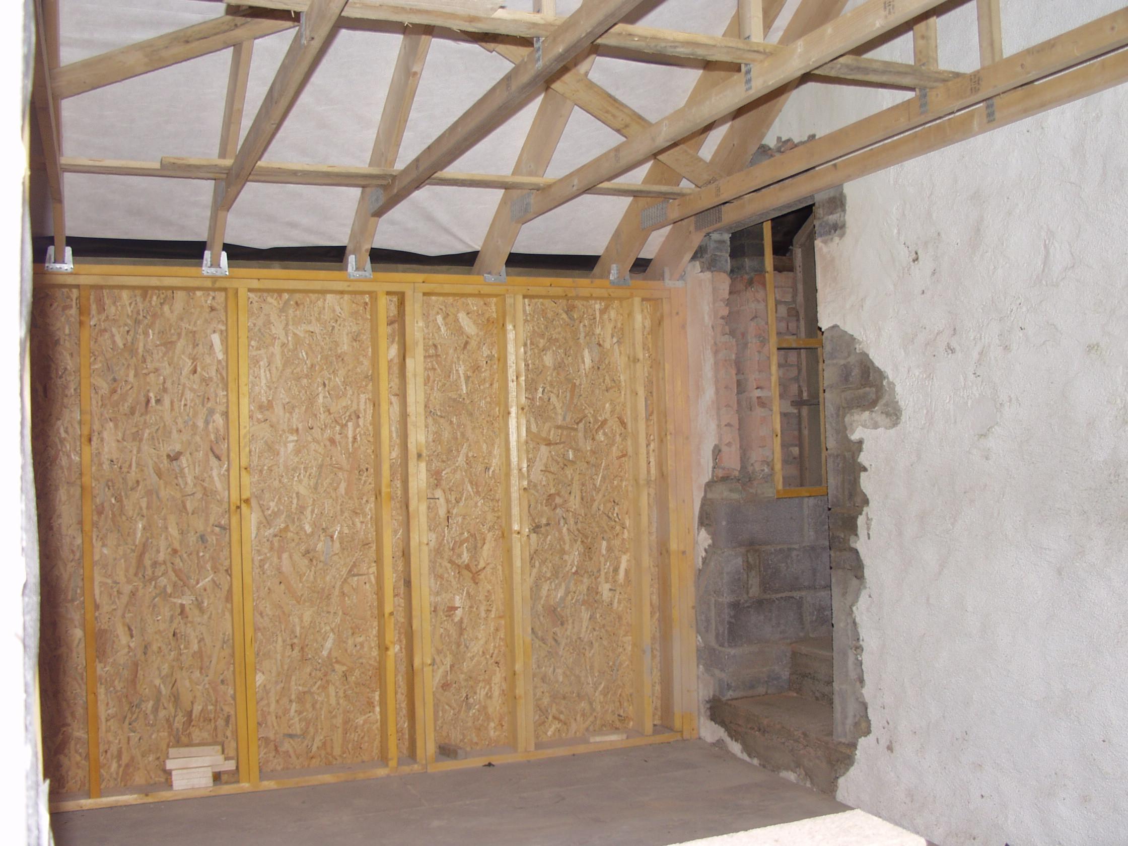

Here is only pic I have of my 600mm spaced joists- no noggins, just braced across the top afaict. So at the mo, its just got orange fluff rolls perp/ ontop of these joists.
Is this safe even to put my weight on?
Just now, SteamyTea said:
Yes
+1, yes.
Just now, joe90 said:
+1, yes.
Ok good. So I gotta put boards up/ across to do the job, & Im 14st tho eek.. I'm prepping now/ will start end of week when warmer makes sense.
If I got 590mm gaps on some, do I cut off 10cm or stuff it in, curl edge up?
As to what material to go for/ thickness.. what suggestions?
thanks zH
It will fit, just push it in, regarding thickness I would put in 200mm.
And then another 200mm on top ... ?
@zoothorn where is your nearest Wickes or B&Q or are you only able to go to Jewsons..??
Ideally, you want 3-400mm which is 3-4 layers of 100mm, but you can get it in rolls of 200mm thick.
First layer goes in the gaps between the joists, then the rest goes straight over the top up to the edges. It doesn’t need to be neat, and a 3m length of waste pipe is ideal to shove it into the edges where you can’t reach. More the merrier, just don’t block all the edges completely tight to the white membrane.
I’d you’re clever you don’t need to get up there apart from to put some plant pots over the downlighters as they shouldn’t have insulation directly over them. You can do that by kneeling on each of the rafters as you go.

Im a bit concerned with the rafters: in pic you can see they're joined just by those metal mesh to the diagonal truss bit above/ but not resting on anything this end. Opposite side they're resting on the timber frame inner wall, so weight on this end surely ok.

Those metal mesh things are amazingly strong - much stronger than the timber itself.
I guess they have to be to keep the trusses in one piece, but look flimsy & they do just press into the softwood 1cm afaict.. not meant to keep a 14stone ape from falling thru its own ceiling.
haha, honestly, they will support your weight and much much more.
