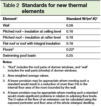

1 hour ago, zoothorn said:
I cannot see anything there, there's not even a '100mm' figure, and I dont see any notes..
Referring to Note 1.
For a wall, insulation between studs, 200mm of unbranded loft  roll (Thermal Conductivity 0.044W/m.K) is needed
For the ceiling 300-350mm are required dependent on exact configuration

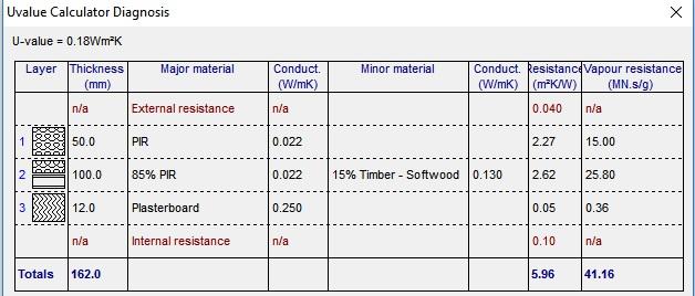

12 hours ago, zoothorn said:
I thought the point in Q was the rigid stuff in the sloped ceiling-? 100mm or thereabouts, I'm roughly sure
O.K. , assuming the 'rigid stuff' is PIR or similar and the timber holding up the ceiling plasterboard does not fully penetrate the insulation i.e. there is at least 50 mm of insulation covering the timbers then 150mm should be sufficient, see attached table. If the insulation is fully penetrated by timber, creating a thermal bridge, then 200mm between the timbers will be required.

12 minutes ago, zoothorn said:
But that doesn't compute.
It does compute, from Table 2 walls only have to achieve U=0.28W/m2.K but ceilings have to achieve 0.18W/m2.K. That implies 56% more thermal resistance (insulation).
21 minutes ago, zoothorn said:
I'm not sure if your point is telling me what the B.regs stipulate
B regs stipulate a max U-value, as in Table 2, which insulation and thickness you use to achieve it is up to you
