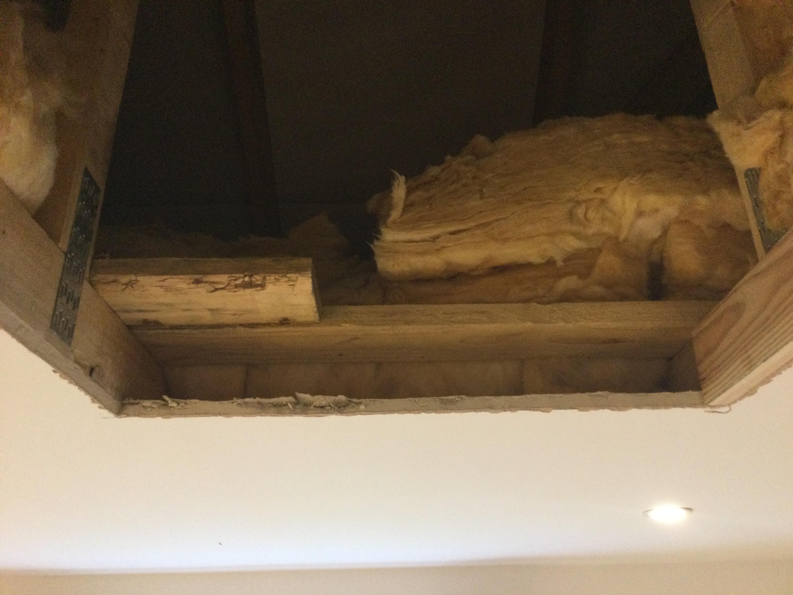

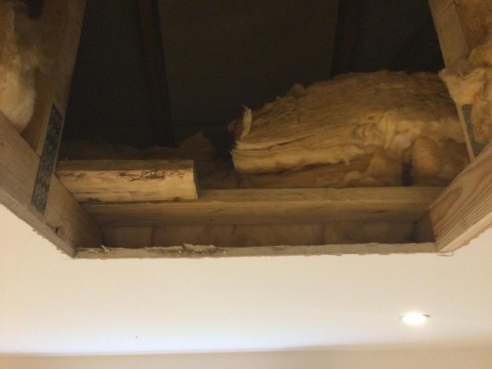

theyre not actually nogs, but bracing perp to and ontop of the joists. i wouldnt want to cut these, as they go 2.4 m or whatever, part of adding rigidity, i assume.
Can anyone help. im trying to put these two nogs in at the ends. One is feasable to do, tho how i can get access to the backside in order to get a drill driver to it ive no idea.
its the other end nog i cannot see how its possible at all. Ok i have some bracing across the tops of the joists, some sort of rigidity brace thing..   and two are in exact position hampering where the nog is to go. I cannot/ do not want to cut these braces, and redo as a nog/ this will ruin idea of these braces totally.
so.. can this hatch be put in without a nog one end? So it only attatches to the pb here.
Here are the two braces ontop the joists
Yes these are standard braces, you will have to wriggle your noggin in and screw in from the backs .then screw plasterboard to it/them.
Hi joe- I can't understand 'screw in from the backs'.
All I can see how to do this, is to get a nog precisely 7.2mm in height, in order to fit in this gap, vertically. But there is nigh on 0.1% chance of finding such a bit of timber. Then if I find this, I can't see how I can get access to it, in order to fix both ends in.
The only way I can see of fixing in, is from the top, down, thru this brace you can see > down into the 7.2mm H nog. But then it won't be fixed in at either L or R end.. so it won't have any solidity.

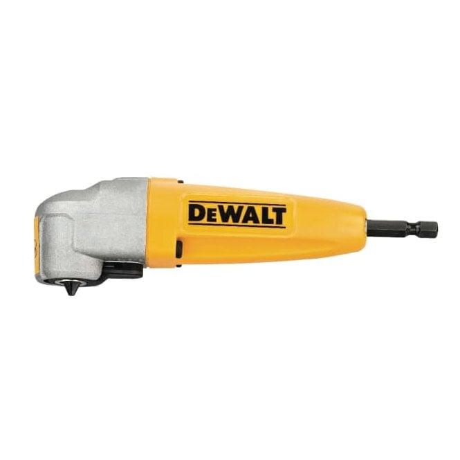

Right angled driver might help...DeWalt the best attachment imho for going on a cordless drill but pricey though. Lidl/Aldi often do them.

Or cut your noggin to a nice fit. Push it in with a couple of loose bits of timber to stop it going in too far then pop some screws in on the angle. Probably easiest.

If you don't have the tools?
Most of us would run a bit of 4x2 through a table saw. You could hand saw a bit down along its length with a decent sharp saw. Top might be a bit off square but so what. Jigsaw it even.....

Well I know most would use a tablesaw.. Id do so if I had one. I'll have to circ saw it maybe from each side/ hope for the best.
Afaict the nog in this (pic)^ end doesn't need -perhaps- to be load-bearing (me being the load) bc the brace above it can do this. IE if a ladder is rested it can go on this brace, then I can stand on it too (if I ever need to- I honest;y dont think Im ever coming up here again). So the new nog below only needs to be something the hatch frame fixes to this end. So if I can get a precise 7.2mm cut piece, to squeeze in here, it can be fixed from the top/ that's all I can do. maybe 1 nail in rhs end.

That nog doesn't have to be one piece at 72mm. You could make it up out of stacked, thinner bits with some glue in between for belt and braces. You must have some offcuts around?
Put the screws in at 45 deg angle on the timber.
Hi Tonyt.. yes I've done just that. Got both nogs nice and solid.
Done it and pulled orange fluff back over hatch. Hopefully Not ever going up there again!
