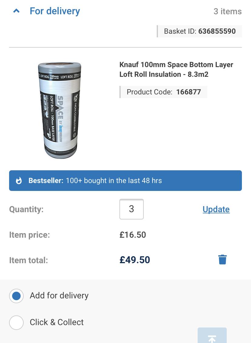

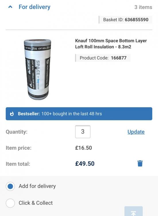

£50 a roll is a joke - so here you go, 3 rolls for £57.45 delivered by Wickes to the middle of Happy Valley Taffyland...
Wickes link is here ...
https://www.wickes.co.uk/Knauf-100mm-Space-Bottom-Layer-Loft-Roll-Insulation---8-3m2/p/166877
2 hours ago, zoothorn said:
No understood, I just wanted to match the 2nd layer Ive done (only got me half loft area done you see) to buy same for remainder. Then consider my 3rd layer.
So as it measures 130mm expanded.. what do you think it likely is then? 100mm just me manhandling it plumping it up?
Doesn't need to be the same - loft insulation is loft insulation. Just buy what you can get in 100mm ( or 200mm but remember the thicker it is the less coverage area in the roll) and it doesn’t have to match. See the Wickes links above.

@PeterW very useful link: actually I couldnt do wickes/ no delivery slots.. but homebase comes up trumps again: Knauf Earthwool Loft Roll 44- 100mm @ £17 x 3, £12 delivery (in 10 days tho).. & were doing a '4 for 3' on this.. so 1 spare can shove some above my freezing bathroom, tho its already got 400mm up there.
So, total will be 300mm. Tbh I just couldn't cope putting 200mm more up, room to work etc. At least it'll be better seated, gone up the wall & gable end halfway up. Not optimal but gets me to B.Regs (I think @ 300mm), and gaps almost all minimised. £90 job inc hatch = really excellent.
