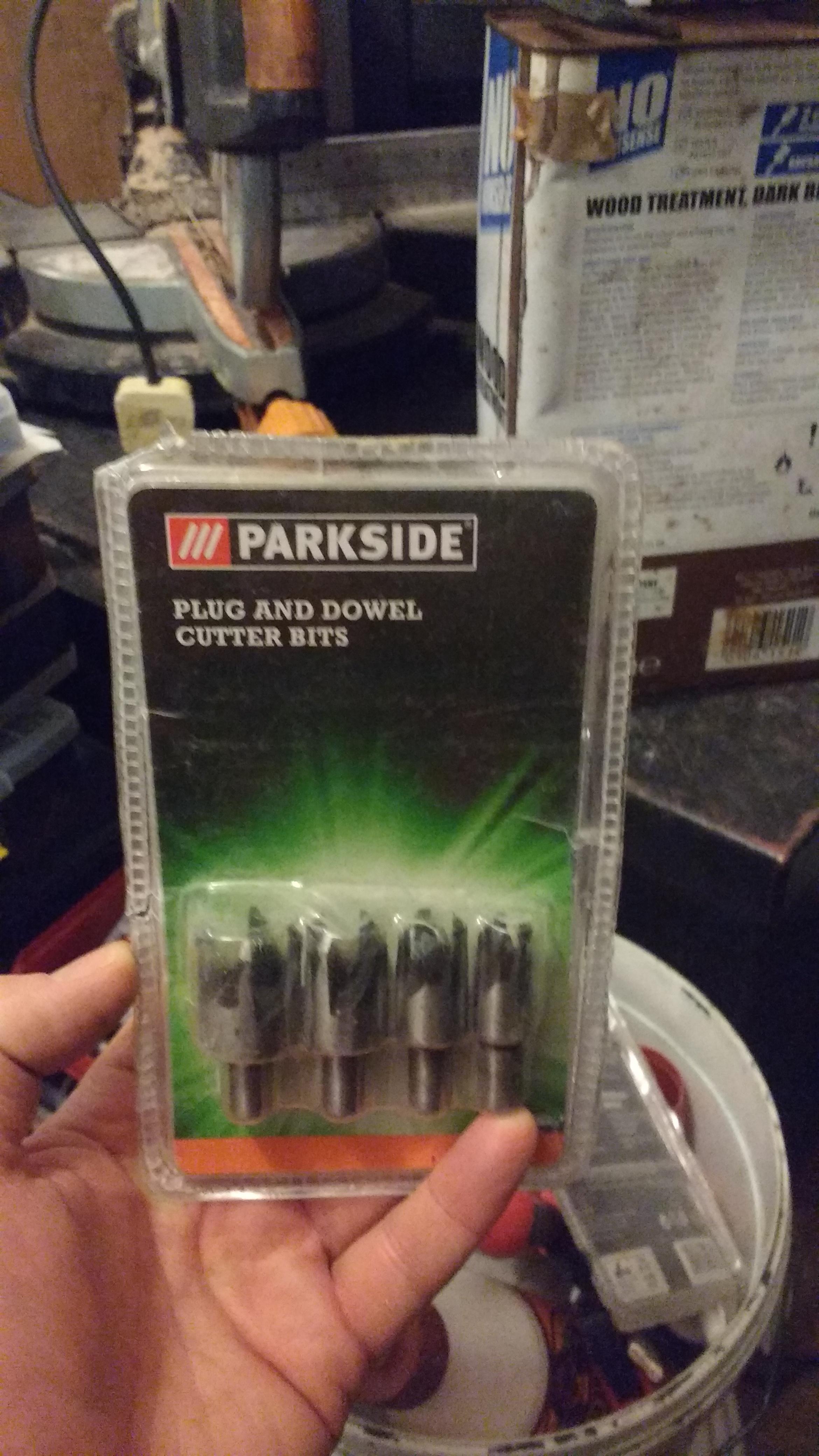

I've made my brace & ledge door, trimmed to fit as best I can do. So just to fill my screw holes.. got a shock with price of 'endgrain plugs' @ £ 17. Any other ideas i could use?
10 mm flat bit I've used to countersink screw heads 5 mm deep or so. Ive seen somewhere an eg of making them with a whatnot, but what whatnot's not very clear.

Google '10mm plug cutter'.  You can get a set of cutters on Amazon delivered tomorrow for £11.  Bound to come in useful in the future ?

10mm Plug Cutter is what you need - fits in the drill and cuts a nice plug out of a bit of timber. If it won't release from the source wood just flick it out with a chisel. Glue it in, leave the glue to go off then cut flush with a sharp chisel.

If you're going to paint the door then just fill the holes with a stiff PVA/sawdust mix and sand when dry. Even if staining it then uniform screw holes, filled with ordinary filler can make neat little contrasting points of interest.
This set of plug cutters came from Lidl, cuts 6, 10, 13 & 16mm plugs. Tbh I've never even opened them. Under a fiver from memory but a while back.

Great clip, just the thing i need a 10mm one of those plug cutters then, simple as. Very useful thanks.

Plug cutters are available on eBay, Amazon etc and there is always Axminster tools, I'm sure you can easily get to the free postage order (£45) and treat yourself to a few other woodworking tools.
The plug cutters are best used in a pillar drill, some, the ones with almost a full circle at the base can be used in a black 'n' wrecker though, but the ones with spikes are pillar drill and do work a lot quicker with less burning in hardwoods
@JFDIY gdn centres & our only diy place very shut here west wales.. gotta try pound shops. Yup plug cutter off ebay it is, thanks.
Need to use in a hand drill tho/ no pillar drill, maybe a router but needs a 1/4" shaft exactly/ unlikely.
