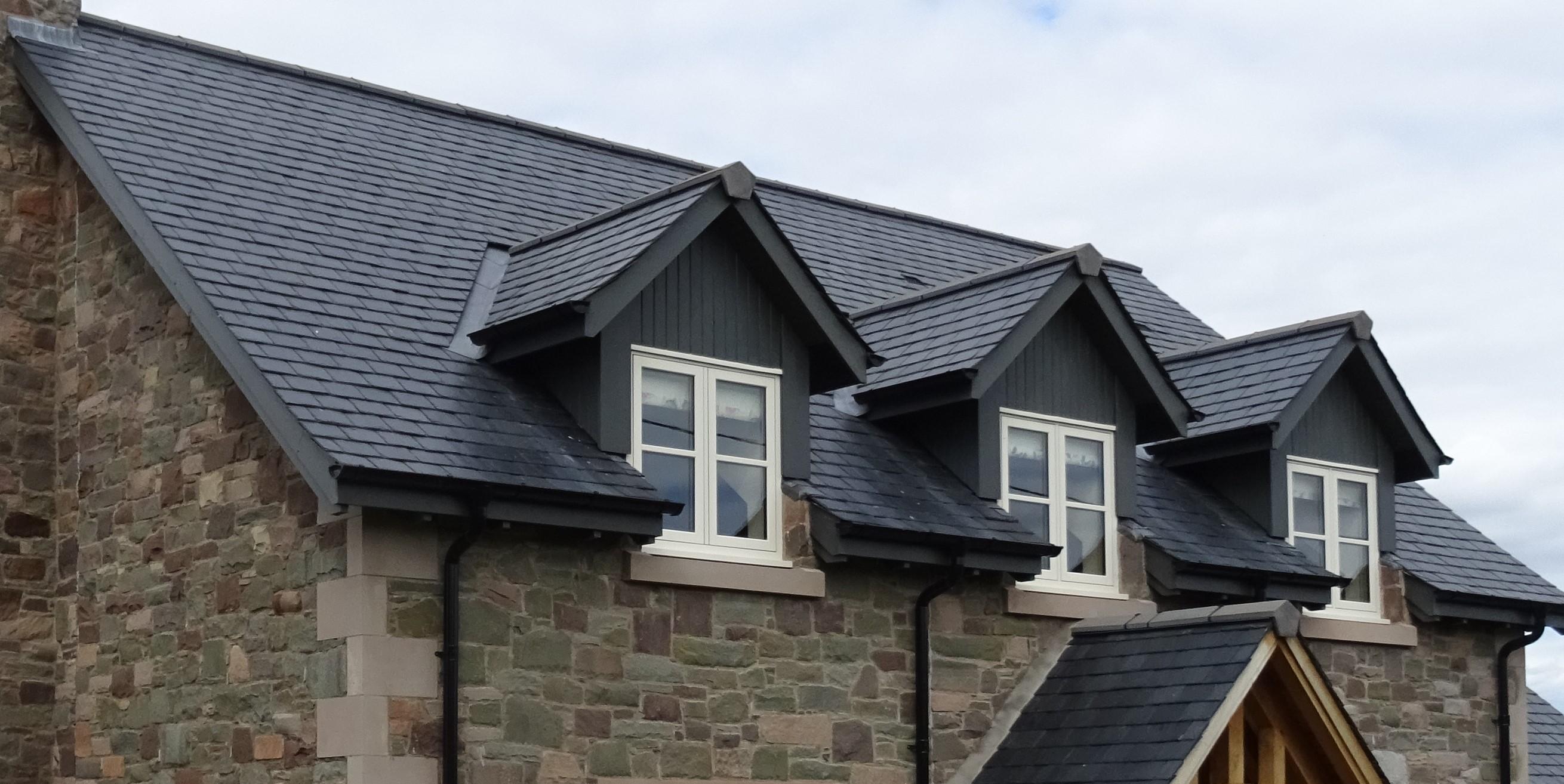

I'm not sure if that is considered to be the correct / best practice, but I do see on @PeterW photo, his have a short downpipe. That said, I have not experienced any problems with this approach so it may just be a case of either or? -

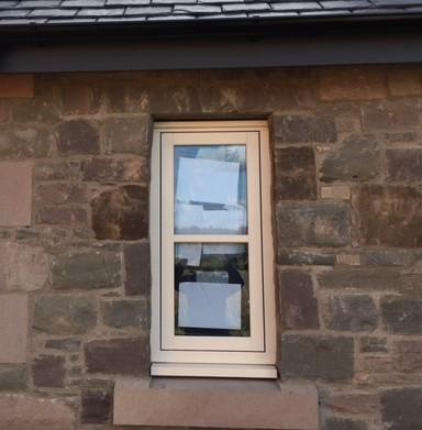

Stone sill with short projection window sill
Redoctober replied to Dan1983's topic in Windows & Glazing
Hi @Dan1983 have a look at the attached photo. Picked out from our build archive - shows what is being said above. I too thought it strange at the time but had noticed other windows sitting on stone sills to have have had similar "gaps" which gave me confidence to accept them so to speak. -
