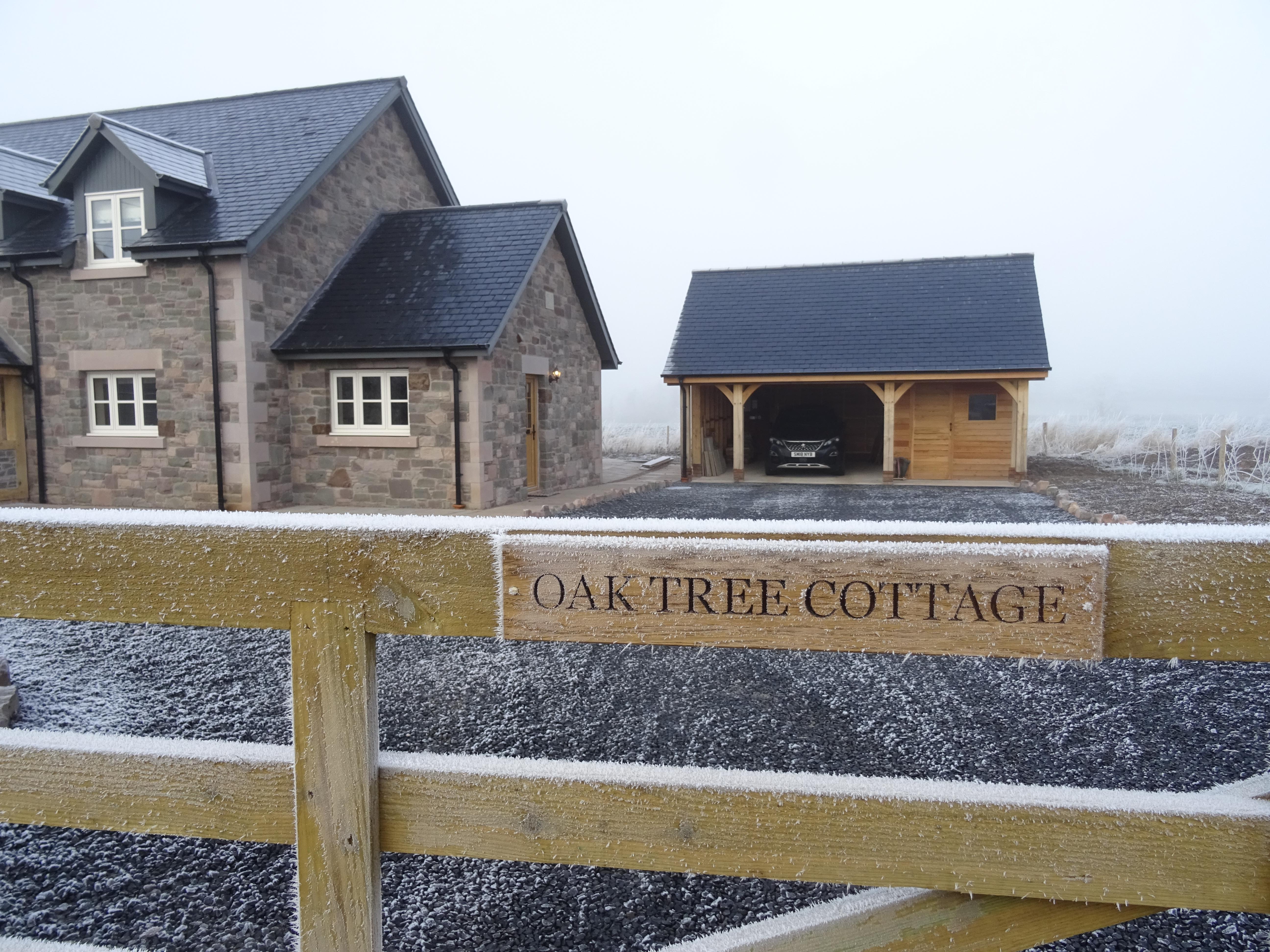

Hi - a little late to this thread but for my two pennies worth, we stuck ours in the car port / garage whatever you wish to call it. See image and or my blog for details. SP Energy supplied up to 50 metres of cable all within the connection costs they charged, which was about £900 job done. We used best part of that 50 metre run to take the cable from the pole into the carport. This was all done ahead of the TF being erected and allowed the Trades to tap into the power supply as and when. The meter is held within a proper approved box and we have had no trouble with it since. It keeps it out of the way and accessible . -
