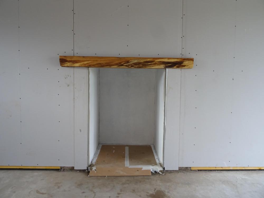

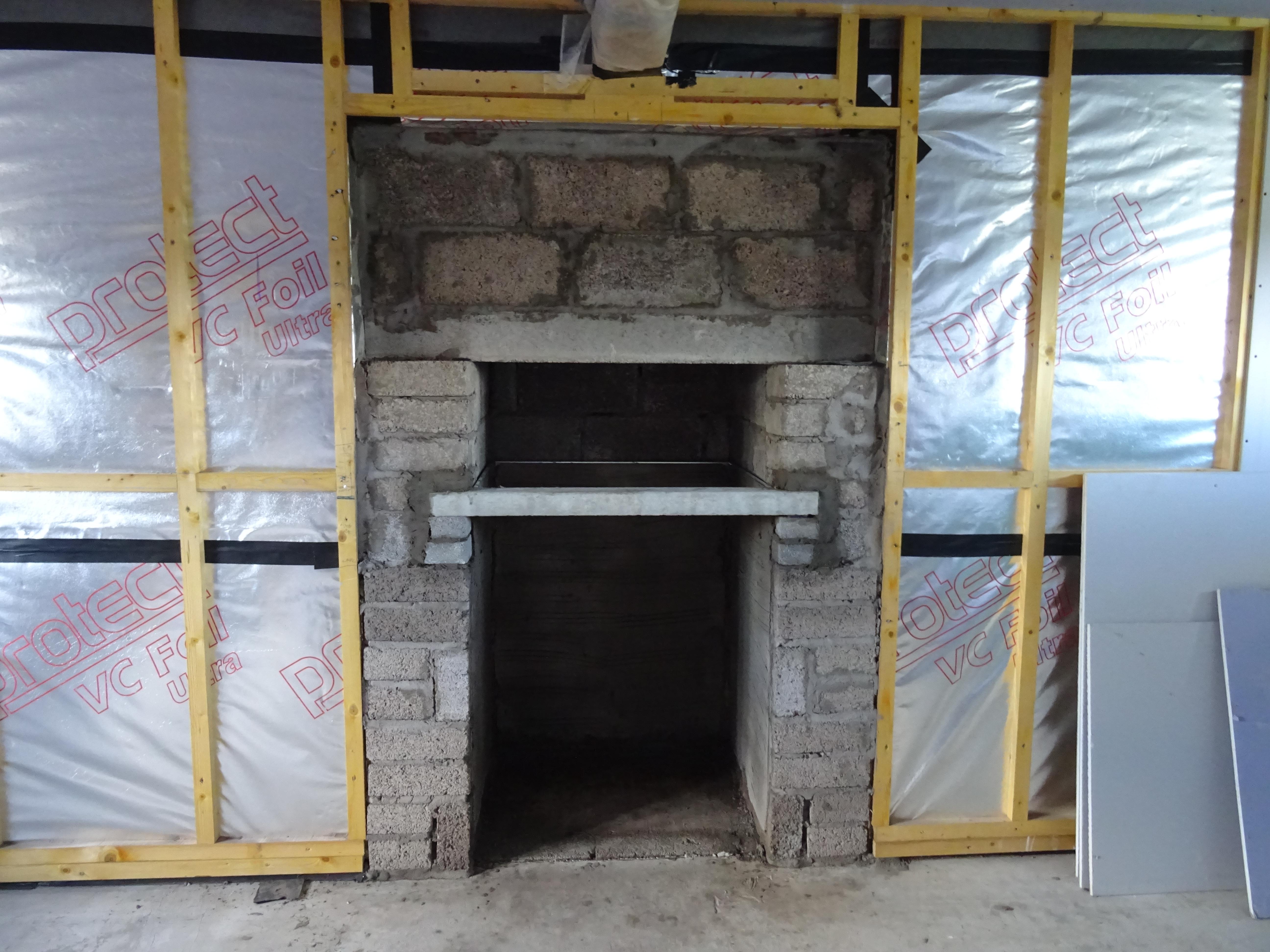

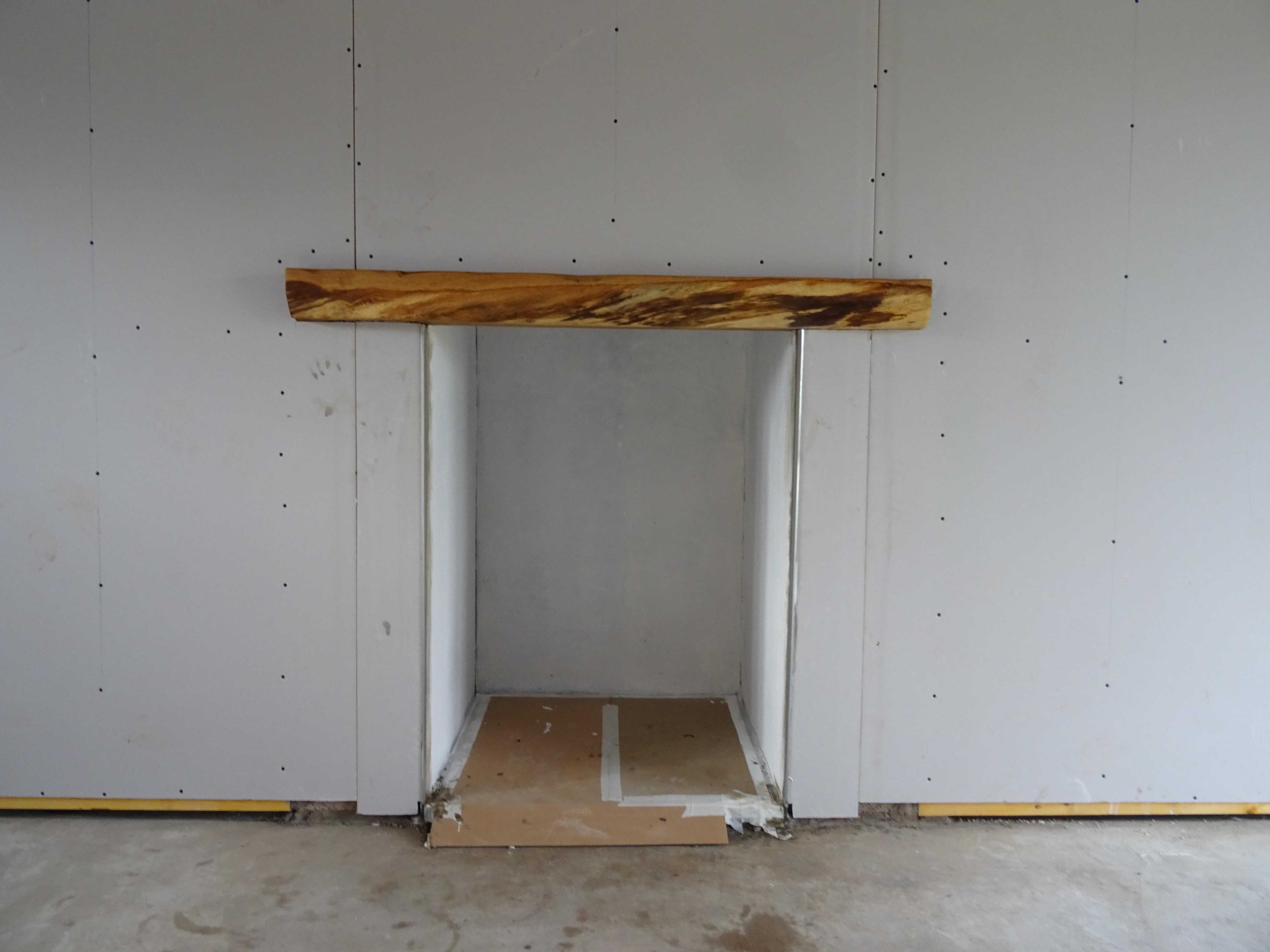

@MortarThePoint Here are a couple of images showing how our oak beam was fitted. When installed, it came with two large "bolt" type "pins" protruding, which were then drilled into the concrete lintel. The surrounding area was then plaster boarded. I have to say in the past 5 years we have not suffered any shrinkage or cracking or either the beam or plaster. The beam was sourced and fitted by the approved stove fitter!
