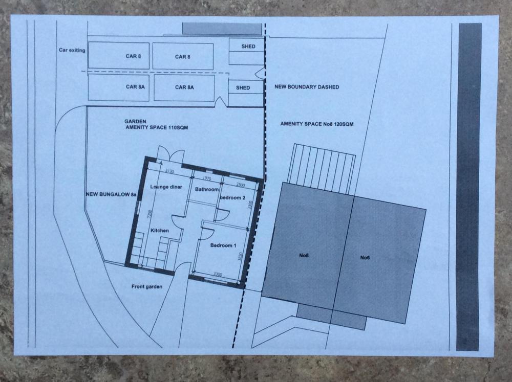

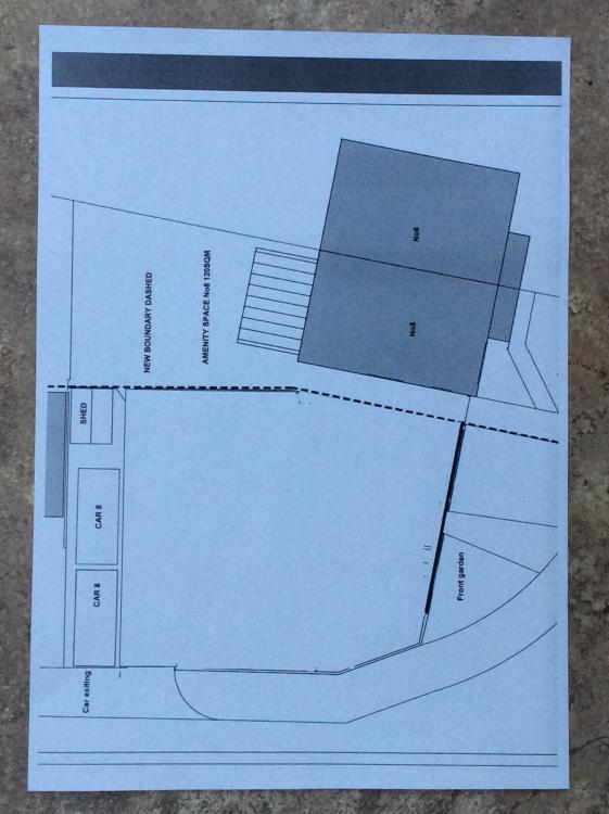

Small dreams - looking for house layout advice.
Ferdinand replied to simplepimple's topic in New House & Self Build Design

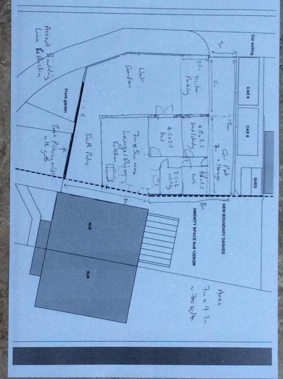

I would do that differently ... I would extend the A frame roof further out on the same profile, to give a car port and sheltered area that could be filled in later to give more house, and I would also make the slab similarly larger. If budget were available, the rear half of that could be a workshop. It might mean a sacrifice of something else, but would offer a lot of extra upside for the relatively small extra cost. If you need to there are quite dramatic things you can do such as no interior finishes at all for a few years ... a lot of couples including my parents lived with rush matting on ashphalt for years and years back in the day when people expected it to take time to restore a house. Painted breezeblock or raw plywood are fine for walls, especially now that walls are much better insulated and floors warmer. And you can get double sets of nearly new patio doors off eBay for a couple of hundred; I got two sets for under £300 last year for a covered way for a tenant. (A covered way is an ill defined thing that happens to be exempt from building regs so I could JFDI). There are loads of them where someone has decided that something not new is not good enough for them. On one of mine, the last of the house felt that white upvc was classier than brown upvc. That alone could save you £2-3k if you are having 3 sets. F -
Interesting. The other 2 options I thought about were an L shape, as you suggest, or a south facing U plan with a sun trap courtyard in the middle. BUt the main thing on this thread is to make sure that the OP is not restricted in his/her head to a limited template laid down by the outline, and has the confidence to debate the architect as a demanding client. ONe quite different alternative should stop that happening. AS it is the rooms at the back are a utility and a bathroom, which are fine with skylights and the single public room gets sun from mid morning till sunset, and the bedrooms later on. I would want several skylights, at least to give slanted sun in the morning in the lounge. If I was interior designing it, I would perhaps have skylights above the corridor and some form of clerestory between the corridor and bedrooms to get the morning sunbeams in to play joyfully on the glowing skin of ... etc. The toughest constraint for me here was the parking, which can only be where it is due to the corner, and the need to avoid a tandem driveway and go side by side, which is much better. Those spaces are very tight indeed at 5m length. THe one I have done could lose 0.5m off one dimension of every room, so the entrance can be created anywhere. Personally I would probably go for a back door from the car parking, and a 'front' door entered from the south up a path behind the property emerging next to the utility. Perhaps covered over for a FLW style mystery drawing in rabbit hole feel as you walk in. I would aim to shunt it up the plot some way., and potentially have a third room as a study as a third 'bedroom' is a big perceived benefit. But I would not sacrifice all of the extra space - my experience dealing with tenants is that there is a HUGE perceived difference between a 3.5x3.0m room, and say a 3.0 x 4.5m or 3.5m x 4m; in a lounge it gives the opportunity for a second area in addition to lounging without it feeling cramped. The same goes for bedrooms, where you have space for an easy chair or exercise bike or handbag display unit. So I like working with dimensions of 3.5m and 4.5m. Privacy is less of an issue than might be expected here, as there is a 2m fence approved on the fence line, which does not show. Presumably that would be allowed on the building line on the S side too. The final issue here is build cost, which argues against a more complex shape. IF the whole thing can be done with a single A frame roof - I would cathedral the lounge kitchen area and the beds and corridor - and no cross gables, then that will free up cash for other things or and extra space. THere would be an argument for stepping the wall in to make the parking spaces 5.5 or 6m, whilst retaining an overhang. Had I the option I would have chopped off the corner of the lounge to follow the shape of the boundary, but that would complexify (!) the roof and cost several thousand extra, which could be used to pay for 2 or 3 roof lights or a nice holey brick wall at the front. That was my thinking, anyway. F PS posted the blank map so others can play. GO on go on go on... -
