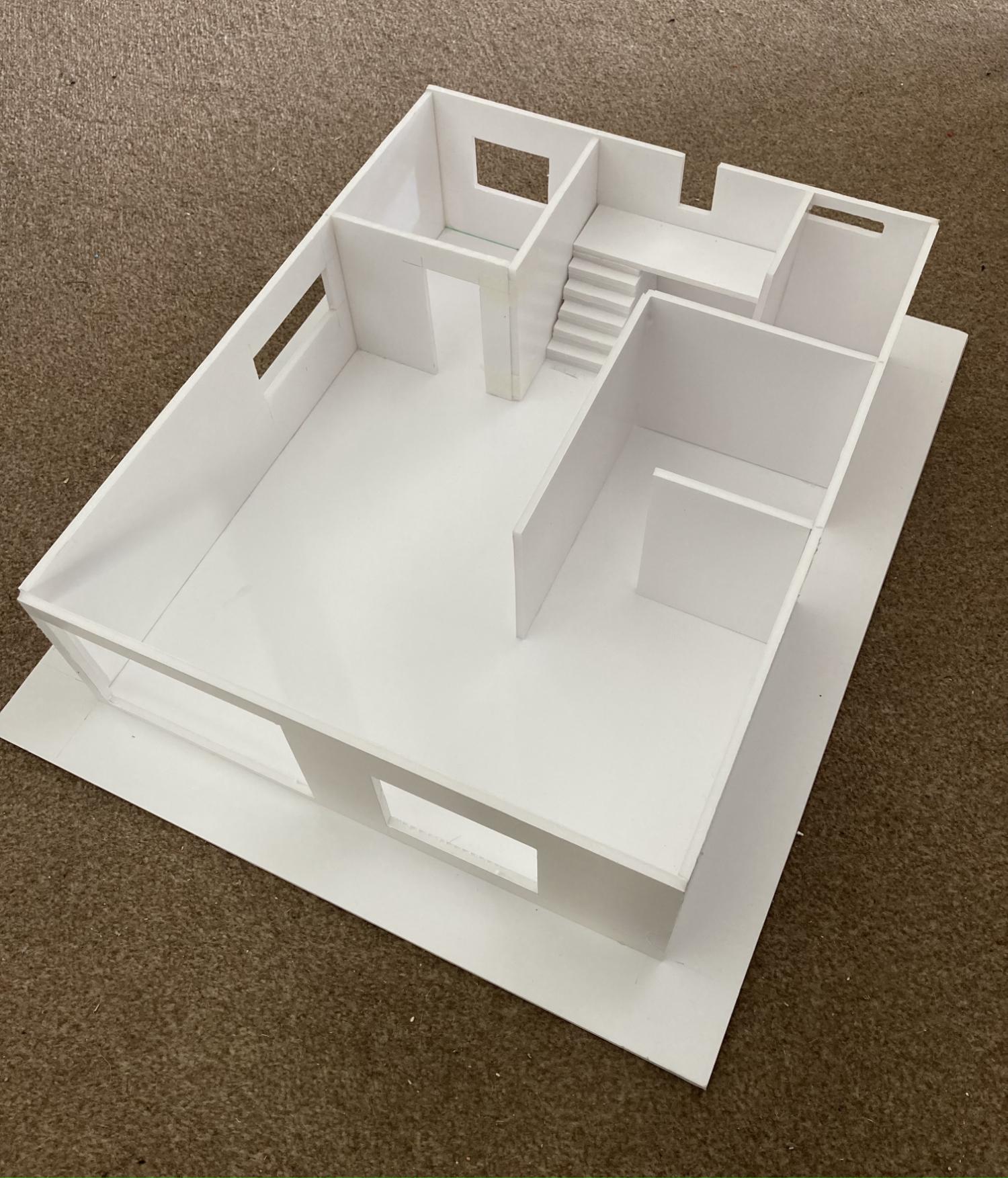

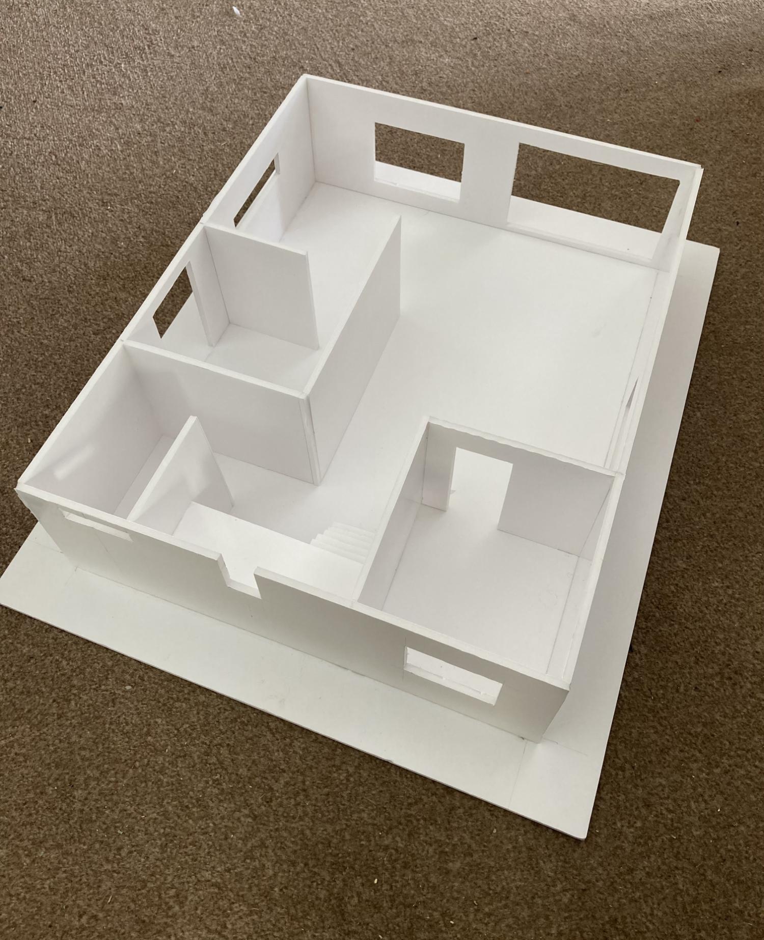

Drawings and 3D renders are great, but it might be worth spending a few hours making a model of your design in cardboard or foam board.
