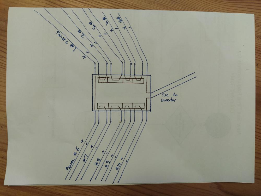

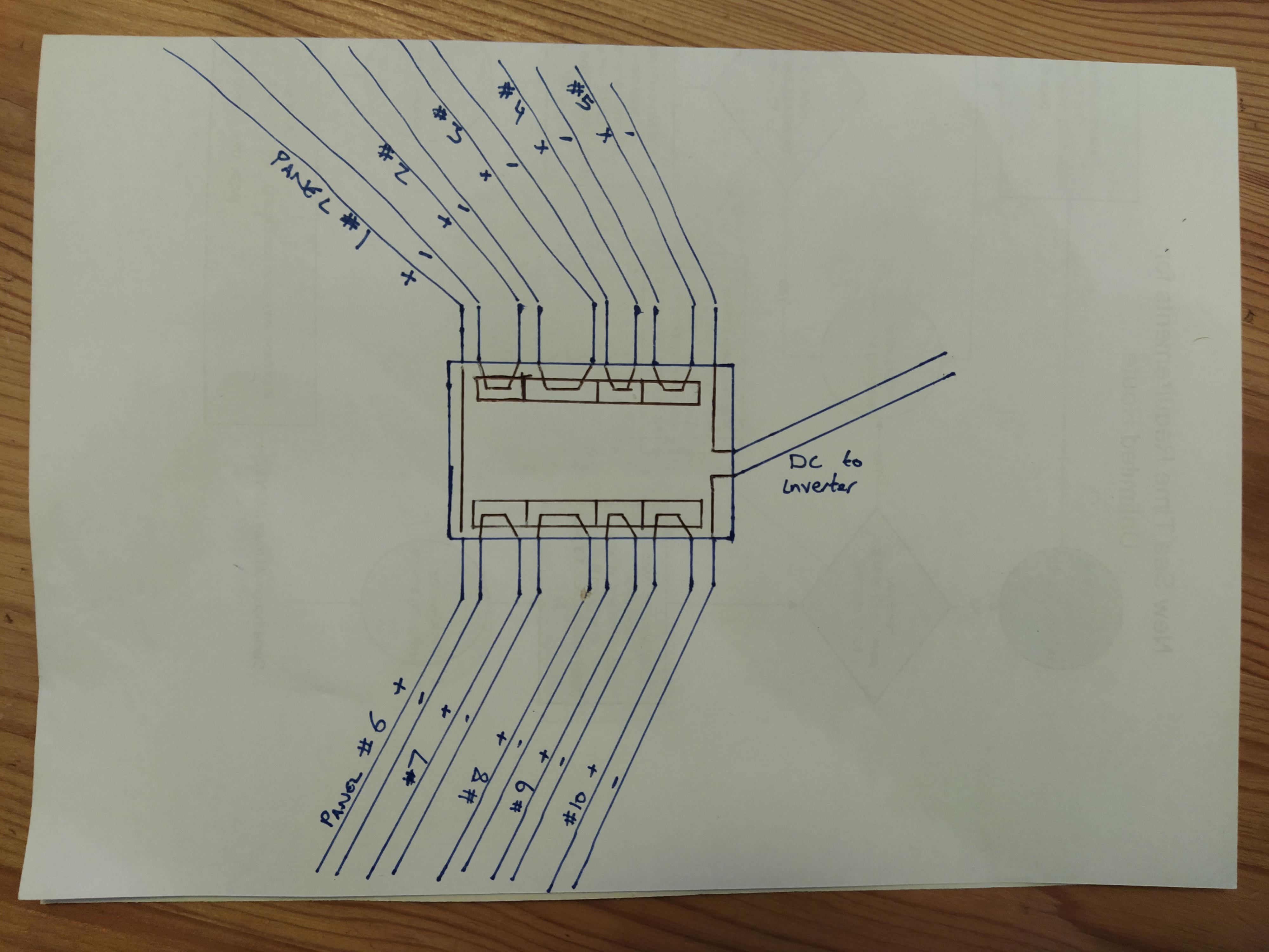

@Alexphd1 Thanks, hope your head is not in a shed this morning! I'm having an in roof system and a vented loft space so poking the cables in is not a problem. I would like to avoid a mass of connectors and am looking for a solution to make things look tidy. Something like this (fundamental error in the wiring! but hopefully you get the gist)
Thought this one might be up your street @Onoff Im imagining one box, located inside the loft space. 10 panels coming in (10+ & 10- wires) and then two output wires. Will all be live DC so I think it would need some safety stickers on the front. I agree it is going to require a lot of extra cable length and faff but possibly worth it to be able to isolate individual faulty panels in the future. My loft space is vented so there is no need for extra work around airtightness
I'm still considering this approach. Can anyone suggest a suitable connection box to bring 10 panels together in series. The only specific PV boxes I can find are combiner boxes which bring multiple strings together
