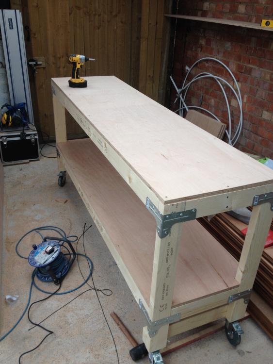

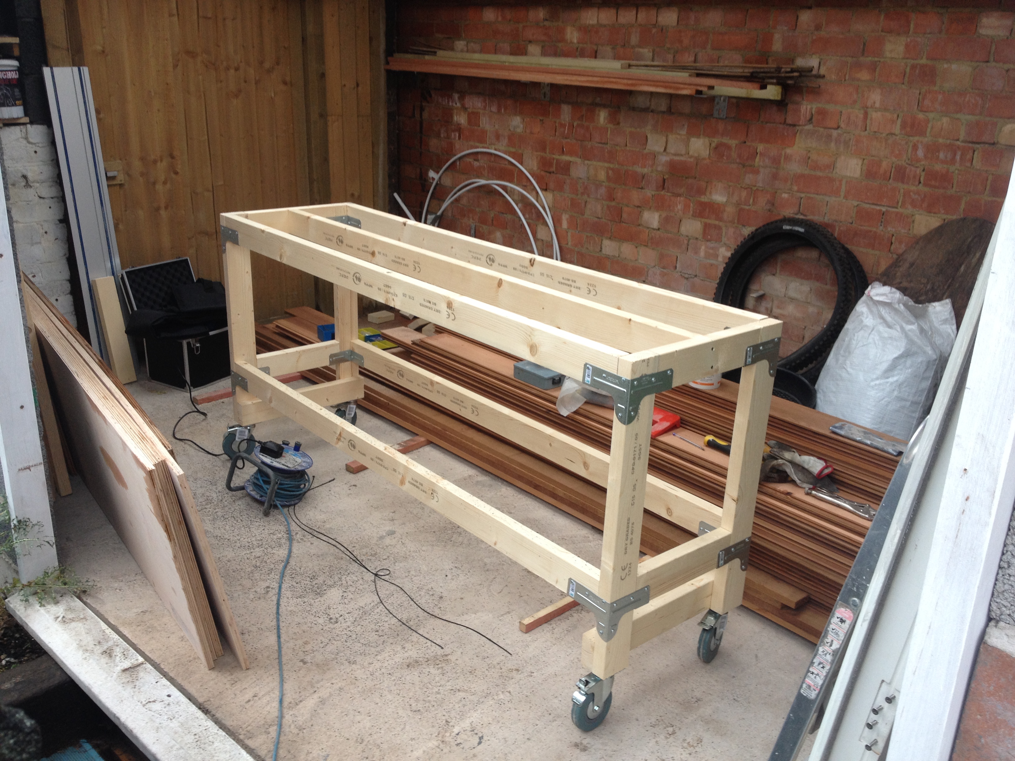

How did this arrangement work for you? Do you have any photos? I can't imagine how you cut the ply to easily fit in between the webs.

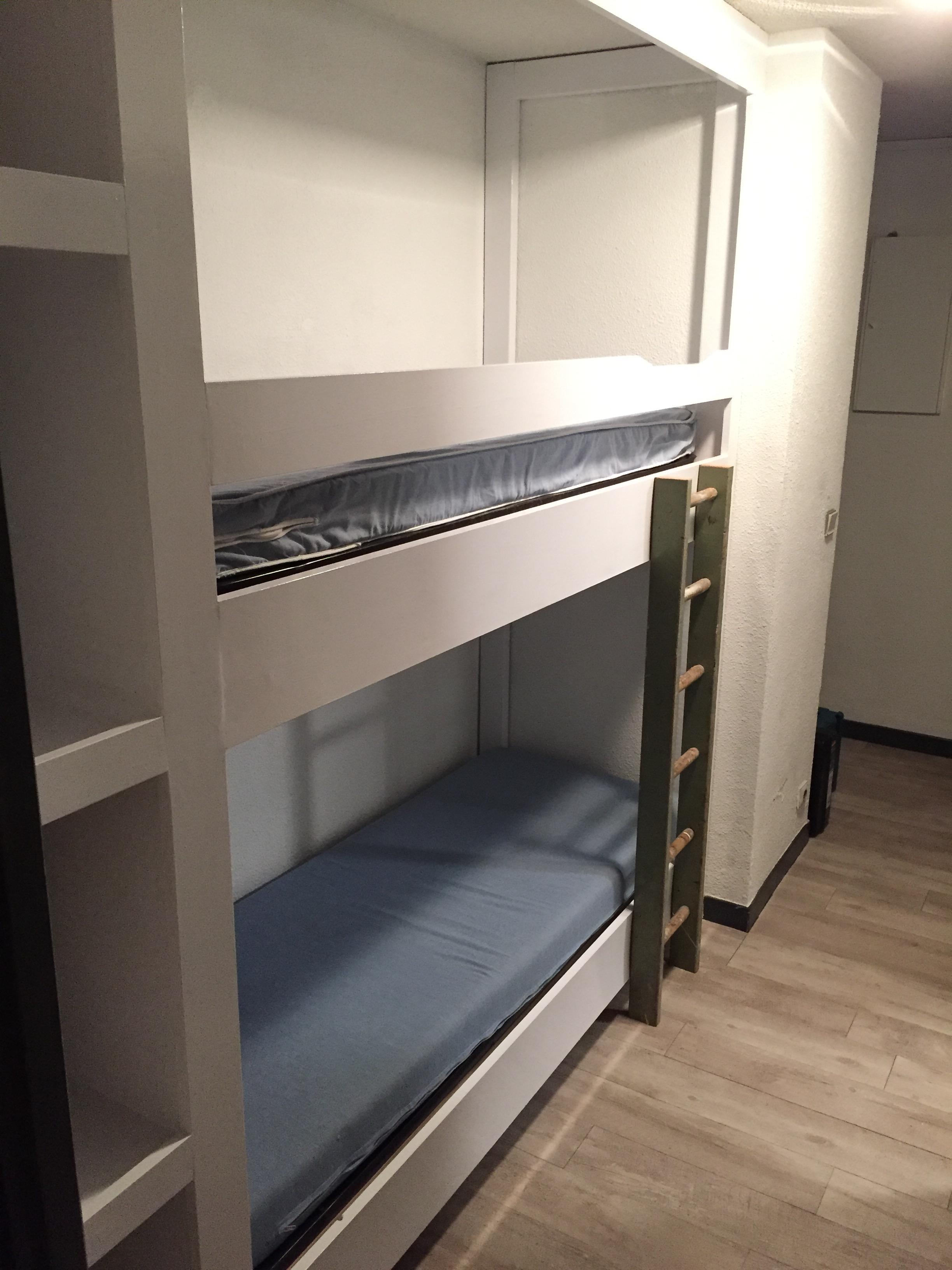

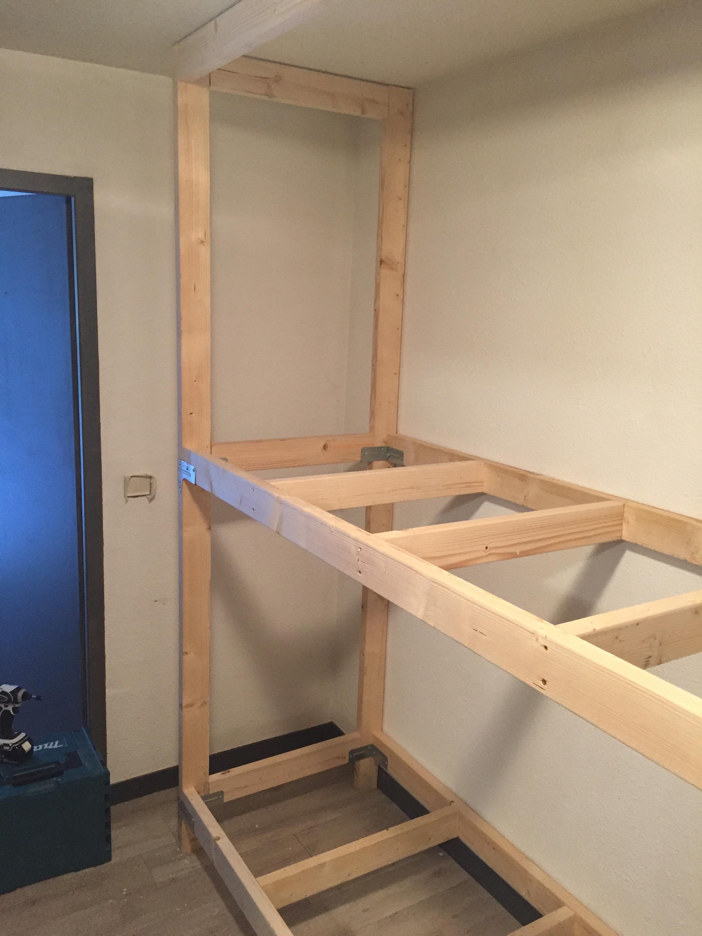

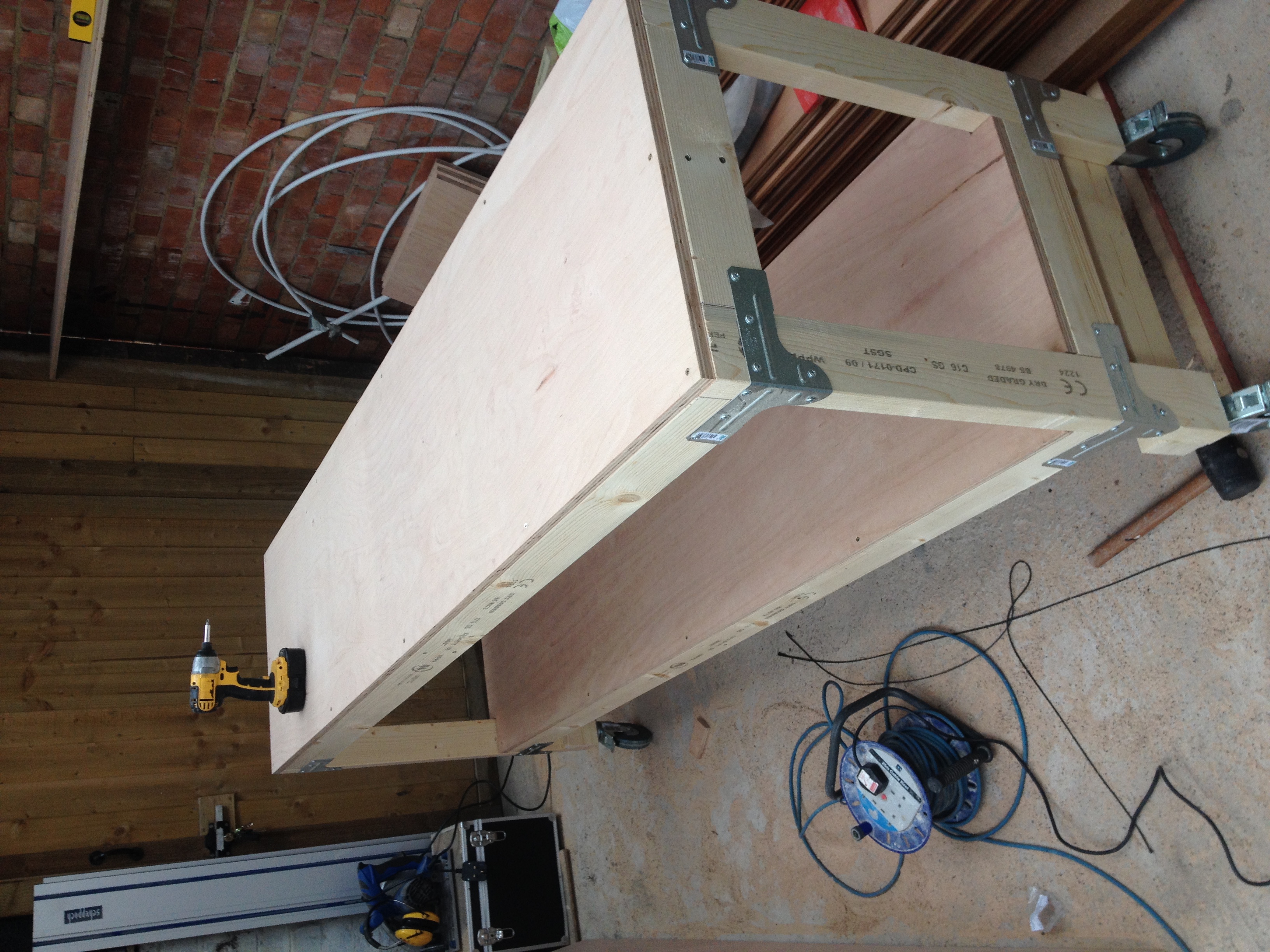

I found the Simpson Strongtie workbench kit great. So quick, simple and guaranteed strong joints. Used another kit recently for a set of fitted adult friendly bunk beds in a ski lodge.

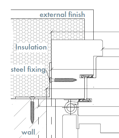

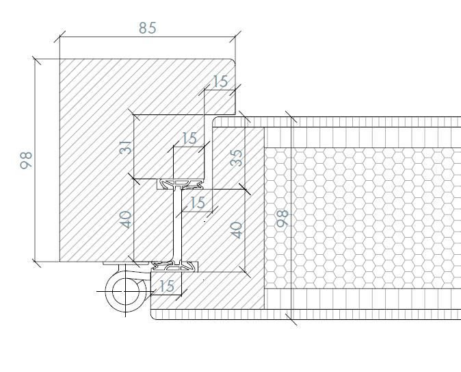

I appreciate it’s an unusual ask for most joiners but I think achieving a decent level of air tightness is possible on a one off piece. I’m envisaging double rebate with three weather seals. Hopefully two of these seals can be continuous, one may be incomplete to facilitate the hinges. Obviously no protrusions through the door like mortise locks or letter boxes! The locking arrangement will be an electronic strike release only. I’m sure there’s a joiner out there that’s done something like this before... -

Good evening, Could anybody recommend a joiner capable of building a bespoke passive front door and frame. Today I met a local, well recommended joiner who I have no doubt is very capable but he has never built a piece to these requirements before. I’d like the front door to be a statement piece and have a design but do not want to compromise on air tightness and thermal performance standards too much. My current feeling is I may be better with someone not so local who has previous experience in this area. First sketch of the design attached front door sketch.pdf -
