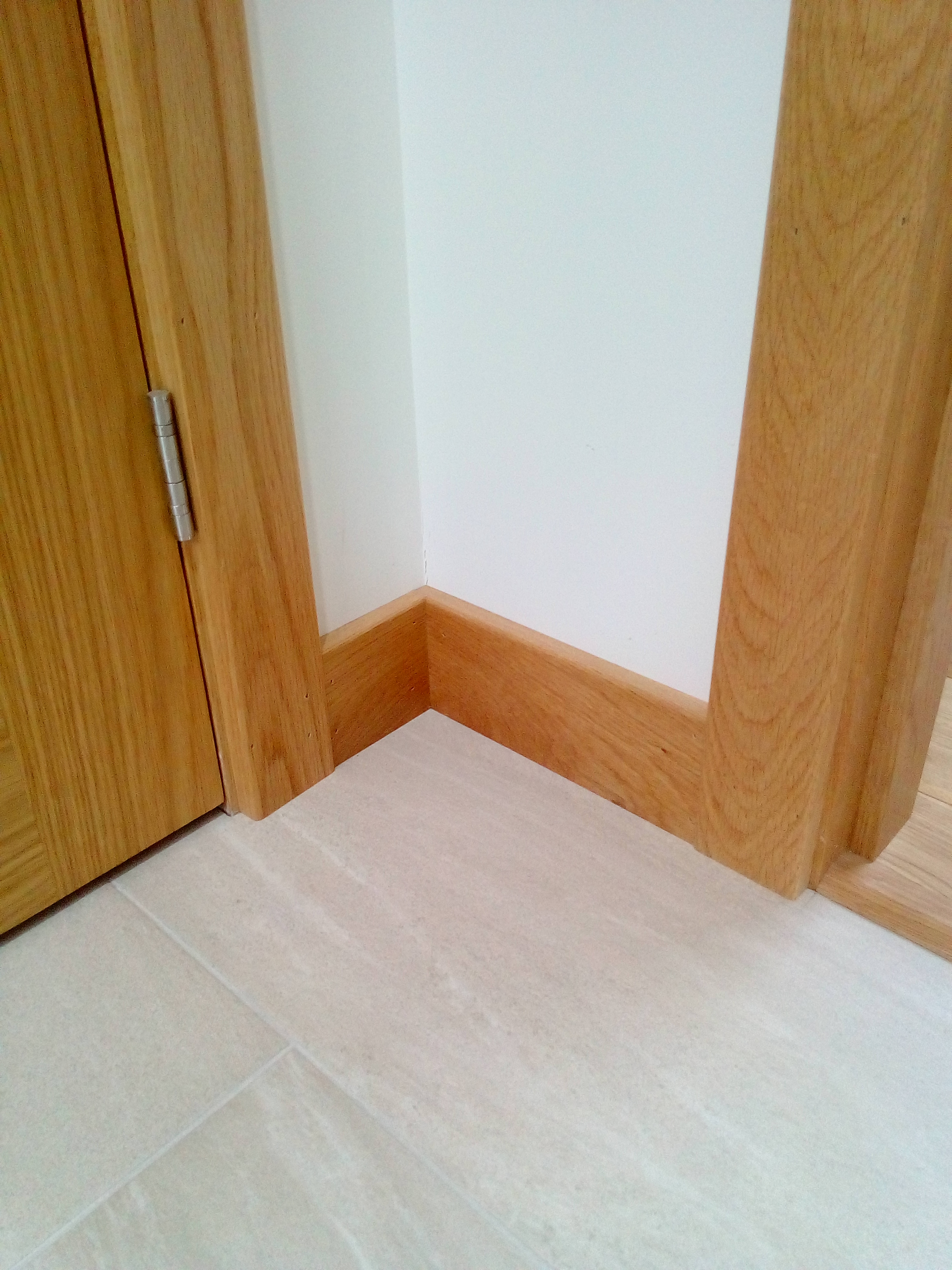

If fitting simple profiled facings and skirtings, I wouldn't bother, as per picture below ( facings will need to have greater depth than skirtings). If going for an ornate / ogee type profile fit them to make the transition easier and neater.

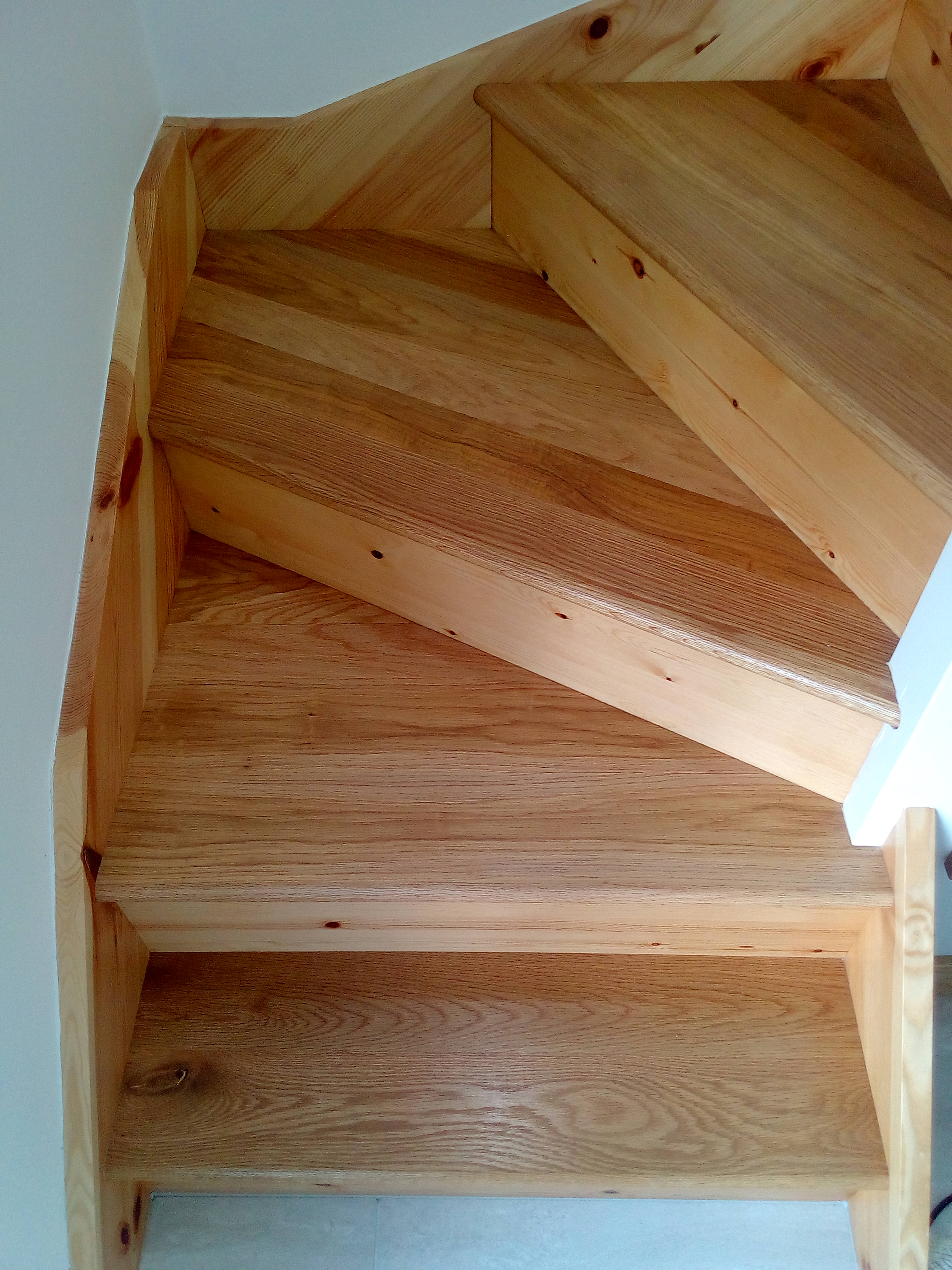

+ another 1 for Osmo polyx clear satin. Lightly sanded before application, and deburred between coats. Picture of our stairs after application, oak treads, pine stringers and risers. As other have said, it's proving very hard wearing.
