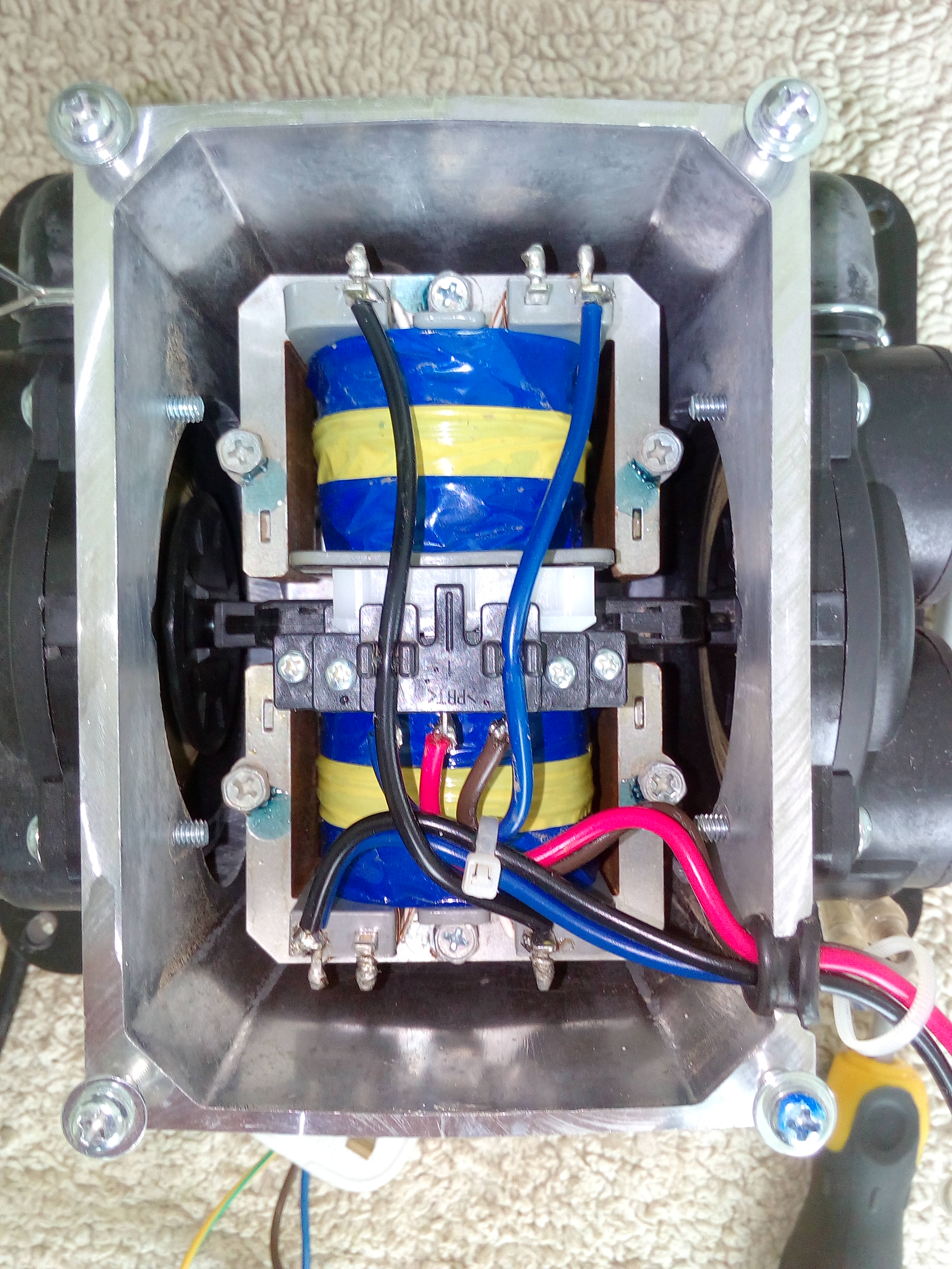

  14. Well, I decided to take it apart again and reassemble. Plugged back in and its working once more. Currently on test in the garage.

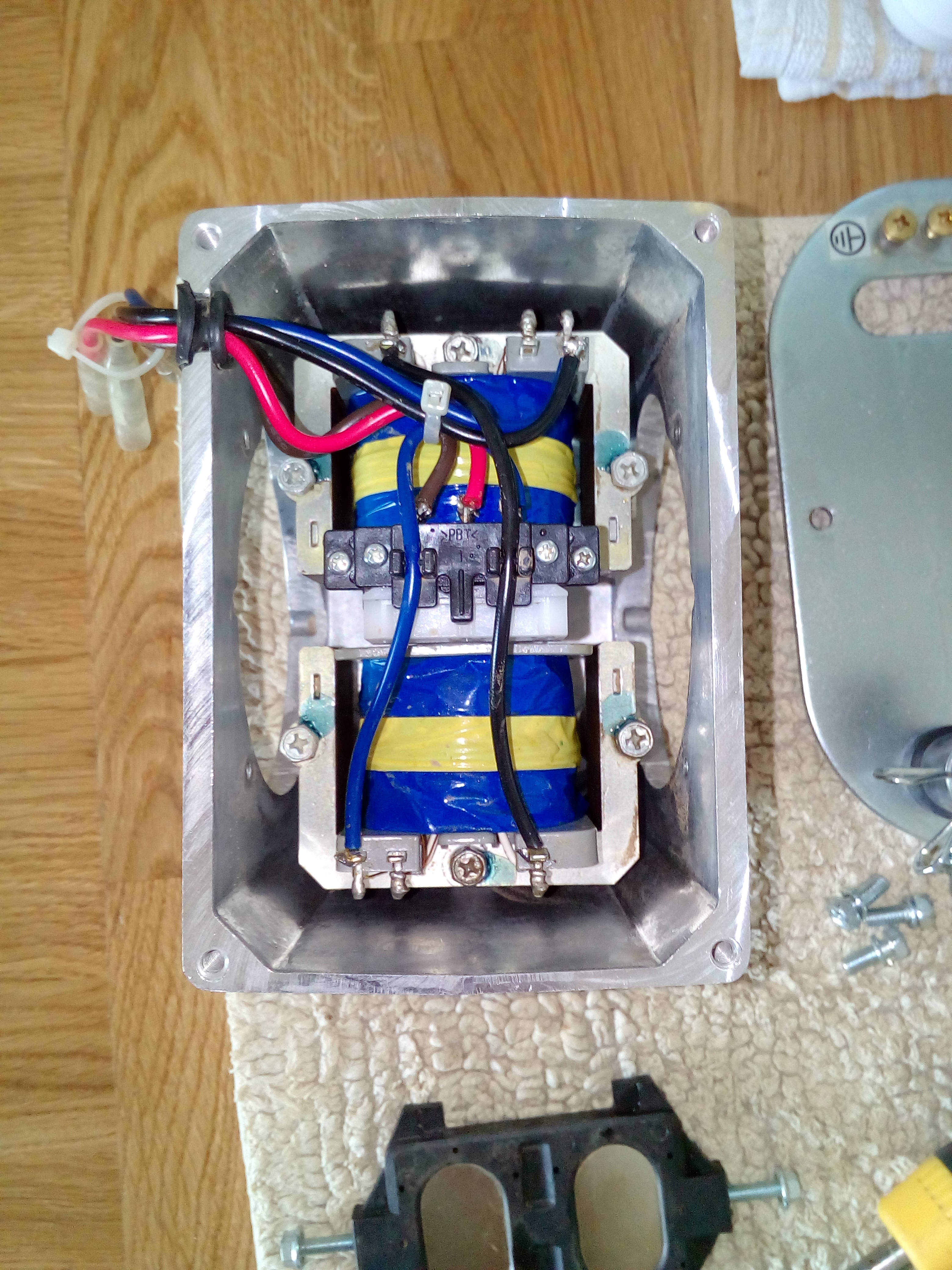

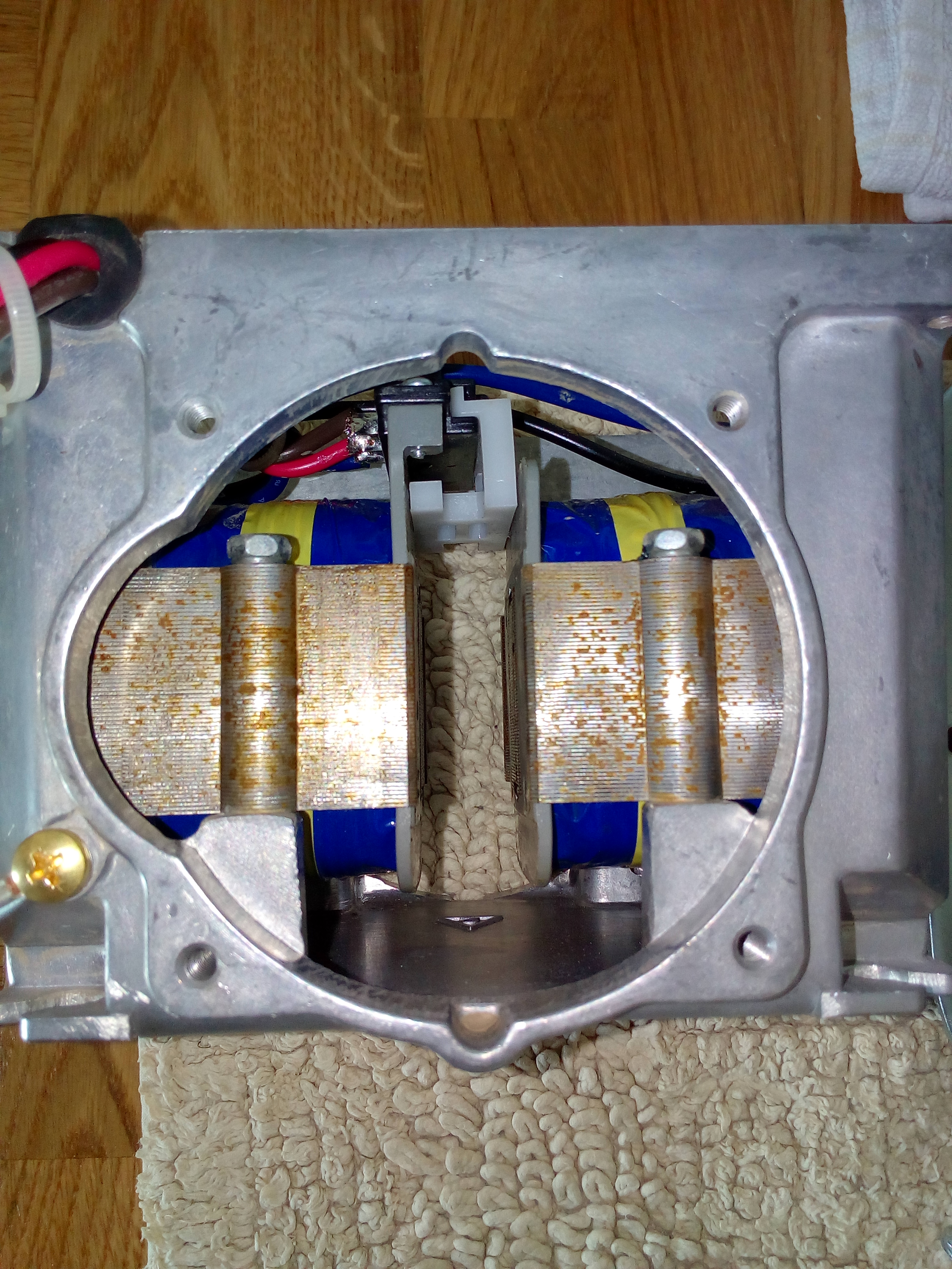

  16. I've now reassembled the pump, but other than the alarm light illuminating, no sign of life. I'm wondering whether the windings are still damp. A quick read online suggests drying the motor (stripped of diaphrams etc) out in a low temp oven. The other alternative would be a hot box using a fan heater, again with the intention of heating the motor up enough to drive out any moisture. Thoughts?

  23. As a consequence of heavy rainfall: the air pump in our Sewage Treatment Plant was submerged with surface water yesterday. Having removed the pump and replaced it, I have stripped down the submerged pump Most of the component parts, cleaned, will of course simply dry out and be in working order when reassembled. I am however unsure if I should be doing anything to the key electrical component: Is there anything I should or could do?
  24. A (hopefully) useful learning point for those installing Biopure Sewage Treatment Plants We had a huge amount of rain fall yesterday afternoon, so much so that our deep flow gutters were at times unable to cope with the amount of water running off the roof. In the main, our drainage strategy coped very well, with all visible surface water being drained away within 10 minutes of the rain finishing. Given the volume of water that fell, I'm happy enough with this result. One issue that we did have was that surface water ran down a banking behind our treatment plant, and pooled on top of its lid. Up until now, any rainfall has simply run off the lid to the land surrounding, however yesterday, the flow / volume was too much, which resulted in the small air vent on top being submerged. Our air pump is located within an insert below the main lid, directly beneath the air vent. The insert filled with water, submerged the pump and tripped the electricity supply. There was no further damage caused to the treatment plant (i.e. being overwhelmed with surface water) as the pump housing insert was watertight. Taking advantage of a 10 minute break in the weather, I swapped out the pump with a spare and got the system back up and running without incident. On a positive note the IP68 rotary switch which connects the mains supply to the pump was bone dry when I opened it. The submerged pump has been stripped down and is currently drying out. The advice therefore is to ensure that the lid of the Treatment Plant remains proud of the surrounding ground, rather than level with or partly proud (as was the case for me), and ensure any surface water / heavy rain has somewhere to run off. If the worst happens, having a spare pump (as proved in this case) is certainly a worthwhile investment. Having identified this issue the hard way, I now have a small amount of diversion drainage work to undertake.
