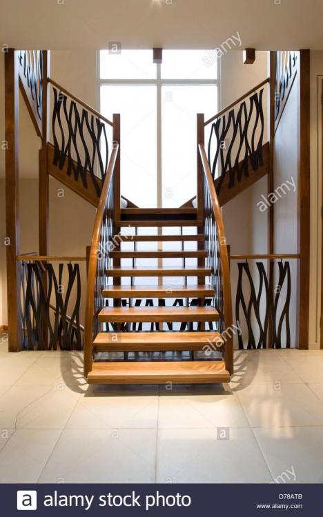

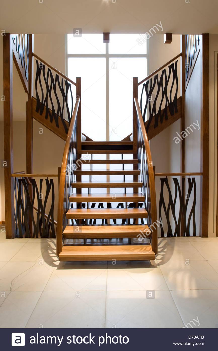

Something similar to the attached? Obviously taking into account the headroom or clearance required under the stair soffit in order to access the rear area(s). -

Having only just seen this and read through some of the posts, is the issue the headroom from about the 3rd/4th riser? If so, could you not push the staircase further back into the room so it clears the headroom which will take you to a landing and then turning left or right up to the first floor... if that makes sense? -
