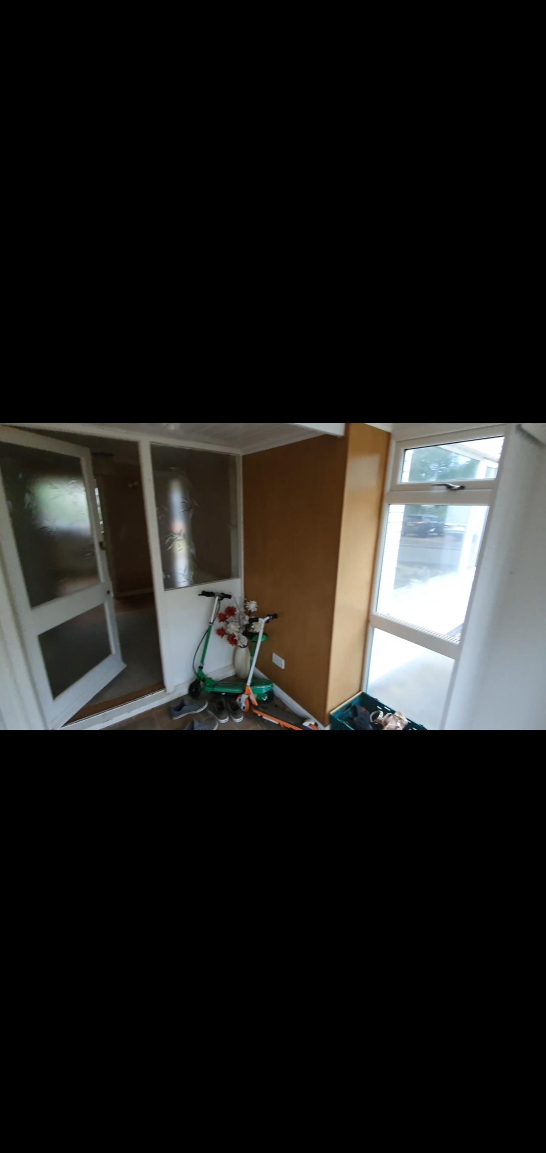

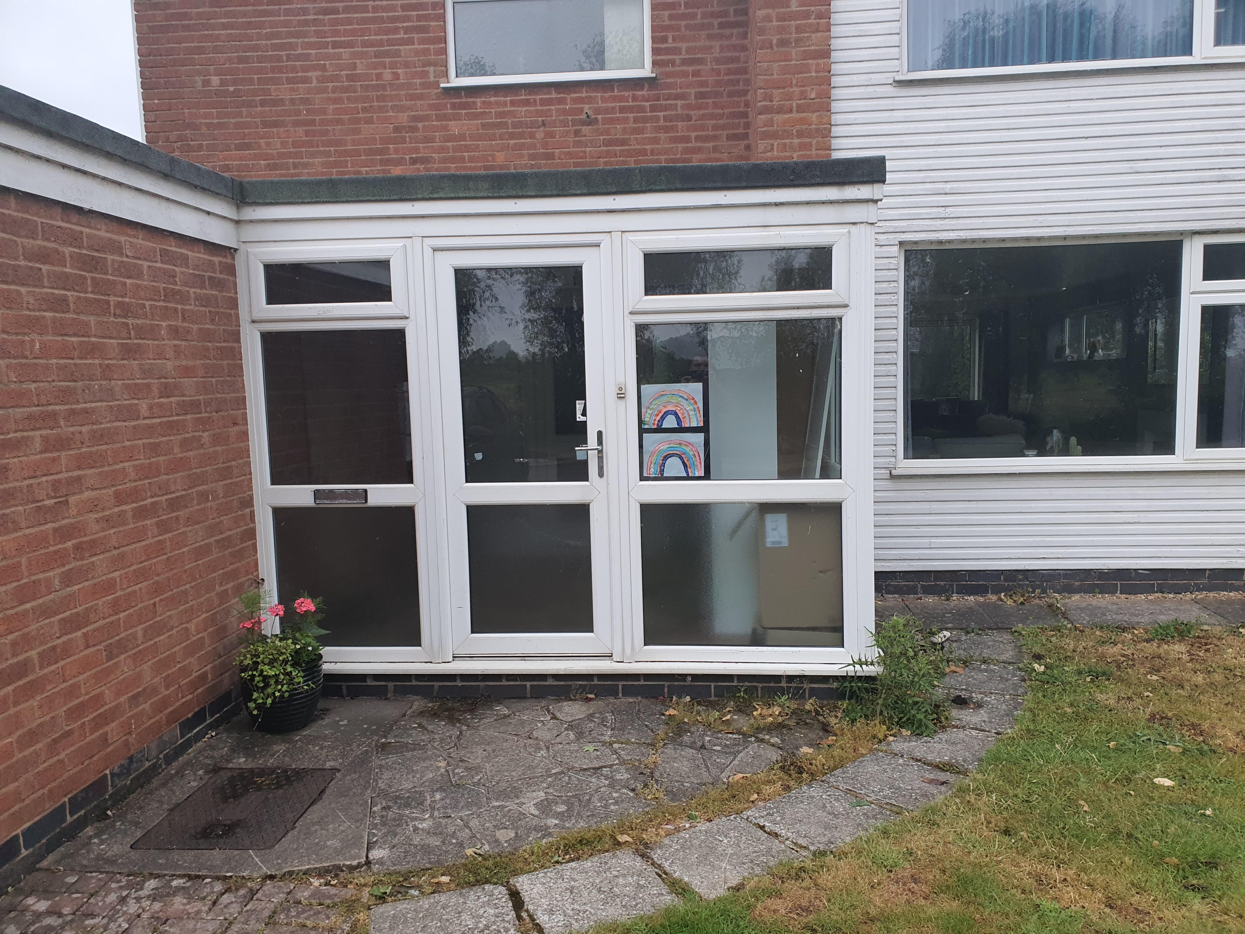

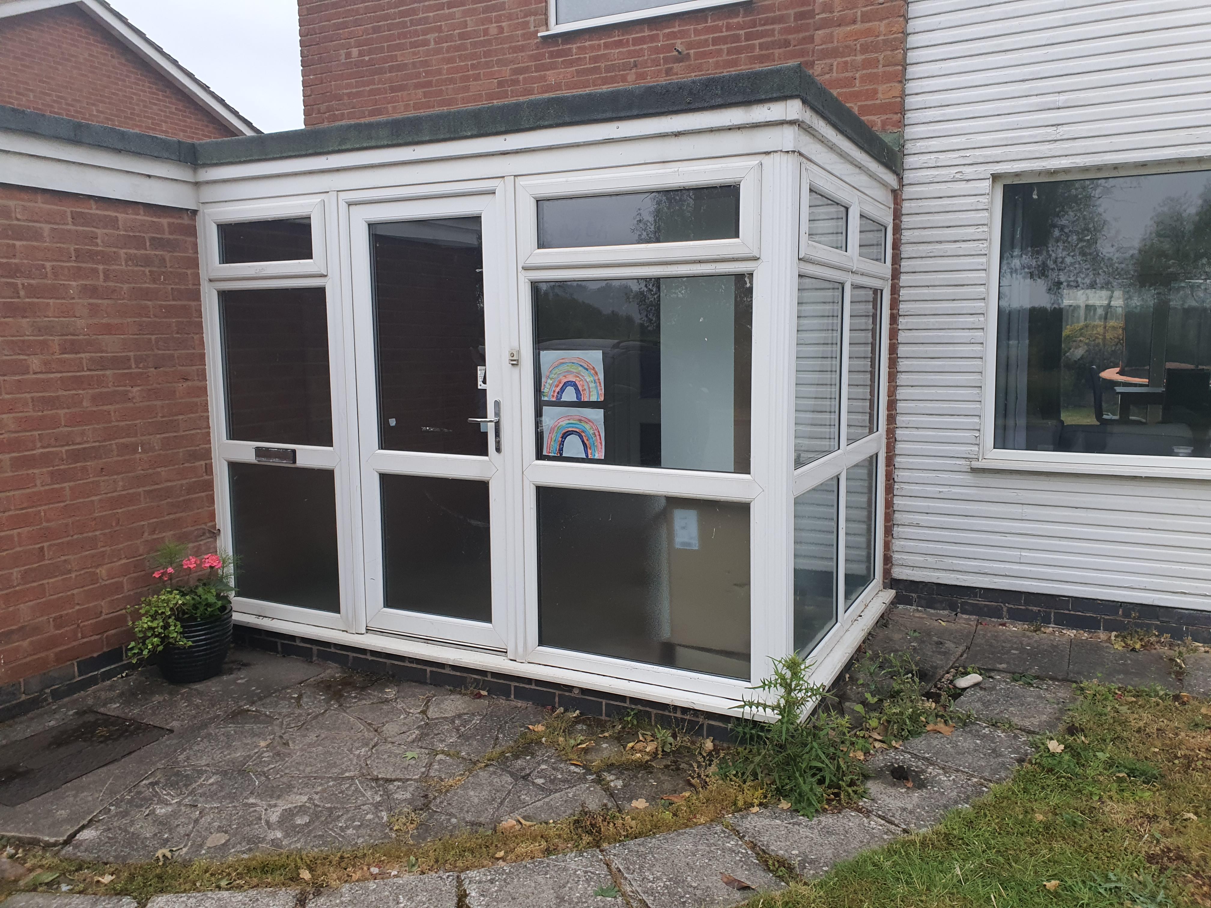

Recent Profile Visitors

  1. Yes it will be like for like its 3000mm wide and 1500mm deep.i will be keeping the original external door but will replace it later on once the porch is complete. Ok so i will go 100mm cavity anyway and fully fill the cavity with rockwool. Do i still need to join existing building cavity or fit a vertical dpc? I will have to phone my local planning then im just going of what ive been googling if i need regs or permission.
