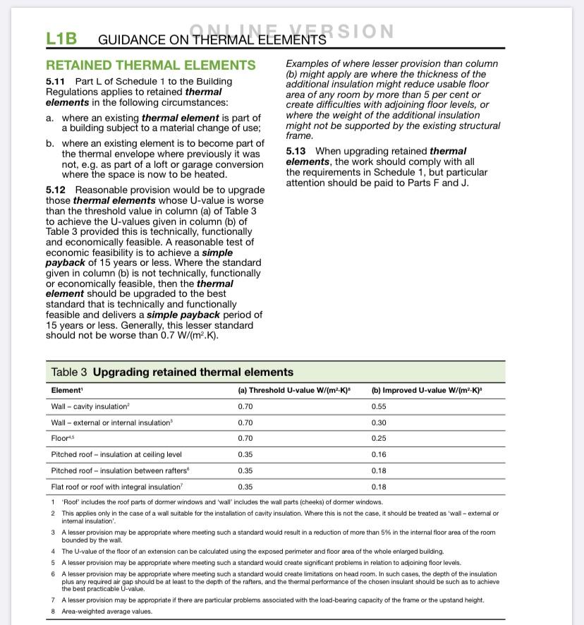

Porch, internal door and building regs
DevilDamo replied to clickclick23's topic in Building Regulations
For loft or garage conversion, you use the u-values as stated in L1B (Table 3) as attached and not those as stated in in L1B (Table 2). Table 3 is in relation to “Upgrading retained thermal elements” and Table 2 is in relation to “Standards for new thermal elements”. This is why I was trying to think why to upgrade a garage wall for a conversion, you’d need to meet the threshold value of 0.70 or improved value of 0.30 but you wouldn’t apply the same criteria for a porch wall!?! -
If like you say both porches and garages exist outside the thermal envelope of a dwelling and are therefore not built to be a part of a dwelling, why would the upgrade of a porch wall need to provide min. 0.28 but the upgrade of a garage wall need to provide min. 0.30? -
I agree all elements would need to be insulated to meet current u-values. But why would they need to meet the u-values for ‘new’ thermal elements if the elements are existing and are to be upgraded hence needing to meet the threshold or improved u-values? -
That’s for a new element, so wouldn’t they relax the requirement as it’s more of an upgrade/renovation... similar to a garage conversion where a threshold u-value of 0.7 and/or improved u-value of 0.3 are required? -

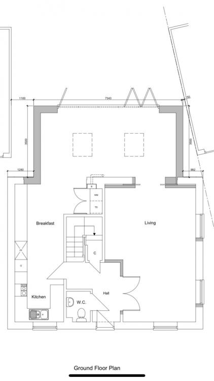

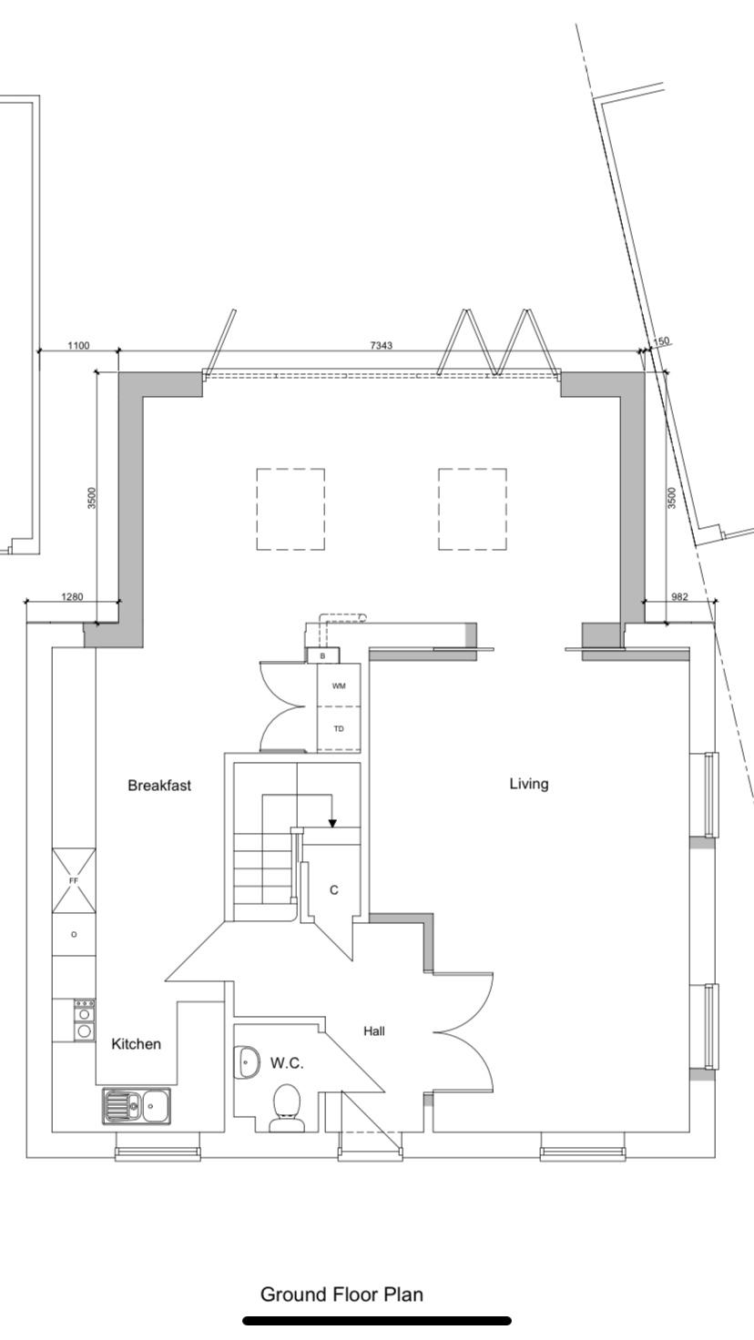

building extension - sloping roof detail to angled end wall
DevilDamo replied to Wayne B's topic in Introduce Yourself
I’ve recently been involved something similar and convinced the client to run the new wall perpendicular with his rear wall as opposed to parallel with the neighbours’ garage wall, as attached. -
