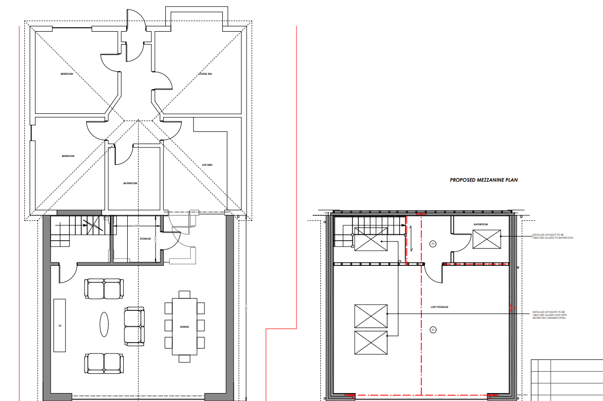

  1. Hi all, I am about to begin the process of doing some major works to my house and I wanted some opinions on what you guys think of the design and if you think it is possible. I am looking to both extend my property and convert the loft. I currently live in a detached bungalow on a street with a mish mash of houses. Next door is a two storey house, the other side is a bungalow with a huge extension and then mine sits very small in the middle. My idea is below: A double hip to gable conversion, this will open the loft space up massively. Currently I have 2.6m joist to underside of the ridge beam, so I don't have too many concerns there. The space planned to use for the stairs follows the roof line up, the height restrictions would not be a problem for the 2m headroom requirement. The area that I am unsure on is the extension. although I could add a nice extension under PD, I want to take it a step further and I don't mind applying for planning if I can achieve the result. I would like to extend out roughly 6-8m and then make use of the upstairs space as a master bedroom. effectively one big loft conversion when you include the current house. The master bedroom would have a glass gable end window with a nice little balcony (the beauty of south facing garden). My garden extends out massively, I have no problems with taking up space by extending. I have attached a basic idea below (both options of roof pitch), which leads me on to the next area of uncertainty - can you build the wall height of the extension higher and decrease the pitch of the roof to allow more standing head room across the width of the new master bedroom or do it have to run from the current height of the existing brickwork? My knowledge is very small on restrictions, so I could be well out with my ideas but I value anyone's opinion highly. Don't worry about budget too much but I'm interested to hear what you would estimate. If I have missed anything, feel free to ask me any questions. I tried my best while using Sketchup to create my first 3D house model, so the details aren't quite correct lol. Thanks for taking a look! E

  3. Thanks for the comments back. I think this is the layout we will go for, next question is how we do the roof/ceiling. Does this type of design lend itself to a vaulted ceiling or would you suggest otherwise? you can see the roof as it is now from the images i posted last year. Cheers, E
  4. Hi all, Back to my old thread here but we are a year on and the house mentioned above has been a dream for us. Now we are looking at an extension, but I wanted an opinion from some of you. I have attached a layout that I think would be nice (not exactly to scale, just a sketch up of an idea i have done.) I have put our current floorplan underneath so that you can see for reference the idea i am going for. There are are a couple of things I'd like to do/keep listed below If possible, avoid moving kitchen (back will be knocked out but will create an island type bar with the sink on with an open plan to the new lounge space) although if something really works better, I would do it. We need to keep a hair room for my partners business (doesn't need to have windows) The house has to become a 3 bed The master bedroom (currently room 2) will ideally have an en suite & room 3 which is the lounge at the moment will become a bedroom (if the idea I go with sticks) The open plan part is going to be some sort of vaulted ceiling with bi-fold doors onto the garden. My main concern is that if I go with the design attached, when it comes round to having children, they will have their bedrooms at the front while the master is at the back. Would this be a concern to you guys if you were a) building the extension yourself or b) looking to buy the house with children? It's worth pointing out that we live in a really nice village area, not busy and we have the most fantastic neighbours. Thanks for taking the time to read this E

  7. Thank you for taking the time to put that together, its an interesting idea. I hadn't considered moving the bathroom because of it being extra work (on a budget very tight for first time buyers). I also hadn't thought about re-arranging internal walls because I don't mind how the current plan is but its worth taking into consideration. I figured that extending back on the currently property (full width) would work out easier and cheaper. What are your thoughts on doing this in timber frame? I plan to render the entire house white (as a few have already done in the street) so the rear would match.
