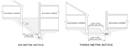

Excavation, PWA, Back neighbor, Unknown Depth of Foundation
DevilDamo replied to MAR UK's topic in Introduce Yourself
But that would be made up ground. The 1m isn’t just a distance measured from a made up level but natural ground level. -
600mm down for what... your new foundations? If so, that would never be acceptable to Building Control because as mentioned before, the minimum is usually 1m even for single storey extensions. As @Temp has mentioned... if you’re building min. 3m away then you’re pretty much sorted on the foundation front. Unless of course you end up having to pile, which is more so to do with the ground conditions. -
If you’re excavating within 3m of your neighbour’s building and your foundations will be deeper than theirs, then the PWA would apply. With new foundations having to go down at least 1m, it’s not easy to ascertain the depth of their neighbour’s so you end up serving notice because of the unknown. You can download templates from the PWA yourself and serve those as opposed to appointing a surveyor. The attached should help clarify. -
