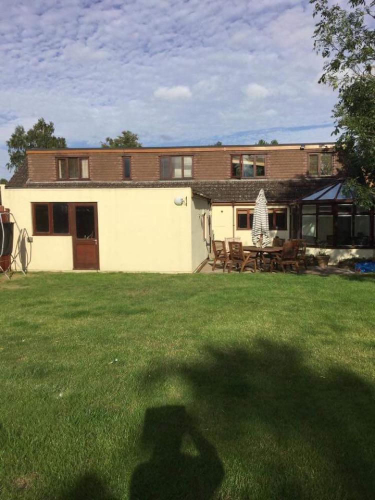

  3. Thanks Iceverge, here are the pictures. I will also post another of what the back of the house looks like now.

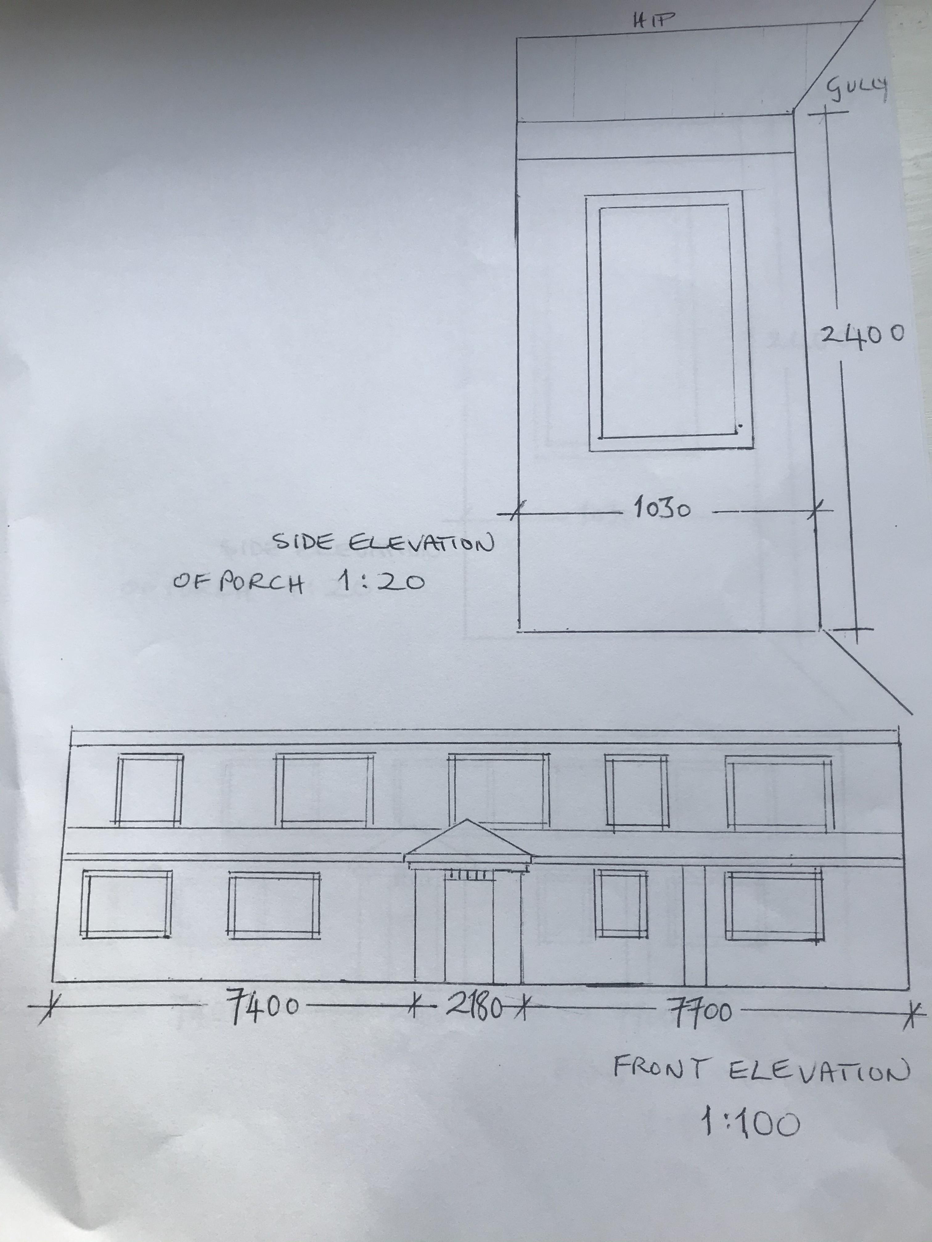

  5. Thanks Iceverge. I think it would look a lot better with a slate style roof, it’s just budget. Tempted to try and get the roof cleaned and resprayed dark grey, which I think you mentioned before, but it’s a risk. I will work on the dimensional picture.
  6. Hi everyone, thanks for all your previous comments, everything has been on hold but I can, at last, start planning this project again. Currently looking at rendering the ground floor, new grey windows and some kind of bigger feature porch instead of the current one. Still undecided what to do with the dormer, could continue the white render or possibly clad it. Here are some badly put together pictures of how it might look with a dark or light dormer and with the porch flattened and a bit of landscaping. If I could extend the porch out and along it would break up the front and be much more practical. I'm working on some better pictures but finding trying to incorporate the porch quite challenging. I like the picture below but not sure how that type of porch would fit with our house. Thanks.

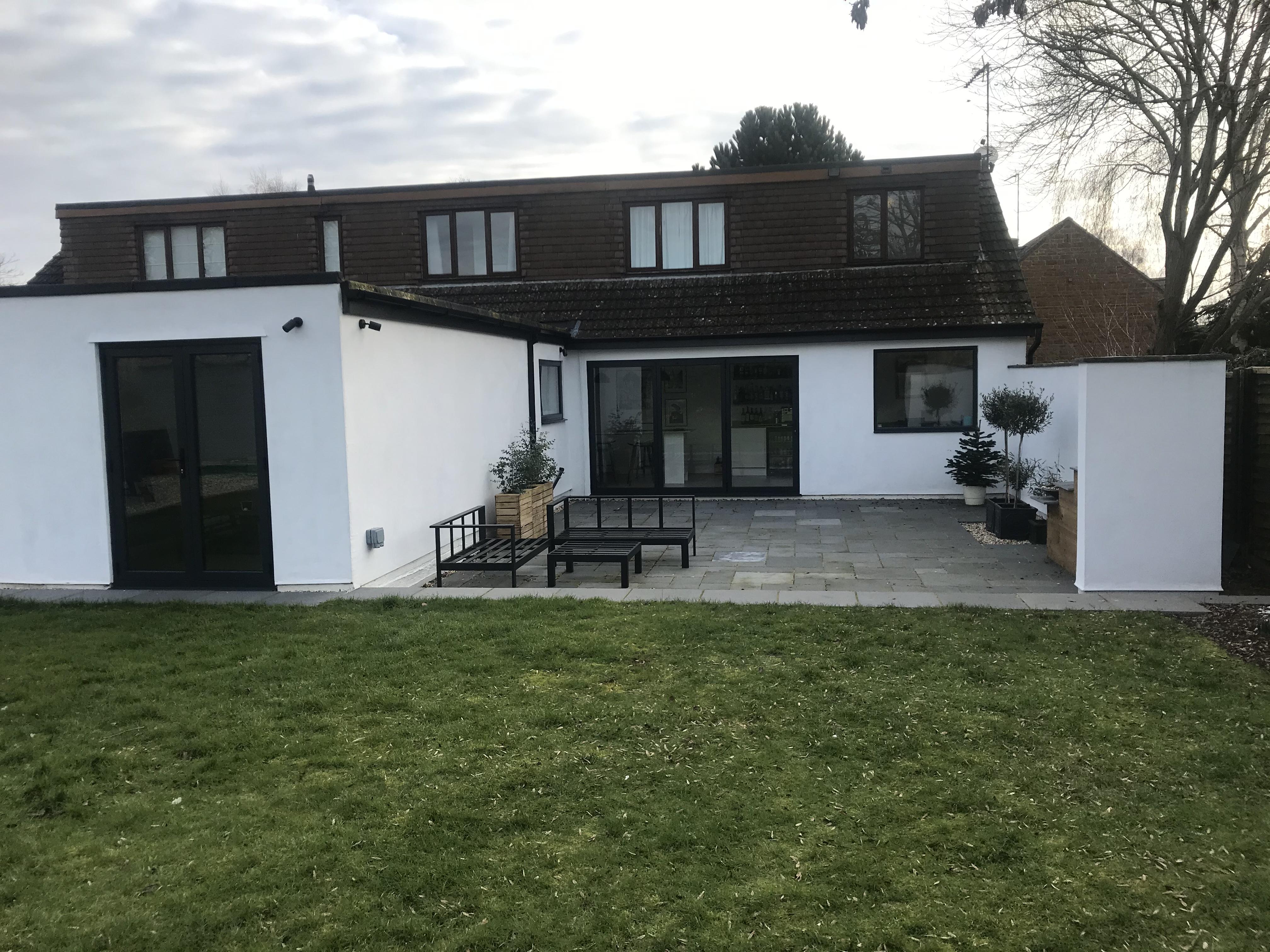

  9. Thanks everyone. Nod - I like the idea of incorporating some insulation when we do the front. We didn't do this at the back as it was already partially rendered and we are just making good and painting it - see picture below. Any advice on adding the insulation would be very welcome. I do like the use of stone in your photo, I think mixed materials may be a good idea to break up the too wide shape of the house. Puntloos - I love that look but would be over budget I think. DevilDamo - budget is about £20-£25k to include both sides of dormer, porch and new roof coverings. Your photo looks smart but I want to move away from the small tiles as the dormer is such a large area. Looking for something more contemporary - maybe wood / metal cladding or possible breaking it up with a mixture of materials which could also be used in limited areas on the ground floor. Ferdinand - I think you are right, breaking it up with vertical elements is the key but which ones would look right is tricky. I really like the idea of something projected on the front - maybe I could work something in with the porch. Will think about the orangery / pavilion aspect. I have added a porch idea I had below I but maybe this look could be extended.

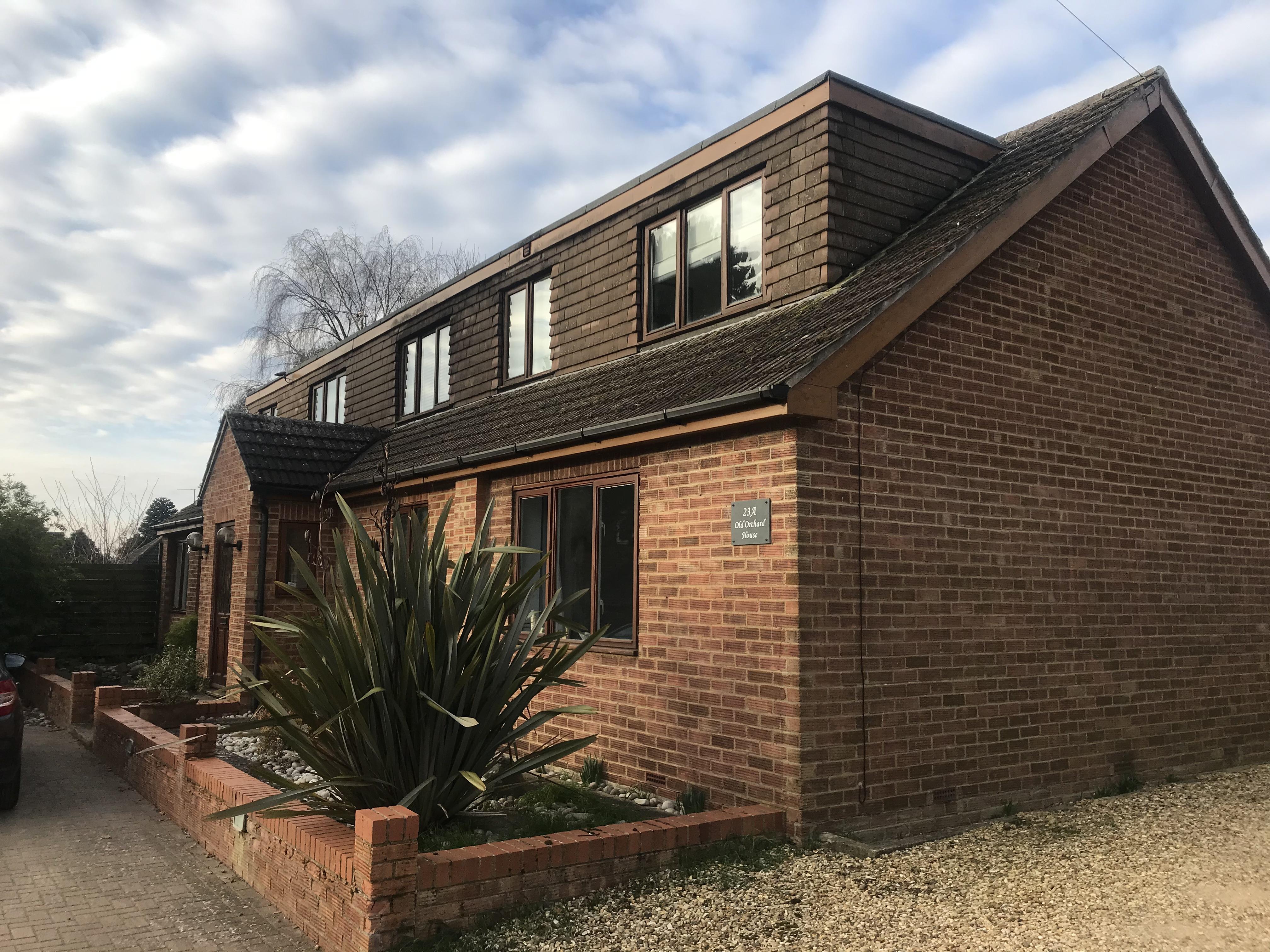

  10. Hi everyone, I am looking for cost effective ways to transform the outside of our ugly house. We are going to remove the current porch which is totally out of proportion with the house and would like something very modern. At the back, ground floor, we now have grey aluminium windows / doors and white render but the box dormer above it and also the whole of the front needs a complete make over. We are on a budget but would like something low maintenance and striking. We also plan to re do the steps and front wall by drive to fit. Any advice welcome - thank you.
