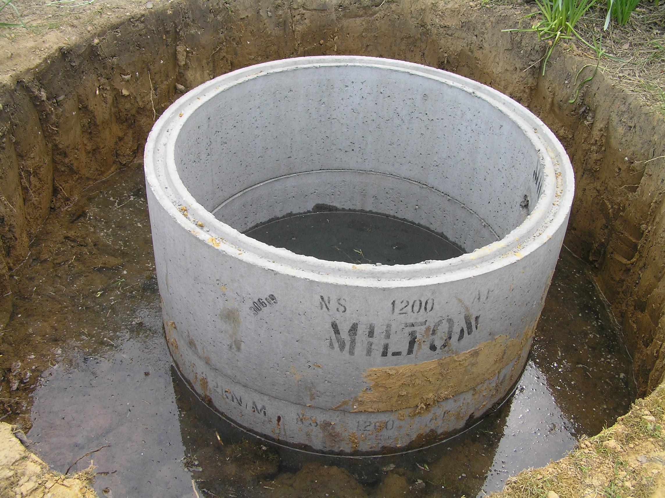

I used some 1200mm rings for my well before the borehole was drilled. The only problem is they have a couple of lifting holes in the side but I plugged those with concrete. I core drilled a 127mm hole for the 110mm soil pipe.
