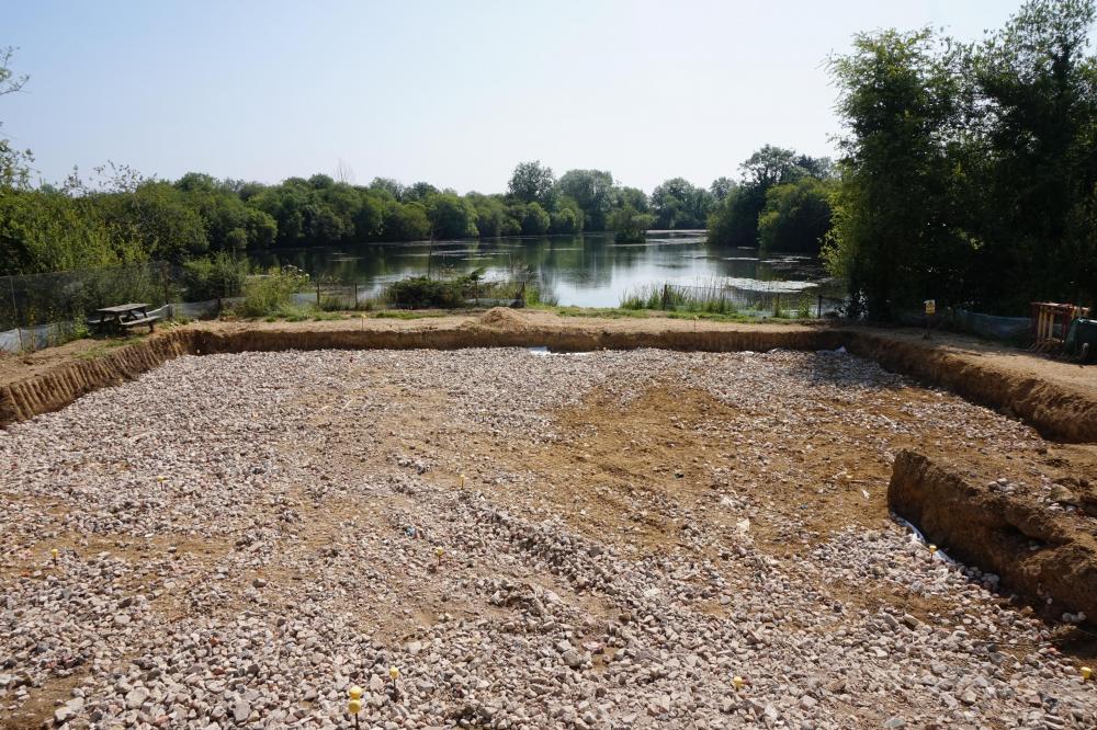

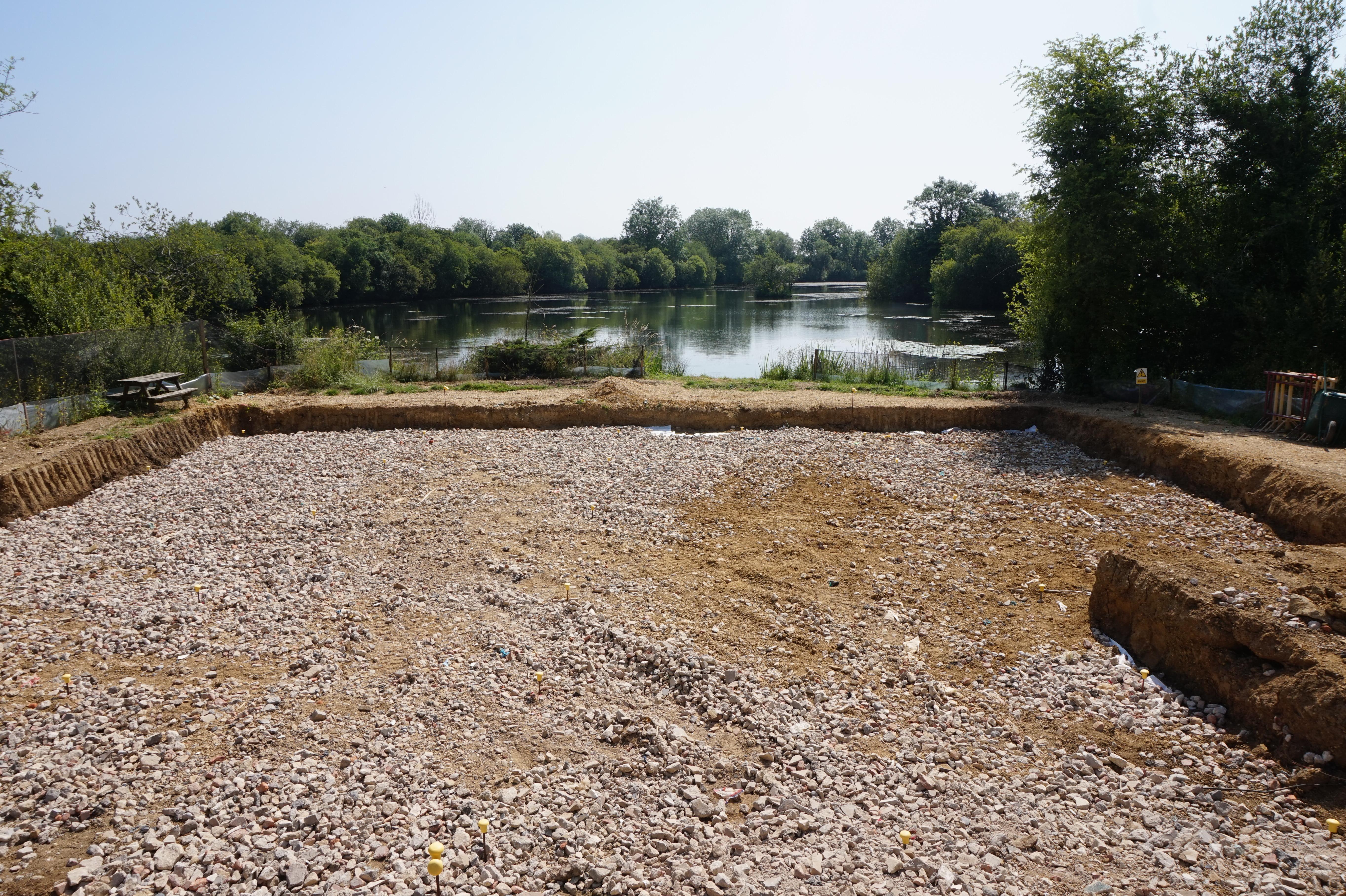

  15. Dig it all up, chuck it through a small mobile crusher then spread it all back on the ground then when you mark out your footprint you just dig through it. It seams a bit of a waste but it pays for itself over and over with having a nice working platform and no mud.
