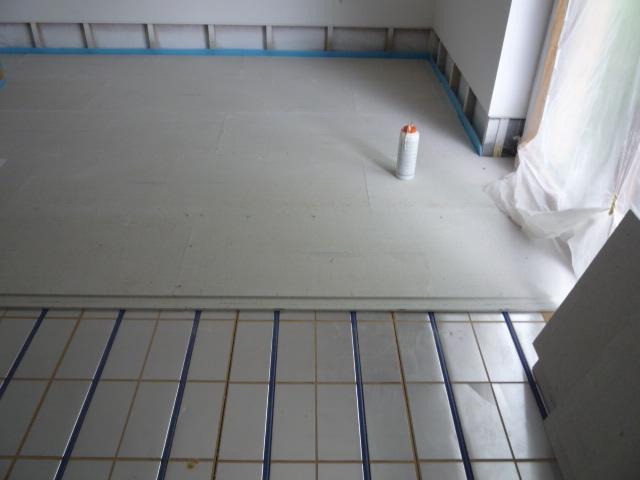

This is essentially what I installed for my 1st Floor. I used a relatively expensive system, with some focus on the sound proofing aspects, but there are much cheaper systems available with different floor buildups. i enclose the Firmacell flooring info and the integrated product I used ECO-10U Pt E.pdf Fermacell_Flooring_brochure_s_1109.pdf
