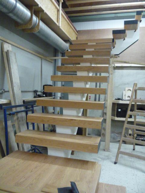

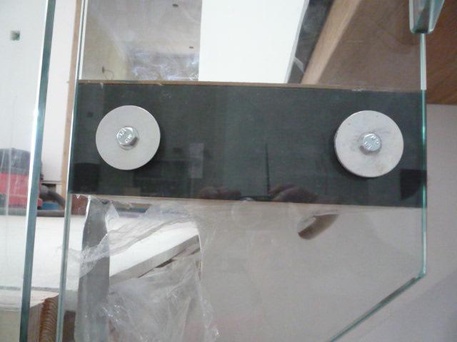

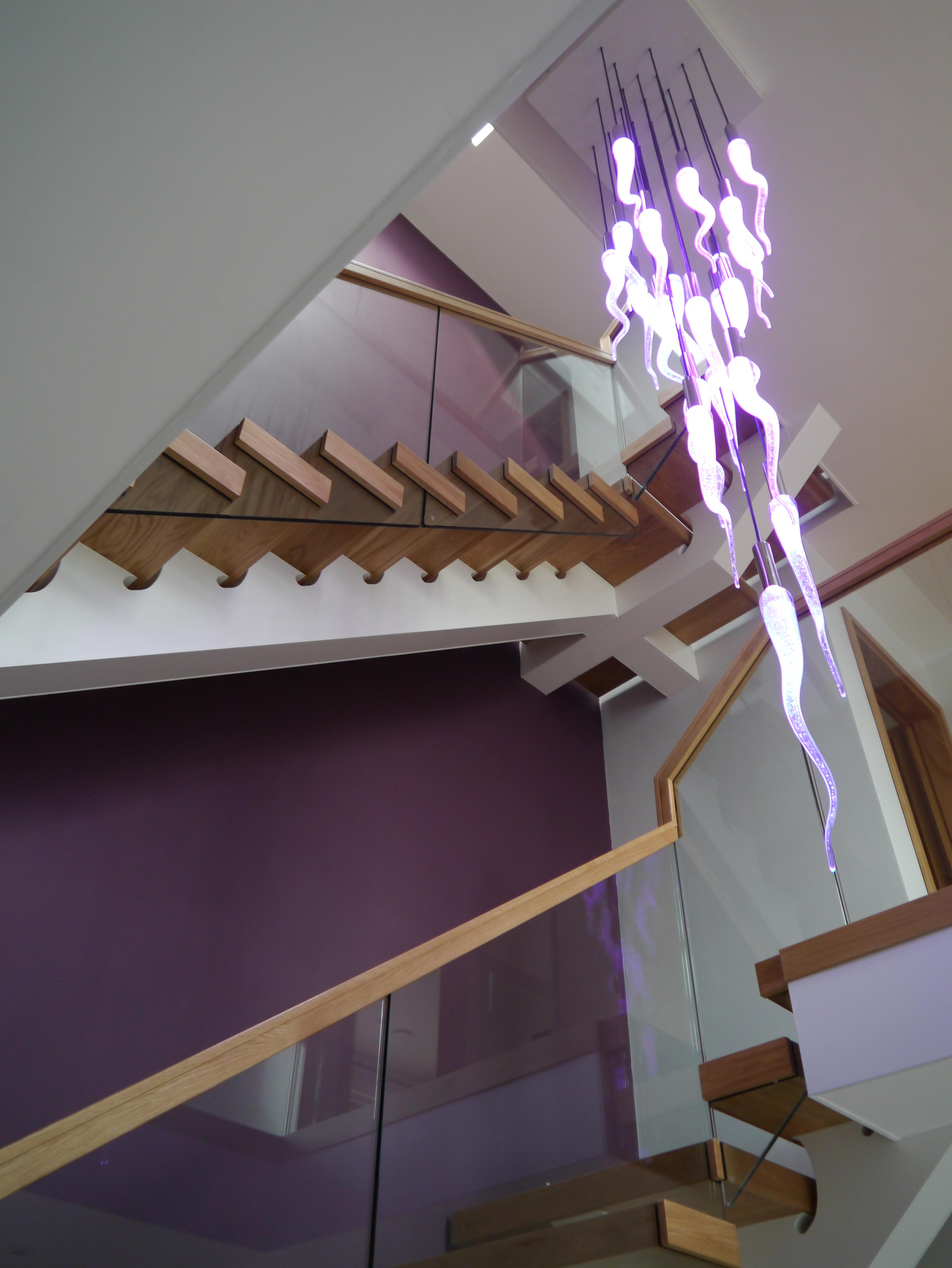

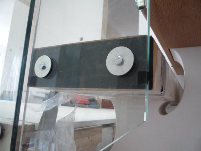

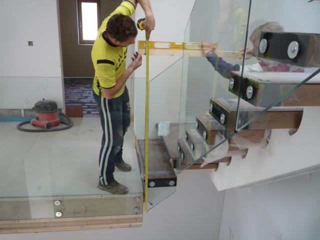

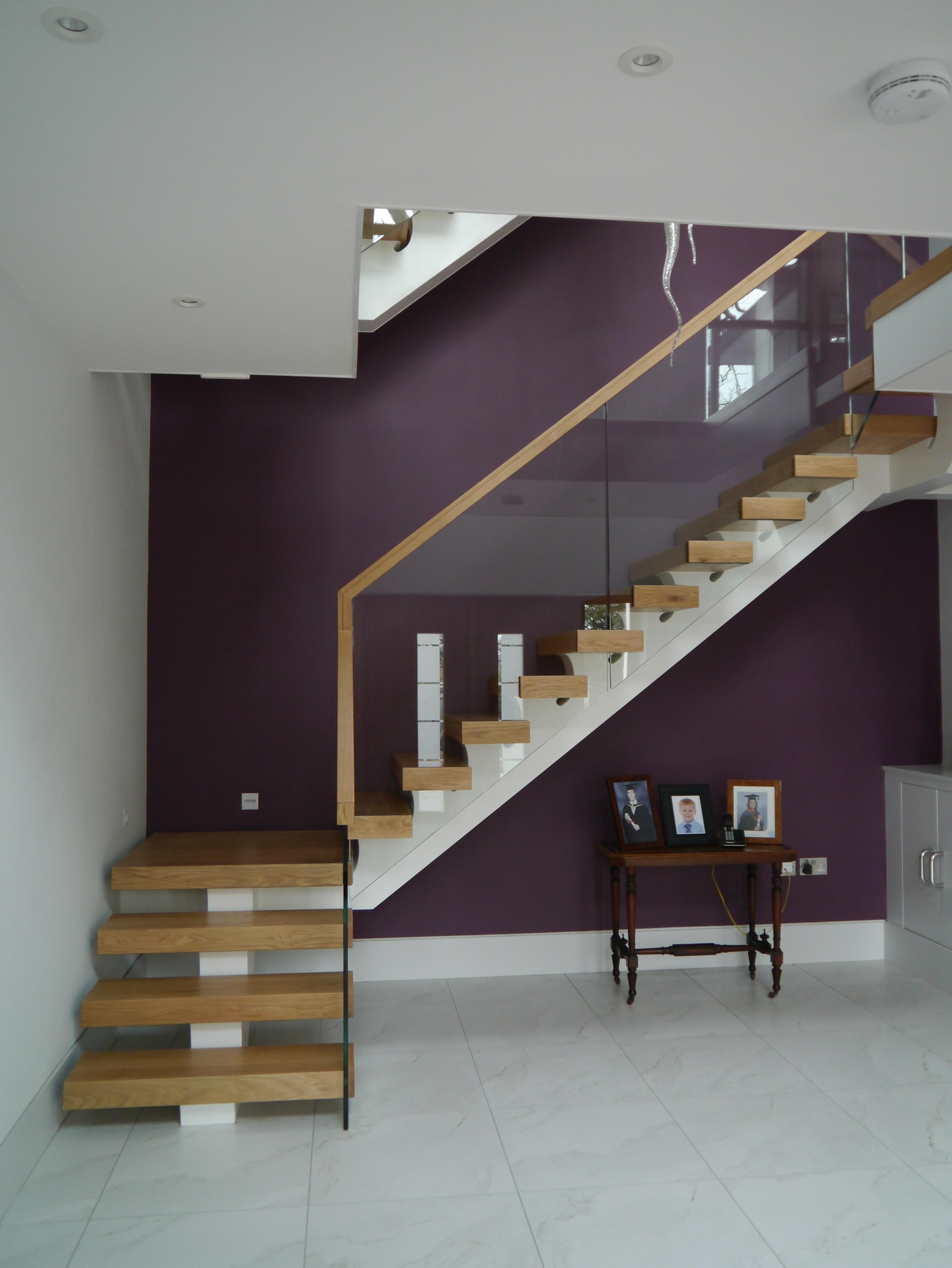

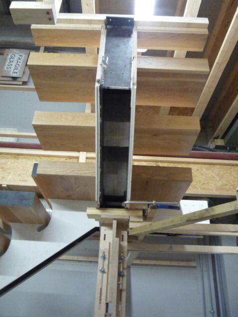

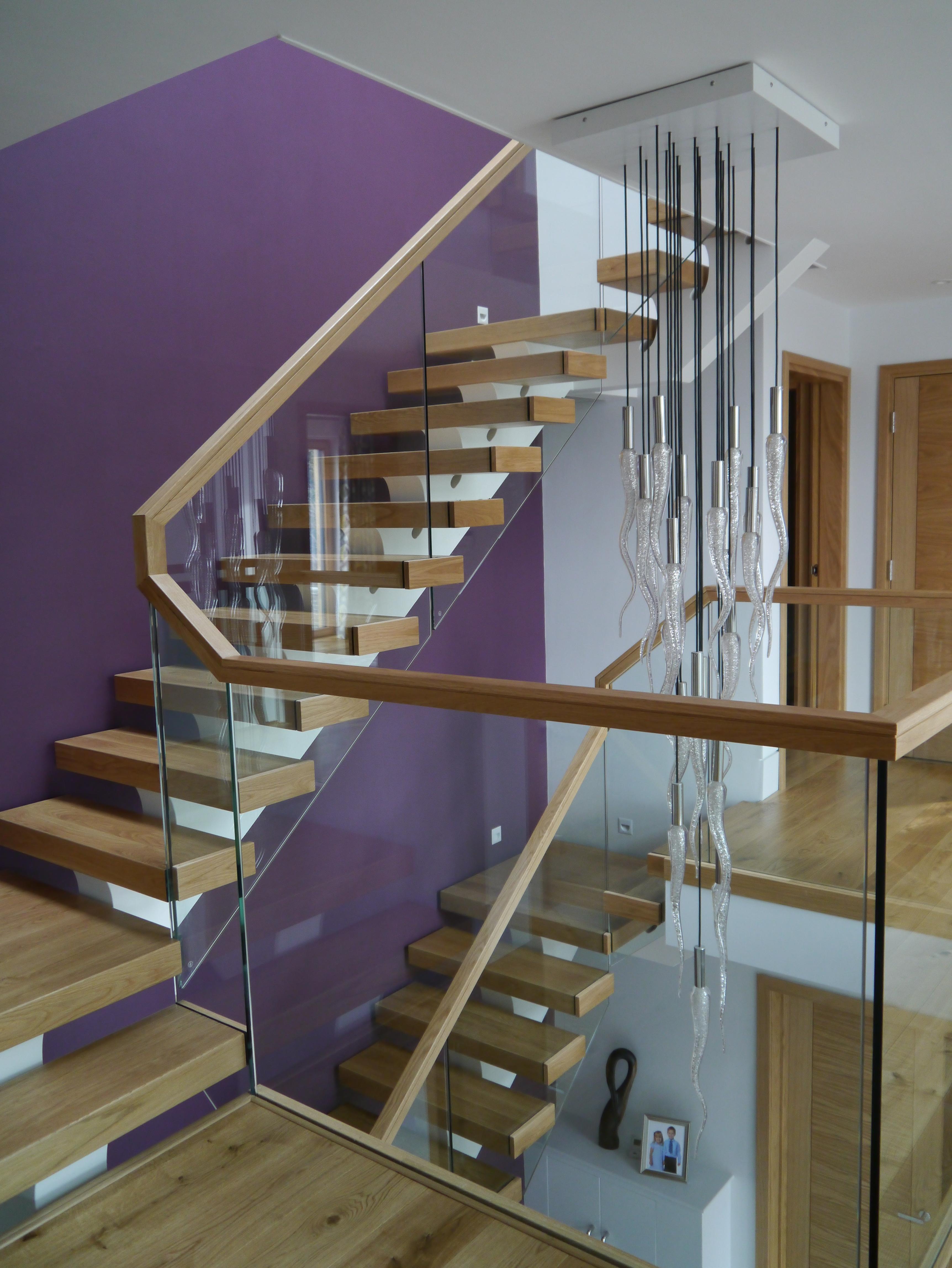

Very nice stairs. We installed something similar, using 12mm toughened glass with similar fittings. It was designed, manufactured and test fitted in the works by a great company in Dublin, Jea Stairs. It was installed in the house, a timberframe build, and fitted perfectly.One of the photos shows the test fitting on a steel plate fitting base, in the works. the stairs are oak and Jea supplied all the glass, handrails, landing capping pieces and installation materials. My two cippies installed it, with a bit of additional muscle for some of the glass panels. -
