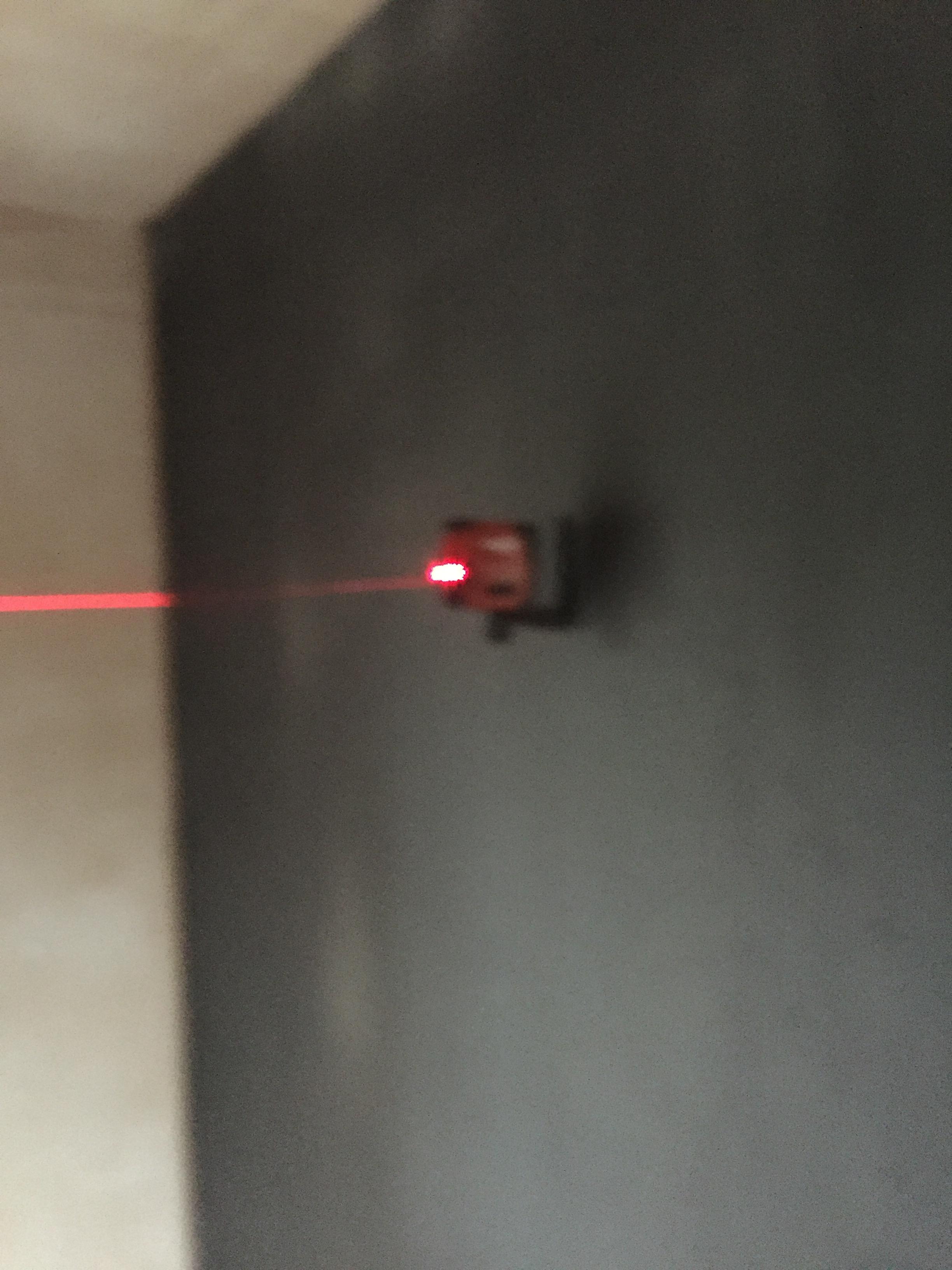

Yeah I thought was a bit gymicky at first But it's quite impressive I can place my Hilton line laser onto the magnetic plaster At 2kg that quite impressive certaintainly enough to hold a framed picture
About five years ago I was asked by a local building company MD if I would do some of his barn conversion walls in magnetic plaster Children's rooms study kitchen etc Since then they have started offering it as an optional extra on some of there more pricey developments which has got me thinking with our build It would be nice not to have a pin board in our office and reminders stuck to the fridge in the kitchen Its quite pricey at £70 a bag )5 mtrs) But not a fortune in the grand scheme of things Has anyone else used or intending using this product Gary
