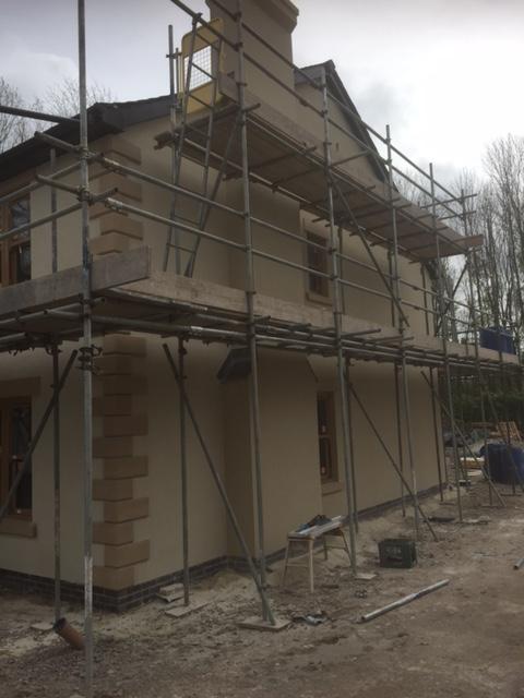

  4. Unlikely to get water soaking through K rend But you still need trays above all openings With at least a couple of weeps on each Ive just fully K rendered mine I set the weeps at 15 mil and rendered over them When I rubbed up the render the following morning the weeps reappeared I set all the weeps right above the heads and 150 out with a central weep for larger openings So I new were they were You really don't get much render going inside the weep I jus poke a fine nail in to clean them out The L shaped type are best for render as you are left with only 10 mil showing

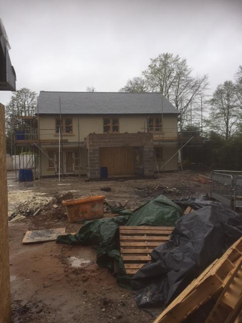

  5. I finished the render off this morning Just the Orangery to do and the two garages I can now get rid of the scaffolding and put copings on the orangery and the GRP on the roof We are going to get the outside looking something like before stating the inside of the house

  6. I took advantage of the good weather Yesterday and this morning to get another side completed

  12. Hi all ive not been on the forum for a while As you know we broke ground in November The two double garages went up pretty quick the help of a labourer I soon had them roofed in Somewhere dry for storage at last Christmas so us up to chamber Myself and my wife spent most of Christmas putting the I joists in and the 8x2 joists for the orangery We just managed to get floored out in time for the brickys return from holiday The brickys offered to help us man handle the twelve mtr trusses up The following day a friend and I and the brickys labourer set the roof out I went in the following day to make the valleys up and finish the gable restraints Next my wife and I spent two days felting and battening Then the 4000 slates We had intended getting someone in But the quotes were ridiculous All wanted me to get the slates up there prior to there arrival So we decided to do the slating a lead work ourselves All went well apart from rain virtually every day Myself and my son made fast work of fitting most of the windows Then last weekend the scaffold was dropped and rebuilt on Monday The forecast was good for last week So my son and myself made a start on the K rend Three days so us complete one side and all of the front Ive prepped the chimney and remaining gable and should get them complete tomorrow and rubbed up on Tuesday Well that's about were we are up to Ive lots of photos Perhaps should have posted as we went along But with working full time and working on the at nights and weekends I tend to nod off when I eventually arrive home regards Gary
