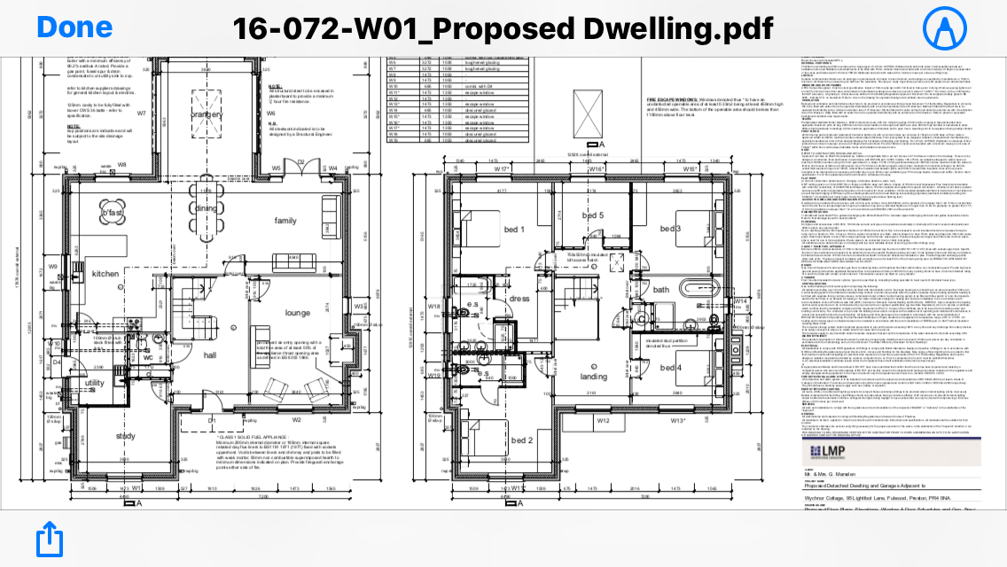

Thank you Nick That is a massive help As I’ve already stated one heating guy has suggested siting the cylinder under the boiler to save running pipe work across the house Is that feasible with pipe work etc im curious as to why the architecht has put it upstairs so far away from the boiler Is there anywhere that I can send my drawing off to and get a heating system design Thanks again Gary
I will have a look through my paperwork when I get home The 10 kw for the UFH is what Cadmans quoted as the max needed to run the UFH
I had a couple of friends down to have a look at first fixing plumbing and heating Both fully qualified it conflicting opinions ive 134 mtrs of UFH downstairs Cadmans have informed me that this will need just under 10kw of boiler capacity One has said Use a system boiler with a storage cylinder 250 ltrs sites under the boiler the othe 300 sites upstairs as shown on the drawing id prefer baxi thought 40kw told max is 32 in this type of boiler one says to small Other say fine Is there anywhere I can get a P&H drawing done To sort this out Any advise pls
