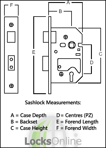

  18. If I've understood correctly you want one with a 60mm backset (backset is measured from edge of door to centre of keyhole/spindle). Dimension "B"... https://www.locksonline.co.uk/community/how-to-measure-door-locks-the-complete-guide.html
