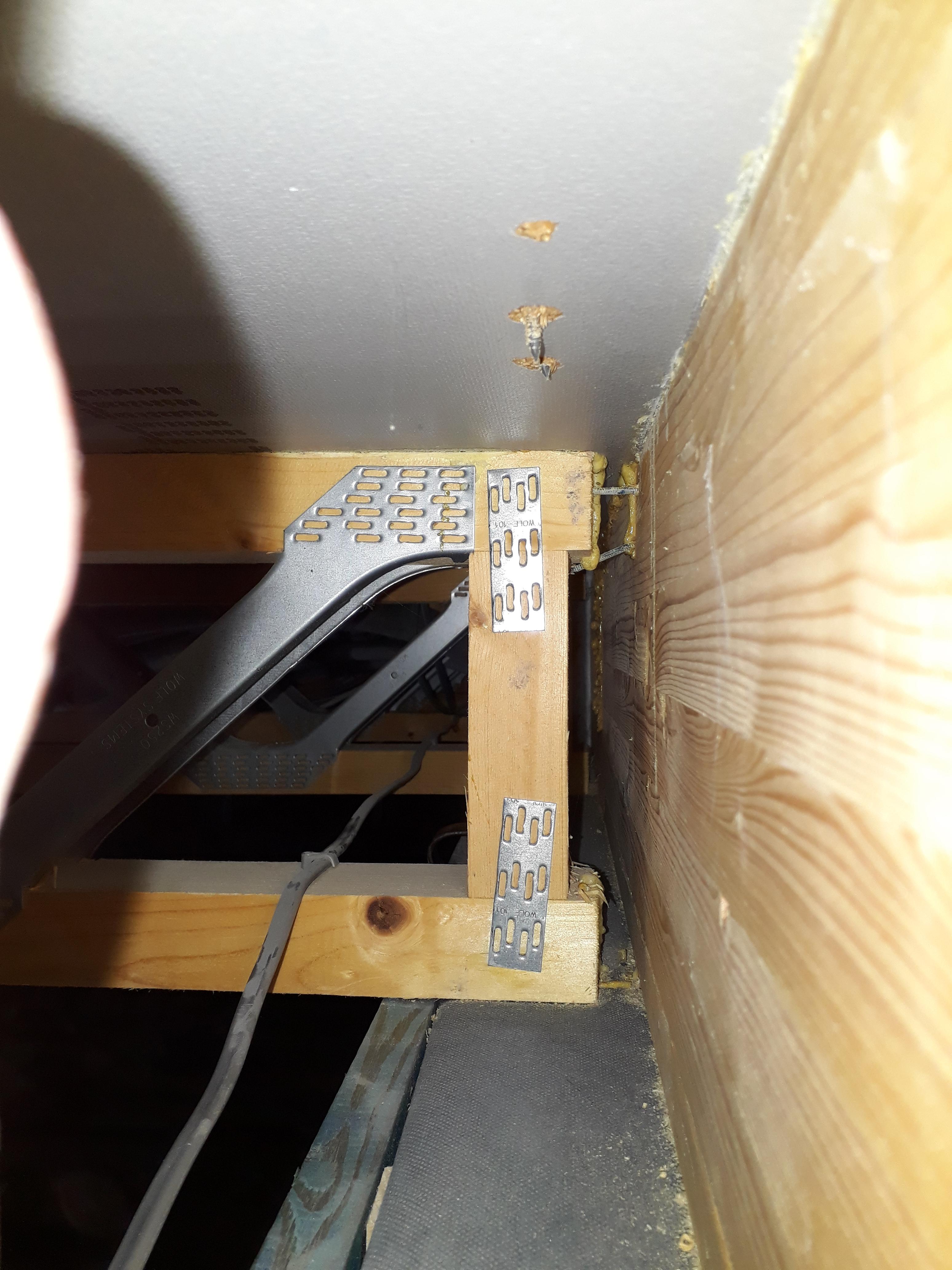

The frame company 'checked' the frame before they signed it off - if I'd got the experience I now have back then, things would be different. BC tend to rely a lot on the trades self certifying their own work.

just to make @recoveringacademic feel a bit better - see picture below. I've been sorting out these snags before I plaster board. I missed this one when the professional / full time / chippy put the frame up. Short cuts by others have cost me a lot of time. Next timber frame will be closely inspected as it goes up. Sad that the professionals don't get it right.
