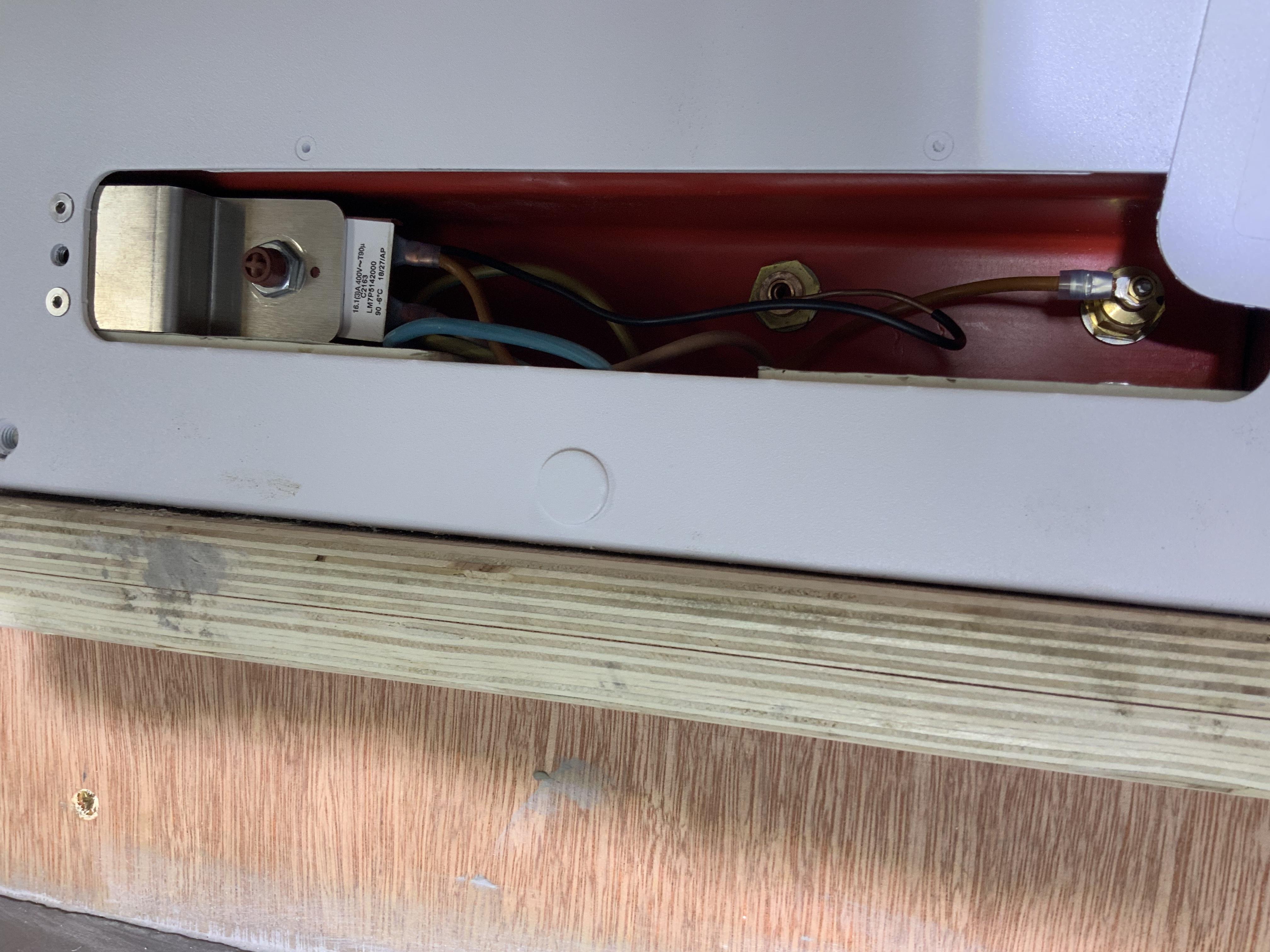

Yes, my understanding is that it’s just one element. I’ve been told that the actual heating part is much longer than a standard immersion element and is designed as such to maximise its life as its non serviceable. That’s a point worth repeating; the heating element is in no way serviceable and if it fails then the whole unit needs to be replaced.
Heres whats behind the service cover
Have a look at Nicks comment about it being 3 x 1kW:
Nope. I’m fairly certain that’s not the case. There was a lot of miss-information and specification changes in the final throws of development.

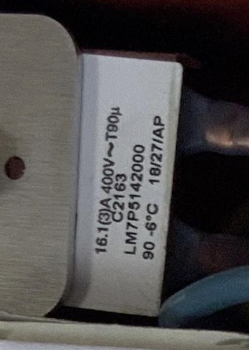

Close up of label:
Edited by Barney12
So...2.8kW is all all nothing. With 3 x 1kW it could have been controlled to gradually ramp up further limiting overcooking. And how hard FFS to make the "immersion" removeable?

9 hours ago, Barney12 said:
Close up of label:
So the safety stat pops when the bottom 6" of the tank passes 90deg? (looks like a standard sensor pocket...) And the element looks like a bespoke black-heat style jobbie with cold tails through compression fittings.
