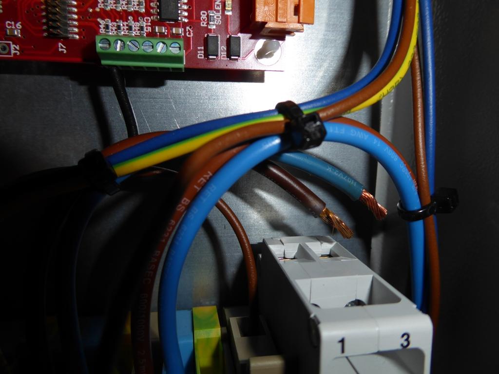

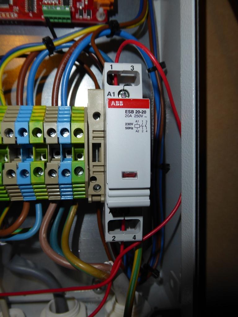

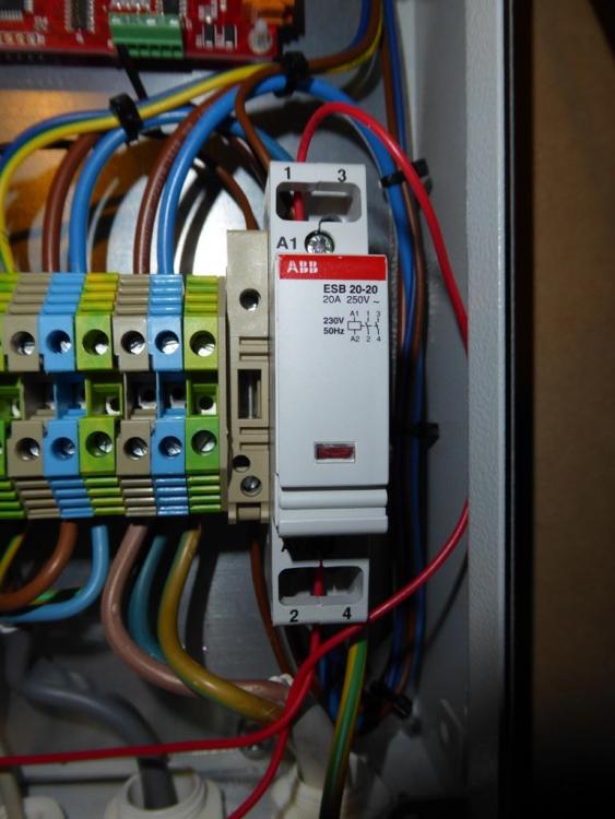

Fitting an ABB 20.20 contactor has restored normal service, and the unit is now charging up again.  I'd like to take the old Finder contactor apart, to see how it's failed, but fully intend to get Sunamp to sort this, as I don't see why I should have to put a replacement £30 contactor into their 6 month old box.

It's damned lucky that I happened to have that new ABB ESB 20.20 contactor sat in my "may come in handy" box.  It's a spare for the contactor that switches our water pump on and off, so I'll now have to go and buy another one to use as a spare.

We now have hot water back, thankfully.  There's enough excess PV generation to start the Sunamp charging, and the water's reasonably warm.  I'll definitely keep an eye on the contactor for a while, and might add another neon indicator to show when there's power going to the Sunamp heating element.  The lack of any sort of status display on the Sunamp UniQ series is a real PITA, as you have no easy way to see if the thing is working properly.  The Sunamp PV was great, as it had four status LEDs on the side, so you could see at a glance what it was doing.  Not fitting any sort of status indication at all to the UniQ range seems barking mad to me.

Given that a contactor has to provide isolation between the coil and the power terminals (the Finder one they fitted is is specced to 4 kV between coil and contacts) there is no way that anything connected to the coil terminals could possibly affect the contacts.
Could the resistance of the neon across A1/A2 have affected the coils ability to bring the contactor in properly?
Is there a spare set of NO contacts on that ABB relay. I'd use them to feed the neon.
It's hard to see how.  The contactor is switched by a relay (one of these: https://uk.farnell.com/te-connectivity-schrack/rz03-1a4-d012/power-relay-spst-no-12vdc-16a/dp/1844686 ) that switches mains straight from the always-on supply, and that relay is rated at 16 A, so an additional current of a bit under 1 mA to supply a neon indicator isn't going to have any impact.  The relay on the controller circuit board seems to be massively over-rated for something that only switches a contactor on and off, I'm not sure why they chose to use a 16 A rated relay when they are only switching about 22 mA.
I just wondered if the Finder contactor was priced down to the bone then the (10K?, more?) neon resistance across the coil might have seen it not pulling in properly. Open it up and look at the contact faces?
The neon series resistance is about 330k, but will appear higher, as the neon will be running at around 60 VAC or so, so the current drawn by the indicator will be well under 1 mA (I might measure it later).
The current drawn by the coil is about 22 mA, and has a tolerance of around +/-5%, so, depending on the exact part fitted, it could vary from just under 21 mA to just over 23 mA.  That's more variation than there would be from adding a neon indicator.  Anyway, the source supply is a fused 3 A supply switched by a 16 A relay, so there's never going to be any measurable difference in the voltage across the contactor coil, just from that connection being loaded by another half milliamp or so.
Just been testing the defective Finder contactor on the bench.  It seems to have broken mechanically, as when the coil energises the over-centre mechanism tries to move, makes a loud clunk, but jams.  There's a mechanically driven indicator on the top, and this barely moves, whereas it's supposed to flip and show a red flag to show that the contactor has energised.  Also, it rattles a lot, as if there are loose bits floating around inside.  I'm tempted to take it apart, but that would mean drilling out two rivets, and I really want to get this replaced by Sunamp, given that the ABB one I've just fitted cost ~£30.

I suspect you're right.  The action of the Finder contactor was always a bit violent, in that from new it made a hell of a clunk as it operated, enough to wake the dead.  I've got a four pole 20 A contactor running a couple of socket radials in my workshop (I have E stops around the place to kill the supplies) and even that doesn't make anywhere near as much noise as the Finder one used to.  The ABB one I've just fitted is a fair bit quieter, too.  Makes me wonder if the Finder may have had an incipient mechanical defect from new, given the amount of noise it made.
