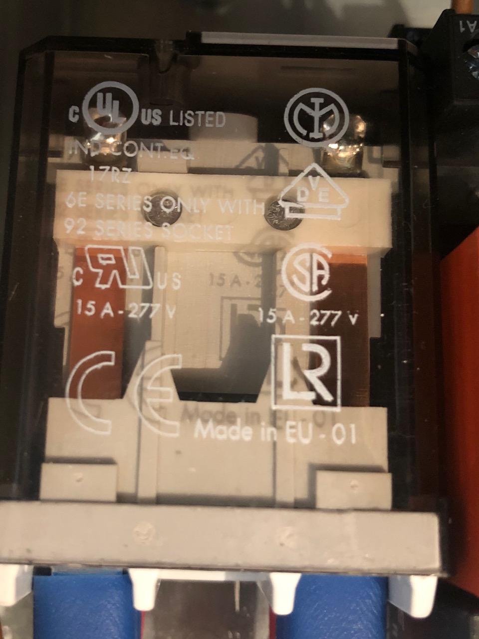

… has been changed to a very different relay in the newer controllers.
You've received the new controller?
No, not yet, but I've been sent a photo of the inside of it, so can see that they've changed the contactor for a larger relay.

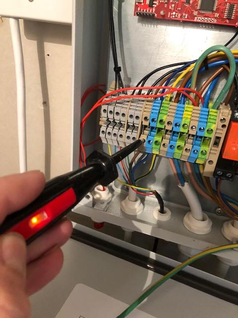

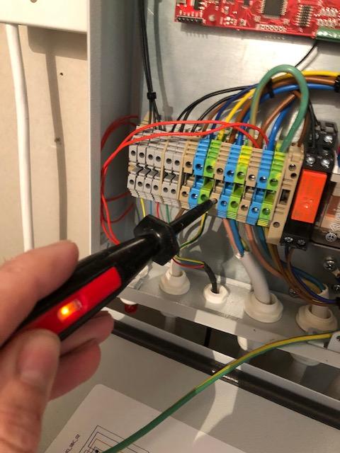

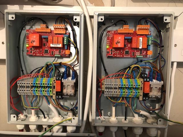

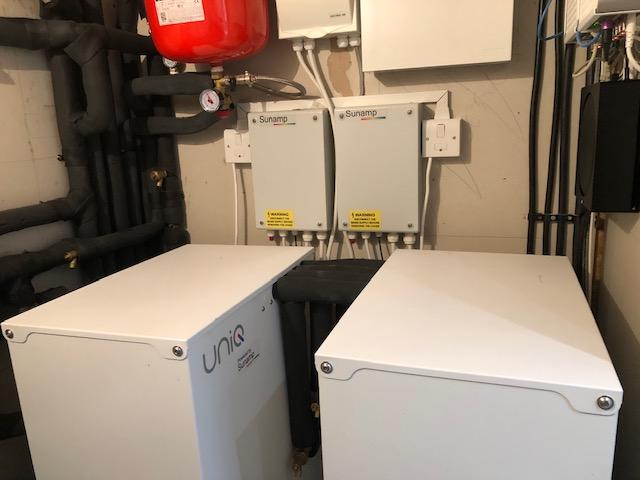

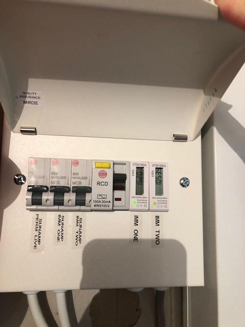

Just walked into my plant room and thought "its cool in here". Then realised both of my Sunamps are cool to the touch. RCBO's fine.
So perhaps I wont go outside and do what I was intending to do and instead fault find these useless piles of shit gooo AGAIN.
OK so thankfully that didn't take too long but REALLY? Can a technology really be this unreliable?
My red indicators (illegally fitted of course!) were not lit and my power meters weren't flashing so I know neither of them were drawing power.

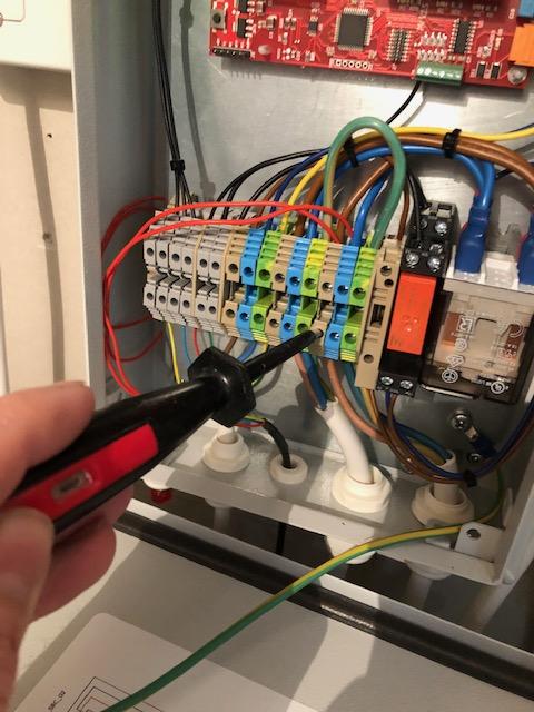

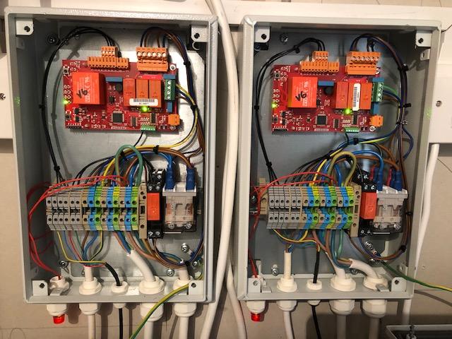

So rather than simply "bounce" them lets see whats going on behind the panels. Board has power but no demand light on. Check permanent feeds and immersions feeds (basic test but couldn't be bothered to go and get my meter). All good.
So clearly no demand for charge:
So now power cylce the permanent supply (They are switched independently you can see the switches either side) and TADA they both start demanding charge.
Of course there is no way of knowing when they stopped calling for charge. I'll get some idea once they've both fully charged as I can see how much power they consume.

Just pulled the contactor out.  It's a Finder 22.22.8.230.4000 and it's definitely buggered (this is the thing: https://uk.farnell.com/finder/22-22-8-230-4000/relay-dpst-no-250vac-20a/dp/1169295).  Looks like it's been overheating slightly on the line in terminal, although all the screws were tight.  The closest I've got to this is a spare 20 A, DP, ABB contactor, rather than the 32 A ones I use in the car charge point.  ABB stuff tends to be a bit better than Finder stuff, IMHO, so having checked that the spec looks similar I'm off to fit the new one and see if that fixes things.
Jumping back to your thread. My controllers are relatively new (my third set!) and this is the relays in my units:
As you know, the primary issue I've been having has been the controller periodically not calling for charge.  My fix has been to turn the controller off and on again to reset it, much as you've just done.
The slightly worrying thing is that your controllers look like the new ones that have the new power relay and, I thought, the new firmware to get around the failure to charge issue.  That's slightly worrying, as I have a new controller on it's way to me this week, that I suspect may be the same as yours.
Out of interest, do you know the model of controller you have?  I've been told that the new controller that's heading my way will have the B_100 firmware,  although I can't find the firmware version anywhere on our controller.

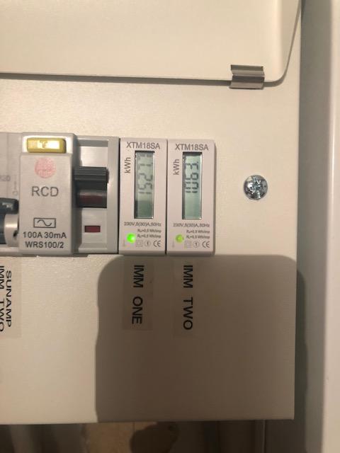

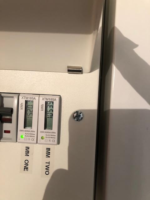

So they both consumed electricity and stopped accepting charge after my bounce as follows:
(readings from the meters)
Unit 1: 3kwh
Unit 2: 6kwh
This suggests that Unit 1 was at 75% and Unit 2 at 50% (Mine are 12kwh units). They should be demanding charge at c50%.
Whats really getting me to scratch my head is the units were cool, the pipework was cool, the plant room was cool. Clearly they were much more discharged than the figures would suggest.
So are my units fully charging partially? There is no way of knowing as you've got no indication of level of charge.
Yet again the world of Sunamp leaves you largely in the dark! :(

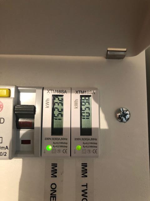

OK, so I went down first thing this morning and took another set of readings. In that time only two things had any demand on the Sunamps:
1 x 5 minute shower.
Aprox 2 hours of the kitchen hot water loop (c12m of 15MM pipe all very well lagged)
Unit 1: 4.5
Unit 2: 4
That's clearly double what my previous logs have shown for that level of usage.
I think all I'm really doing is proving what we already know; the controller (and measurement) system is less than perfect!
