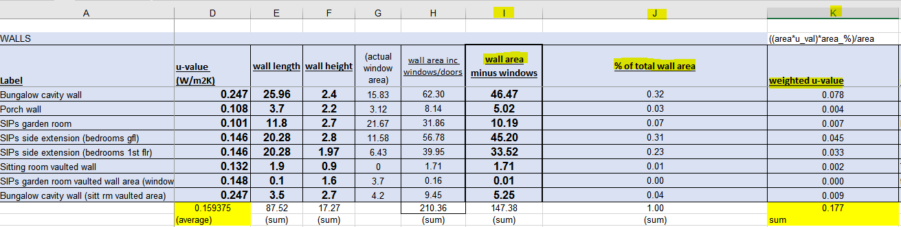

oranjeboom Posted January 9, 2020 Posted January 9, 2020 (edited) Ok, having another go at these calcs in @Jeremy Harris's heat loss tool prior adopting the willis approach (see blog entry). Just seeing if this approach is correct. Wall u-value in B7 - I've excluded any window /door apertures to get a total area for each external (heatloss) walls and worked out the u-values for each. In most newbuild houses this is a fairly simple thing to do as your wall is pretty much the same all round the house! In my case I have a multitude of differing materials (original cavity-insulated brick and SIP walls) so have worked out the u-value for each wall. I have averaged out each wall's u-value according to their respective total wall area (as a%): Column K: ((area*u_val)*wall_area_%)/area Ignore the sums / averages at bottom - just sanity checks! Is that the best approach to take? Certainly gives a better u-value, but it needs to be realistic of course! TIA! Edited January 9, 2020 by oranjeboom deleted confusing duplicated screenshots!!

oranjeboom Posted January 9, 2020 Posted January 9, 2020 Just noted that my entry included duplicated screenshots - now deleted. Simply what I am doing is trying to calculate accurately the differing walls that I have in proportion to their areas. Once I have a single wall u-value, I will obviously plug that into Jeremy's sheet. An example: If you take this example of 3 different walls, it seems incorrect to just average out the u values since their areas differ. In this case, it's like bodgit builder wanting a low wall u-value so simply constructs a couple of walls that achieve that low figure (walls b and c) and then the remaining wall (wall a) achieves a really high u-value. If you simply average those out u get a not-so-bad figure: If however you taken into account their respective wall areas in relation to total wall area and then sum those areas you get a more representative (weighted) u-value of 0.290. So surely where you have walls of differing u-values it's best to take that into account??
Onoff Posted January 10, 2020 Posted January 10, 2020 (edited) On 09/01/2020 at 21:51, oranjeboom said: Just noted that my entry included duplicated screenshots - now deleted. Simply what I am doing is trying to calculate accurately the differing walls that I have in proportion to their areas. Once I have a single wall u-value, I will obviously plug that into Jeremy's sheet. An example: If you take this example of 3 different walls, it seems incorrect to just average out the u values since their areas differ. In this case, it's like bodgit builder wanting a low wall u-value so simply constructs a couple of walls that achieve that low figure (walls b and c) and then the remaining wall (wall a) achieves a really high u-value. If you simply average those out u get a not-so-bad figure: If however you taken into account their respective wall areas in relation to total wall area and then sum those areas you get a more representative (weighted) u-value of 0.290. So surely where you have walls of differing u-values it's best to take that into account?? Expand I feel your pain! Calculating the losses for the bathroom as it's basically now an insulated box (and will be nominally airtight) is something I'd like to do later (along with an airtightness test), these things just out of interest. I've two different wall constructions. On one wall out of the 4 the insulation thickness tapers from 50mm one end to nom 100mm the other where I squared the room off. How I'd calc that I have no idea. Whatever, it's a damn sight better than before! ? Could you not "work backwards" so to speak? As in if having fabric elements of varying construction just choose to ignore then, then measure overall heat loss for the whole house over a period of time and figure an average U value given to total wall/floor/ceiling areas? ...or something like that? Edited January 10, 2020 by Onoff
Gone West Posted January 10, 2020 Posted January 10, 2020 On 09/01/2020 at 21:51, oranjeboom said: If however you taken into account their respective wall areas in relation to total wall area and then sum those areas you get a more representative (weighted) u-value of 0.290. So surely where you have walls of differing u-values it's best to take that into account?? Expand That is the way I would do it, whether that's strictly correct is another matter, but I can't see why it isn't.
ADLIan Posted January 10, 2020 Posted January 10, 2020 The area weighted average u-value is the way to go however if the main wall/Uval accounts for at least 90% of the total wall area just use that value
oranjeboom Posted January 10, 2020 Posted January 10, 2020 On 10/01/2020 at 08:51, PeterStarck said: That is the way I would do it, whether that's strictly correct is another matter, but I can't see why it isn't. Expand Thanks Peter! Seems a lot more accurate using a weighted average than just taking an average. This way you're looking at how much each wall's fabric build up (u-value) contributes to the whole house. On 10/01/2020 at 09:02, ADLIan said: The area weighted average u-value is the way to go however if the main wall/Uval accounts for at least 90% of the total wall area just use that value Expand Yes, I think I took that approach first, looked at my the bigger walls, worked out the u-values and then averaged. But looking at each wall in greater detail (especially those walls where I have been able to squeeze in extra insulation) has altered my weighted figure in my favour. On 10/01/2020 at 06:00, Onoff said: On one wall out of the 4 the insulation thickness tapers from 50mm one end to nom 100mm the other where I squared the room off. How I'd calc that I have no idea. Expand Again, if you want to be as accurate as you can, then I would use a weighted approach than just averaging that whole wall section. Did you insert various thicknesses of insulation against that wall? If you know their sizes still, then you can calculate using above method. If however you just used one sheet and rasped it down to get a level surface and average u-value would probable suffice. Just talking one wall here after all. 1
