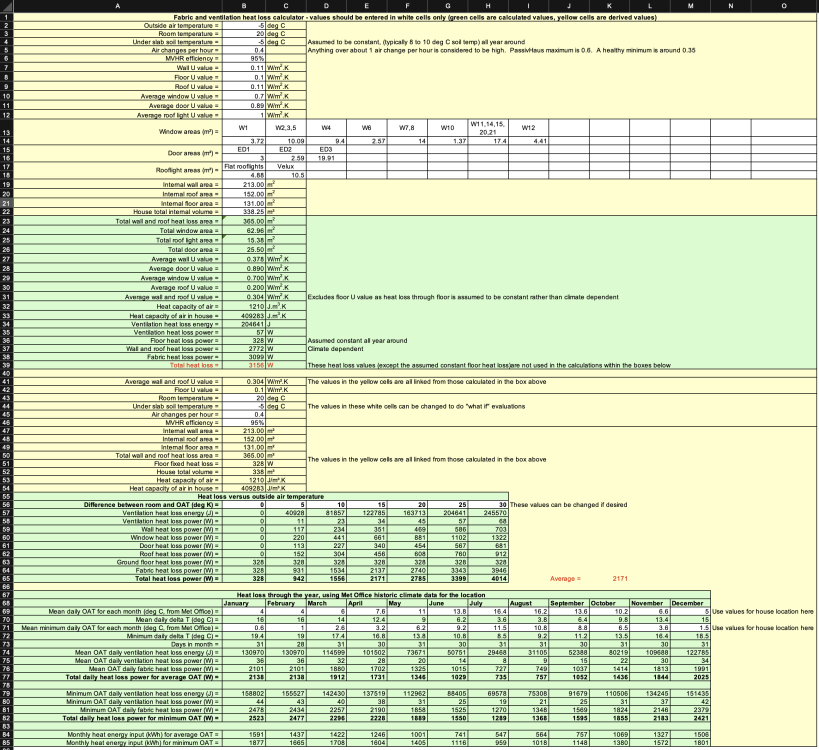

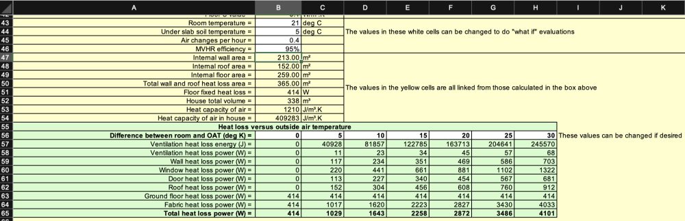

11 hours ago, SBMS said:
The ‘total heat loss’ cell (3090W) gives
your worst case heat loss when it’s -3 outside.
I would question your house volume though that looks really small if you have 259sqm floor space multiplied by 2.4m that’s a minimum volume of 621m3. Are You sure?
@SBMS Thanks. Does that heat loss mean 3kW heat pump?! (not clear what duration it is over - I saw another post that referred to multiplying by 24, assuming it to imply it is an hourly heat loss figure, but basically I'm still unclear.
Volume - I hadn't clocked that was a manual entry and I hadn't changed it. You're correct, volume is 879m3; floor area is 131m2 but tall ceilings and upstairs within the roof space.
'kW' is power, so it's a continuous number. There is no time component.
If you want to know how much energy the house uses, you multiply power by time. For example, 3 kW of power supplied for an hour is 3 kWh (the unit electricity is charged in).

1 hour ago, Great_scot_selfbuild said:
Volume
You shouldn't need to adjust that figure as it's calculated from your inputs.
Don’t think Jeremy’s spreadsheet calculates this it’s a manual entry

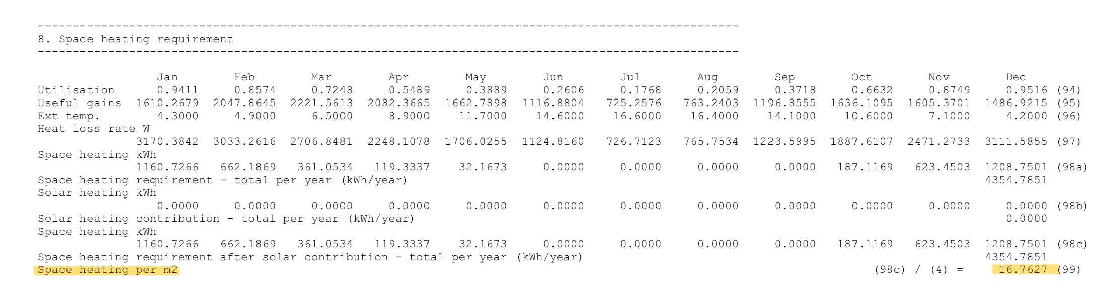

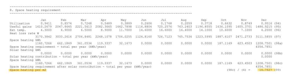

@JohnMo @SBMS @MikeSharp01 @jack @Marvin Thanks for all your input - most helpful. After challenging/questioning the suppliers' quotes they have revised their proposed solution and Cool Energy currently is looking most favourable (MCS umbrella etc.) and has reduced the ASHP proposed down from 14kW(!) to the following:

What have they calculated your design heat loss as? 7.5kW or 4.35?
They used a statement in my SAP assessor’s report that stated heating requirement as 16.7627w/m2; 260m2. (Screenshot attached)
So a big heat pump for house load.  The smaller 6kW one isn't big enough at -3.  So not the best fit for your heating system.
@JohnMo sorry, not sure I follow - you’re saying the 7.5kw isn’t the best fit? They’ve used this SAP figure to give a 4.35kw requirement, and then (presumably) scaled it up to a 7.5kw HP to cover the DHW.
Not that I disagree, just trying to understand - which bit of this shows that 6kW isn’t big enough at -3? And is 7.5kw big enough at -3, plus covering DHW?
You need a couple of hrs for DHW heating. So for 4.35x24, so 105kWh per day.  To do that in 22 hrs, 105/22, is 4.77kW not 7.5kW.
According to the Cool Energy datasheet for the 6kW unit, at -3 outside it has max output of 3.8kW at 35 Deg flow temp.  So isn't big enough for your calculated heat load of 4.35 or 4.77kW. So the only option they seem to have for you is a 10kW unit.  The Cool Energy unit offered has a minimum modulation of 3.89kW, which is fine.  But at 7 degs outside (based on 4.35kW) your heat demand will be around 2kW, so would cycle on off about 50% of the time. Cycling like that is OK, for off time hits CoP, a unit that tick away most the time has great CoP and almost no standby costs.
A Panasonic 5kW puts out 5kW at -3 and will modulated lower at 7 degs
Just been reading up on Hisense 4.4 ASHP, made by Hitachi, will do 5kW at -7 and modulate down to 1.85kW at 7 degs. And only £2k incl VAT (Heat Pump Warehouse).
@JohnMo amazingly helpful and clear - thank you!
It used to be, and I'm not aware of any change, that SAP was specifically not to be used for heating system design.
Just taken another look at the figure used and it's not the heat load in kW, it's the number of kWh per year expressed as kWh per m² per year. So cannot be used directly to size the heat pump.
To make an estimate based on predicted energy input.
So 16.7 (from EPC) x 250 (m²), say 4200kWh, if you then divide by degree days, let's use 2900 (will vary by location and house design), that's 1.4kW. Which is pretty close to what you calculated I believe?
Your heat demand at -3 is around 1.4kW. So ideally you are looking at a 4 to 5 kW heat and certainly one with great modulation. You would have one that size purely for DHW heating.

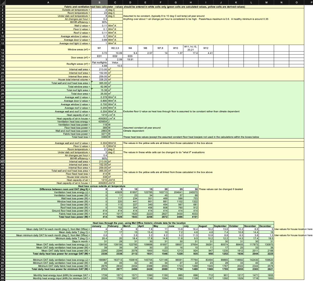

Struggling a bit with the heat loss calculator- trying to do my homework such that I can challenge the 14kW etc ASHP quotes I'm being given by various MCS suppliers.
We have abandoned MVHR for our renovation on grounds of cost and practicalities. The trouble is, once the MVHR efficiency box is empty on Jeremy's sheet I do indeed come up with figures closer to the massive heat pumps being suggested!
However, ACH of course has a massive impact. We will be building with attention to detail in terms of air tightness, but not PH design. Had been planning dMEV in wet rooms and humidity-controlled inlets.
How, then, to estimate my ACH, for meaningful output from the calculator?! Short of doing an air tightness test. (We haven't started building yet)
Apologies that much of this is repetition from my previous posts elsewhere, but I can't quite work out how to tie everything together.
Put in 0 rather than empty.
Put 0.3 to 0.5 in the ACH. This figure isn't airtightness its ventilation heat loss calculation. Airtightness does have an impact but its small if you are doing airtightness detailing.
