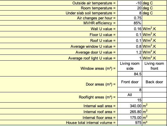

Have been having another play around with the heat loss calculator.  Have a couple of questions - I have plugged in the following numbers:
We have a fair amount of glazing, but to be honest it makes little difference if I remove all the glazing.
This generates an annual heat energy input per annum of about 14,000 kWh. If I take this and divide it by internal floorspace (circa 397m2), the energy per sqm is about 35 kWh per annum per sqm.  Passivhaus stipulates less than 15 kWh.  Even if I removed all glazing doors and rooflights, this shifts it to about 24kWh per sqm but still significantly out.
Am I missing something? How would this figure be achievable? Am I reading the heat energy input values (row 84) correctly? I just added them all to get to the 14,000 kWh figure.

ACH is well high. Reduce to something realistic, your MVHR will be set to 0.3 to 0.5 they are better figures.
-10 OAT, short event, what is the design temperature for your area?
85m2 glazing in your living room - check your figures, 2m high and 40+m wide?
Big front door also 4m tall and 2m wide.

Thanks.
Glazing wise that includes a vaulted rear window, 2 storey glazed entrance and 13m of sliding doors. I put all the glazing into a single column in spreadsheet. As said though, even removing glazing doesn’t make a massive difference.  2 sets of French doors and a side door make up the doors.
is 0.75 bad for air tightness? I know 0.6 is passivhaus so thought I’d target just above?
It's not your airtightness figure, it's your ventilation flow. Hence asking for it's efficiency.
So the ‘air changes per hour’ column is not the airtightness figure?
No. Airtightness is how much can come in/out without your control. Air changes per hour is the rate you expect to change the air in your house at (via MVHR or other means). Try 0.3 as a starting point (see Approved Document F or the Passivhaus guides for why)
Ah! So the passivhaus level of 0.6 is not the target here? I assumed that ACH on the spreadsheet is the target measure of airtightness (or, I guess, a result of the level of airtightness?)
Edited by SBMS
No, remember air test is completed at 50Pa, this  is like a gale force wind in all directions, which isn't possible in reality.

Yep heat input into the house. Not the net gain via a heat pump etc. the spreadsheet does over read the actual input required a little, as no account is taken from human inputs or other equipment in the house or solar gains etc.
BTW "Internal" refers to the inside dimensions of the external surfaces: the walls, floor slab, top ceiling or warm roof.
The main reason that your totals are greater than mine is that your house is quite a bit bigger than mine.  My internal floor area is under 80m2, though we do have 3 floors as my son's bedsit is in our warm loft space.
