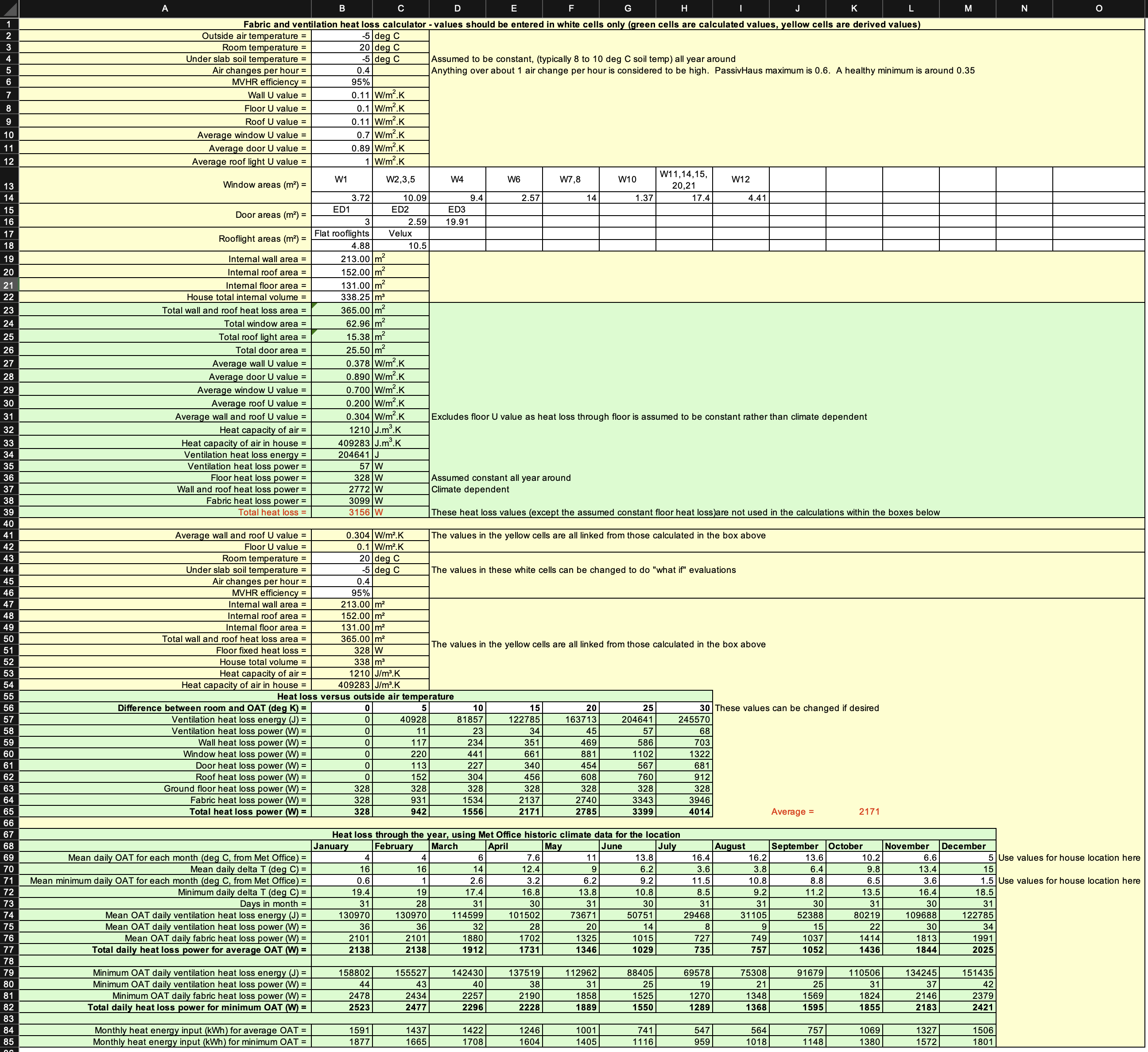

@JohnMo I've just been revisiting my earlier posts on this thread. I'm so pleased I wasn't rushed into making a poor decision earlier and have revisited this after going through some detail about our UFH design - I'm re-visiting this thread because none (literally none) of the UFH suppliers asked for any details about heat loss in working out their proposed design, and I realise better now exactly why I need to start from a solid foundation of properly understanding our heat loss, the resultant ASHP and then looking for the right emitter sizing/specification.
I've now re-read this thread and although I'm close, I'm not entirely there in understanding the modulation (your earlier reply was really helpful in prompting me to pause and start to question this more, but alas I am being slow and could do with it spelling out, if you or someone else is willing to?). I've so little confidence in what I've been provided by the companies (the slightest question to them ends up with them going very silent and figuratively 'pointing' at the results that their over-simplified tool has output; they just want the sale and to move on).
So, having read and re-read this thread (not just my questions), I'm of the view that our insulation will be good enough that the down-time required to heat the Domestic Hot Water Tank (looking to get a 250L / 300L one), doesn't really require us to size-up the ASHP noticeably (@jack's earlier reply about the ASHP heating the DHW for a few hours in a day could be almost imperceptible - I think this could apply to our build).
I'm currently looking to improve the quality of the floor insulation, and so have re-run the heat loss calculator sheet (2 screenshots - close-up in the text and the whole version is attached). image.thumb.png.43ec85df3e517c171f4d8afcf9a65647.png
Summary questions:
1. Going over this calculator, I've just realised that I need to confirm an entry - the internal floor area I have input is for both floors, rather than just the ground floor - should this not actually be just the ground floor? as the intermediate floor won't contribute to heat loss as it is within the warm envelope? (I had populated it as the 'default' approach when asked for house size as being the area of all floors).
2. @JohnMo (or others), would you mind explaining ASHP modulation and what I should be looking for in the spec sheets of a heat pump, and how does this translate to what suppliers/manufacturers state as being a '6kw ASHP' (is this in the middle of the modulation range, or the peak performance of the HP?
3. Should the Heat Loss calculator value for 'Floor Area' be just the ground floor, or combined floor areas? (if just the ground floor, the summary table comes out as follows):
4. We plan to only install UFH (wet) downstairs, with upstairs having electric mats in the bathrooms. All the UFH suppliers have stated that we won't achieve BR spec with UFH downstairs only and we'll need at least some emitters in the bedrooms. I'm inclined to prefer the option of specifying some limited electric UFH mats in the bedrooms which could be simply left turned off, but provide a backup in case we've miscalculated and find that the rooms do need some extra heat (I'd really rather get the calculations right though, with this group's help if possible?). I know some of you will have encountered something like this - what are your views? If challenged by building control, how do I rebuff their request for us to demonstrate compliance (as suggested by the UFH suppliers)?
This post has become much(!) longer than I set out to write. Thanks for getting to the end and I hope some of you are able to comment / advise.

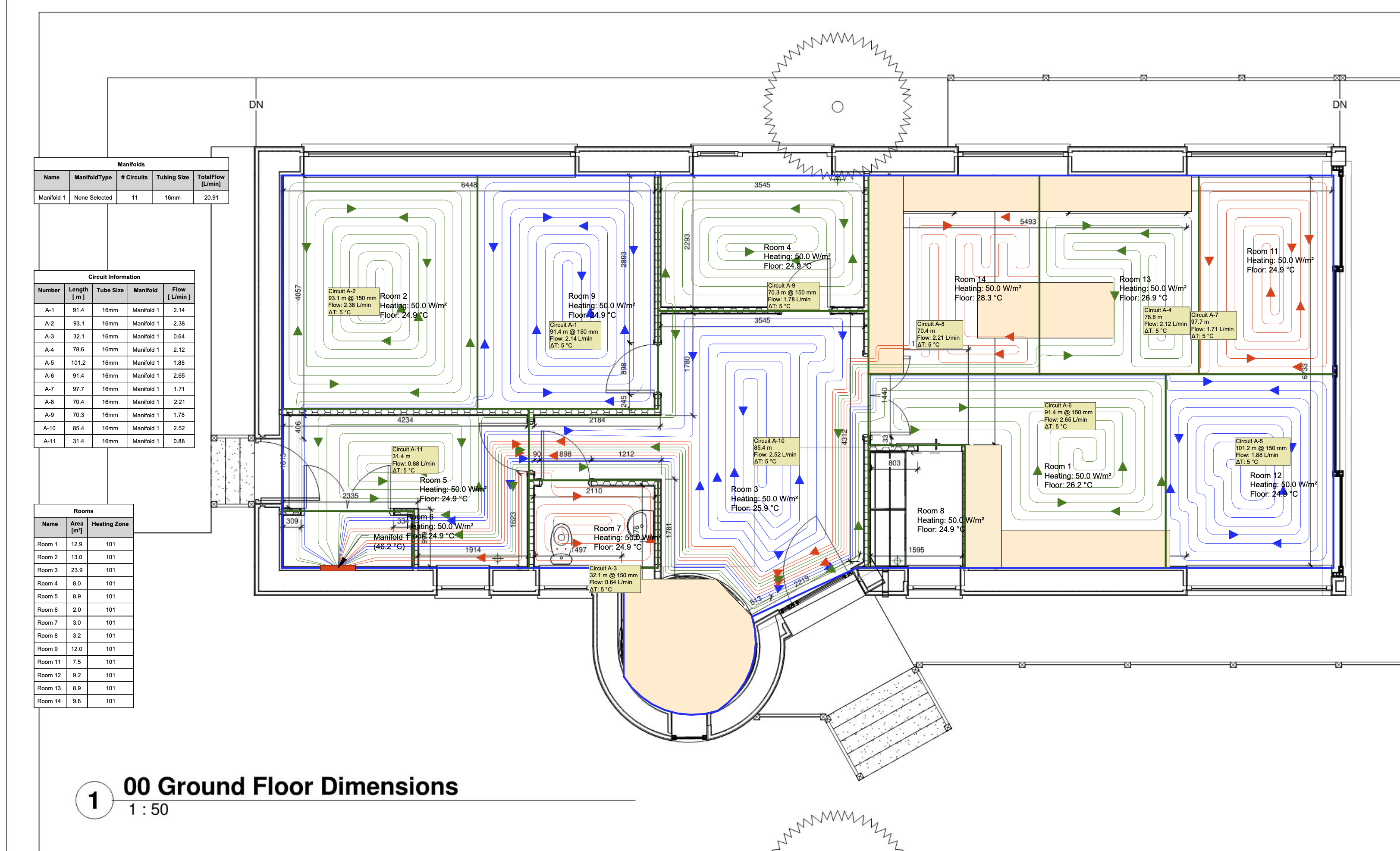

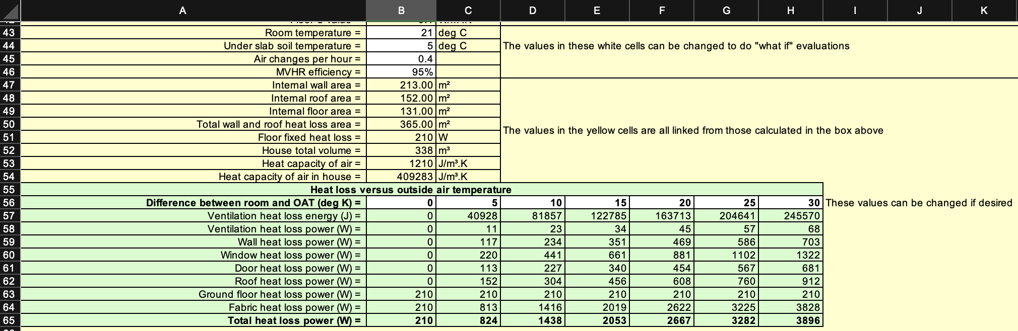

So, I was thinking that the UFH quote I had for UFH stating 50w/m2 was well out, especially as it had the UFH running at 46 degrees(!), but the following numbers would appear to come out at 50w/m2 if we want the ground floor UFH to meet the whole-house heating load. It just 'feels' high to me based on the thermal performance figures etc. Could someone have a look and see what I'm missing, or if we do indeed need 50w/m2 but at a lower temp?
I've revised the figures in my calculator as follows:
  • Target room temp of 20 degrees
  • Under-slab temp to match the OAT of -5 deg (our house is on a frame supported above ground and so beneath the beam & block floor it is OAT)
This gives the total heat loss (row 39) as 3156W
...equating to 3156W / 131m2 = 24W/m2 (single floor, therefore 48W/m2 to meet whole-house load)
How would the UFH firm get to 46deg as the running temp? (they didn't ask me for heat loss or thermal property values); but more importantly, how do I calculate what temp I need to run it at?
However in the second section of the calculator, row 65 averages as 2172W total heat loss (2171 / 131 =16.5W/m2 or 33W/m2 for whole house heat requirement)
(for clarification, the UFH plan - based on feedback here actually - is for a single zone across the whole of the ground floor. Expecting to use 16mm pipe at 150mm spacing in a spiral pattern)
And so in summary:
  1. What figures should I be taking from this to establish the size of ASHP? (noting @JohnMo's answer above about needing to scrutinise the manufacturer's spec sheets to make sure I'm comparing like-with-like)
  2. What should the lower and upper modulation / performance values be for it to be able to keep running and be at or close to its optimum CoP? (the more I read, the more I am hell-bent on not over-sizing)
Many thanks! 🤞

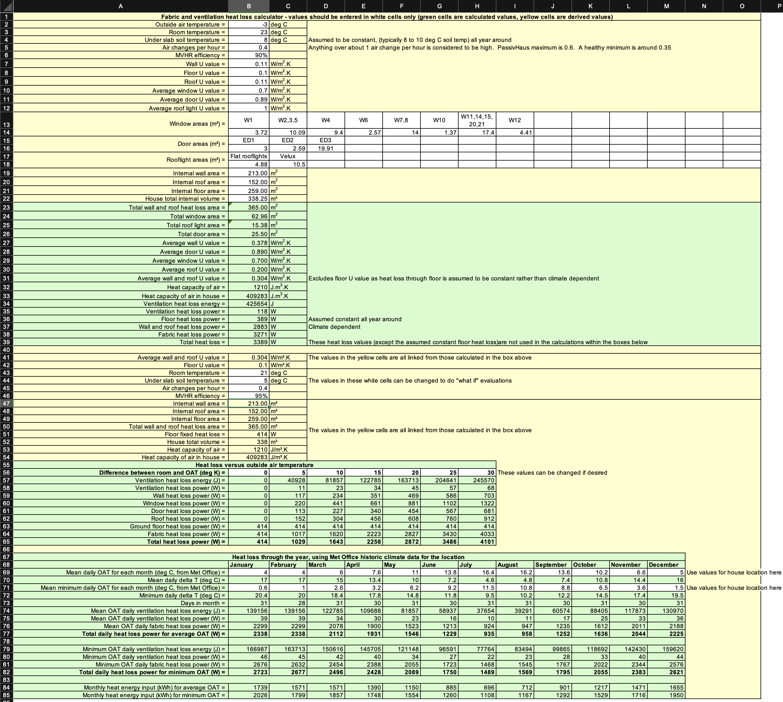

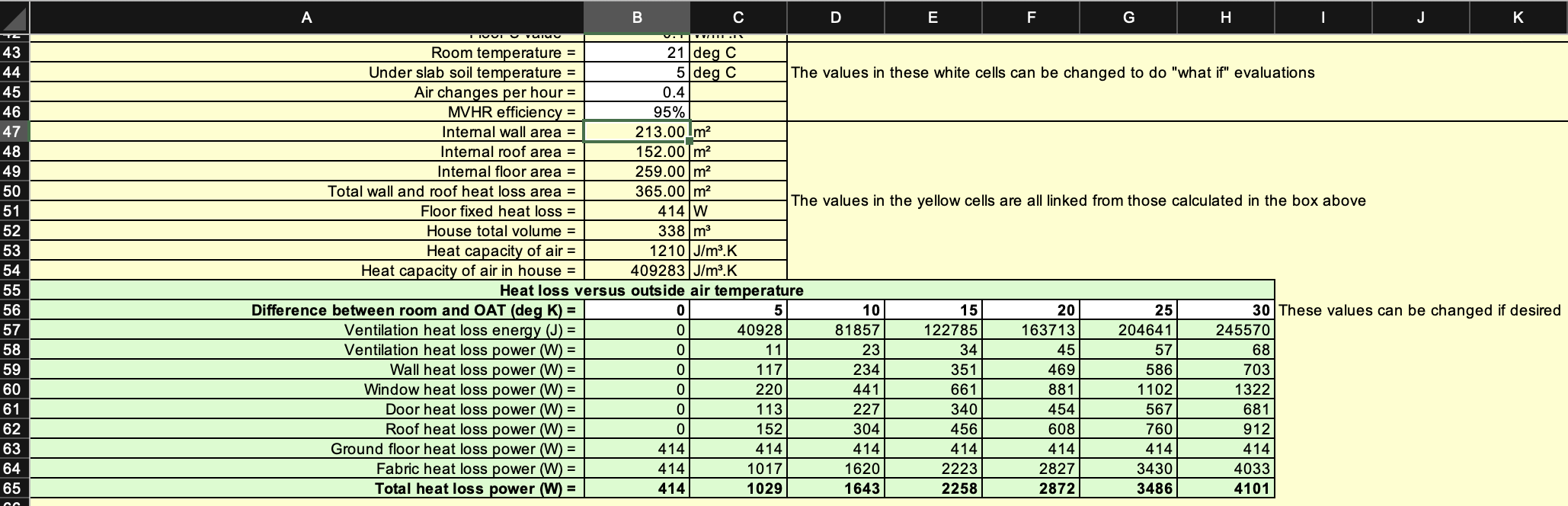

Not quite.your single floor area is 131m², your actual house floor area is 262m². If you had heat on both floor the floor output would be 3156/262. If you are only heating via one floor your floor output needs to 3156/131. So you stop at the 24W/m².
In theory there was no need so I wasn’t going to put any heat emitters in the bedrooms but decided to err on the side of caution and had (not oversized) radiators installed. Wet towel rails in bathrooms as well. Partly it was to satisfy the installer’s MCS calculators, partly to avoid domestic complaints! Glad I did because we do feel the need during cold snaps.
You need a heat pump, does around 3.5kW at -3, but that will also run happily at 10 degs at just above 1kW at around 25 Deg flow temp.

@Great_scot_selfbuild @timhowes I too was nervous of my own calculations using the spreadsheet. It came out around 8.8kW.
I then sanity checked and used the free and brilliant tool from Heatpunk that calculated 9.1kW.
our MCS installer calculated 12.1kW and was nervous about suggesting a 12kW and was suggesting a 16kW (the range i am looking at is only available in 9,12 and 16. He was using the standard MCS spreadsheet which can overestimate and he had some slightly incorrect u values which was my fault.
I then worried even more and so decided to get a heat loss done that was independent and mcs compliant for the installer. This cost £300 and it came out at 9.15kW using heat-engineer and he even modelled it in spruce and it came out at 9.36kW.
Moral of the story is Jeremy’s calculator is good - but not foolproof and took me a couple tries to get right. Heatpunk is free, very easy to use and almost foolproof. Would Absolutely
