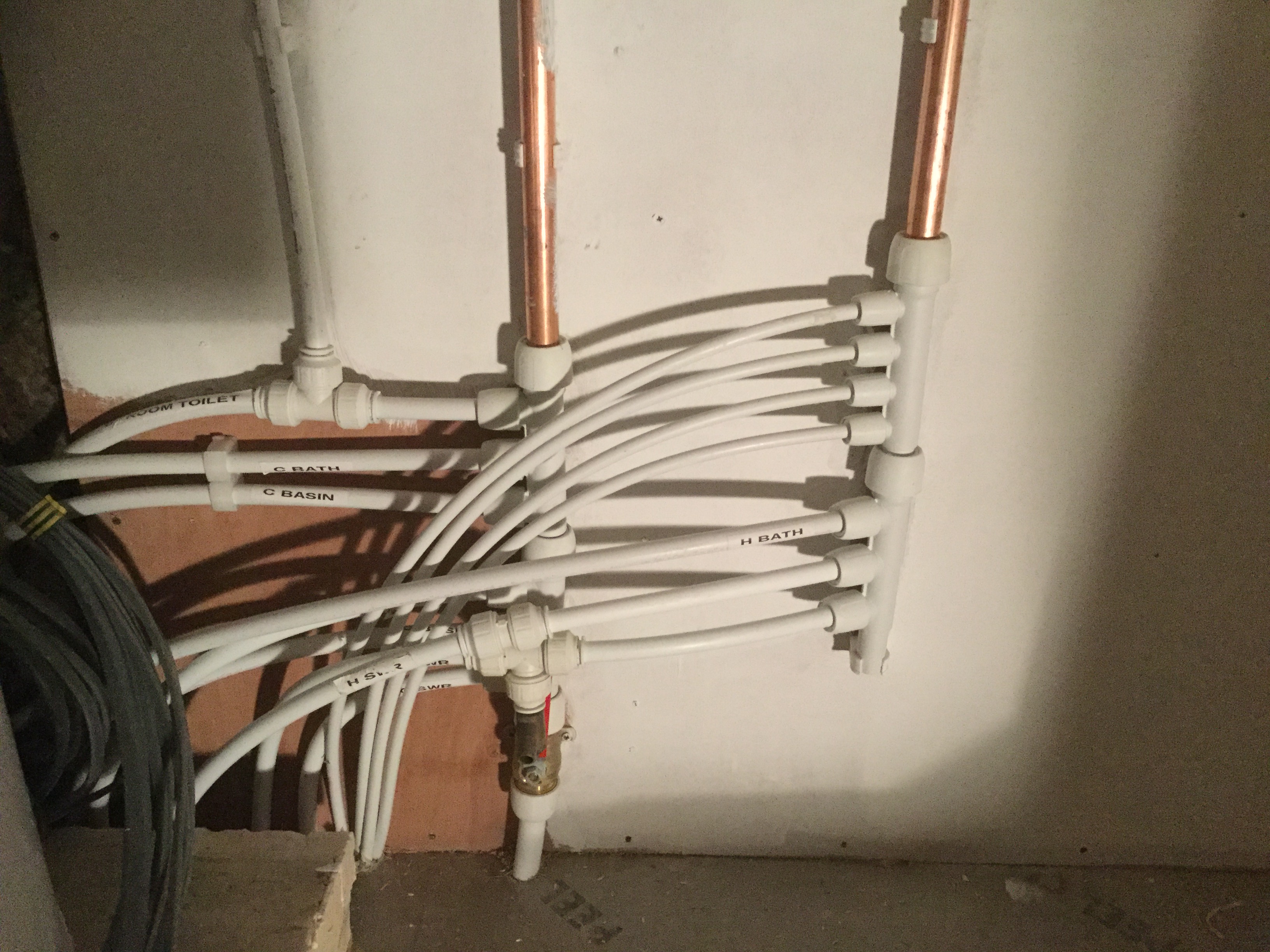

jamiehamy Posted December 11, 2017 Share Posted December 11, 2017 2 hours ago, Nickfromwales said: Do it where it can be seen / accessed but that's a good place to keep the soldered stuff imo. Good to convert to copper where it's exposed as pushfit is bloody ugly stuff to have on show, even in cupboards etc. Hmm, I think the opposite is true! I think HEP stuff nicely laid out looks miles better than aged copper - is is @PeterW who has the manifold connected with plastic? I tink it looks cracking - copper looks old fashioned and is nearly always discoloured (since we're talking about looks only!). @recoveringacademic a decent bench clamp and/or set of helping hands are worth their weight in gold - especially if making up sections - avoids weird contortions trying to hold bits together and solder and not get burned....! I would most certainly recommend plastic, but if going copper, would also recommend soldering rather than compression - it's a nightmare in comparison! Link to comment Share on other sites More sharing options...

Nickfromwales Posted December 11, 2017 Share Posted December 11, 2017 57 minutes ago, jamiehamy said: Hmm, I think the opposite is true! I think HEP stuff nicely laid out looks miles better than aged copper - is is @PeterW who has the manifold connected with plastic? I tink it looks cracking - copper looks old fashioned and is nearly always discoloured (since we're talking about looks only!). @recoveringacademic a decent bench clamp and/or set of helping hands are worth their weight in gold - especially if making up sections - avoids weird contortions trying to hold bits together and solder and not get burned....! I would most certainly recommend plastic, but if going copper, would also recommend soldering rather than compression - it's a nightmare in comparison! I think it's @PeterStarck that has the uber nice looking plastic manifolds, one where I have to concede the point as it does look pretty damn good ? Link to comment Share on other sites More sharing options...
joe90 Posted December 11, 2017 Share Posted December 11, 2017 (edited) I have just finished my pipework and gone hep, no joints except manifolds and end fittings so no potential to leak in hidden spaces or restricted flow round tight 90’ bends. ( yes there are a few non hep,s but these are going to be replaced as soon as I get replacements). Edited December 11, 2017 by joe90 2 Link to comment Share on other sites More sharing options...
