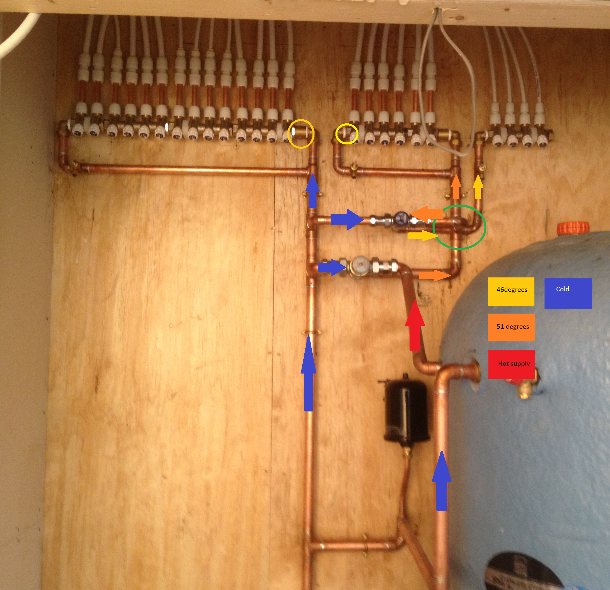

jamiehamy Posted February 20, 2017 Author Share Posted February 20, 2017 Hiya, Me again...! So starting to dry assemble my manifolds - will do some practice solders tomorrow. I've got a couple of questions on @Nickfromwales's epic picture. Have I gotten the flows right here - the hot flows into the first TMV (with the cold), and the output from that splits into two, feeding the second TMV to bring the temperature into the third manifold down further? I can't quite see the detail in the green circled area so not 100%. Are the TMVs fitted with a non return valve to stop the hot flowing down the cold supply manifold? Also, what has been used to connect the manifolds? I've gotten 22mm-3/4" female elbows into the manifold male ends, which have a rubber seal - presumably this is fine with no tape or anything else? For the other side, where the manifold has the female end, does the male elbow go on with tape, or is there something better? It doesn't tighten up at the right angle, so it slightly loose without tape just now. Link to comment Share on other sites More sharing options...
TerryE Posted February 20, 2017 Share Posted February 20, 2017 (edited) @jamiehamy IIRC, 51°C exceeds Bregs. The TMVs aren't fitted with NRVs. But you won't get back flow through a TMV. (Have a read of my latest blog post). Use an O ring or washer. Where I disagree with Nick's approach here (did I just blaspheme, BTW) is the lack of a compression straight on his CW riser. I break all of my copper work into separate sub-assemblies that I can make up on the bench and isolate for pressure testing before putting them into position. e.g. using an end stop instead of the TMV output. I also had my draincocks on tails so these tails can double as the fill points for pressure testing before final assembly. Doing this has three major advantages: No hot soldering in a confined cupboard in a timber framed building. You can test each sub-assembly on the bench (or the floor) before you put it in position. Unless you are Nick, you will find leaks and need to rework. You can flush out any residual flux and crap from the sub-assembly before you put it into position. Edited February 21, 2017 by TerryE Nick's got leeks; I had the leaks Link to comment Share on other sites More sharing options...

Nickfromwales Posted February 21, 2017 Share Posted February 21, 2017 11 hours ago, TerryE said: Where I disagree with Nick's approach here (did I just blaspheme, BTW) is the lack of a compression straight on his CW riser. I break all of my copper work into separate sub-assemblies that I can make up on the bench and isolate for pressure testing before putting them into position. That's the joy of having time on your hands . For me, working on price, things get fitted once. That plywood was all in before soldering, so with the correct blow lamp and a burn mat there's no reason to risk property or roast the surrounding material. ( And, the whole arrangement can be removed with a screwdriver and a spanner, as just out of shot is the isolation / bypass arrangement for the softener, complete with compression fitting. ). @jamiehamy The arrangement is exactly how you described it. The only thing I'd change if I had that job again ( that was my fist true PH installation btw ) would be to feed the secondary TMV straight off the TS. The reason for that would be less dead water to get rid of before getting hot flow to the basin manifold ( furthest right ) plus it would convection pre-heat so would always stay warm / hot. The next one will be perfect. The one after that even better. And the one after that even more betterer. Continue above reasoning until death. ?? Link to comment Share on other sites More sharing options...

jamiehamy Posted February 21, 2017 Author Share Posted February 21, 2017 Thanks gents. I've made a start, got a dry pressure tester, just need to dig out my bicycle pump! I've soldered the manifold sub assemblies - where the cold manifold supply bridges over to the middle manifold (where the mouse is) , I'll be putting a compression Tee to make it easier to join. I've just used 22mm to all the manifolds - the left most is the hotter supply for showers and bath, the middle for basins at a lower temp and right most cold feeds. All supplies are heading through the floor space as the plant room is upstairs. The red arrow will be roughly the level of the UVC outlet with min 500mm distance. 4 Link to comment Share on other sites More sharing options...
