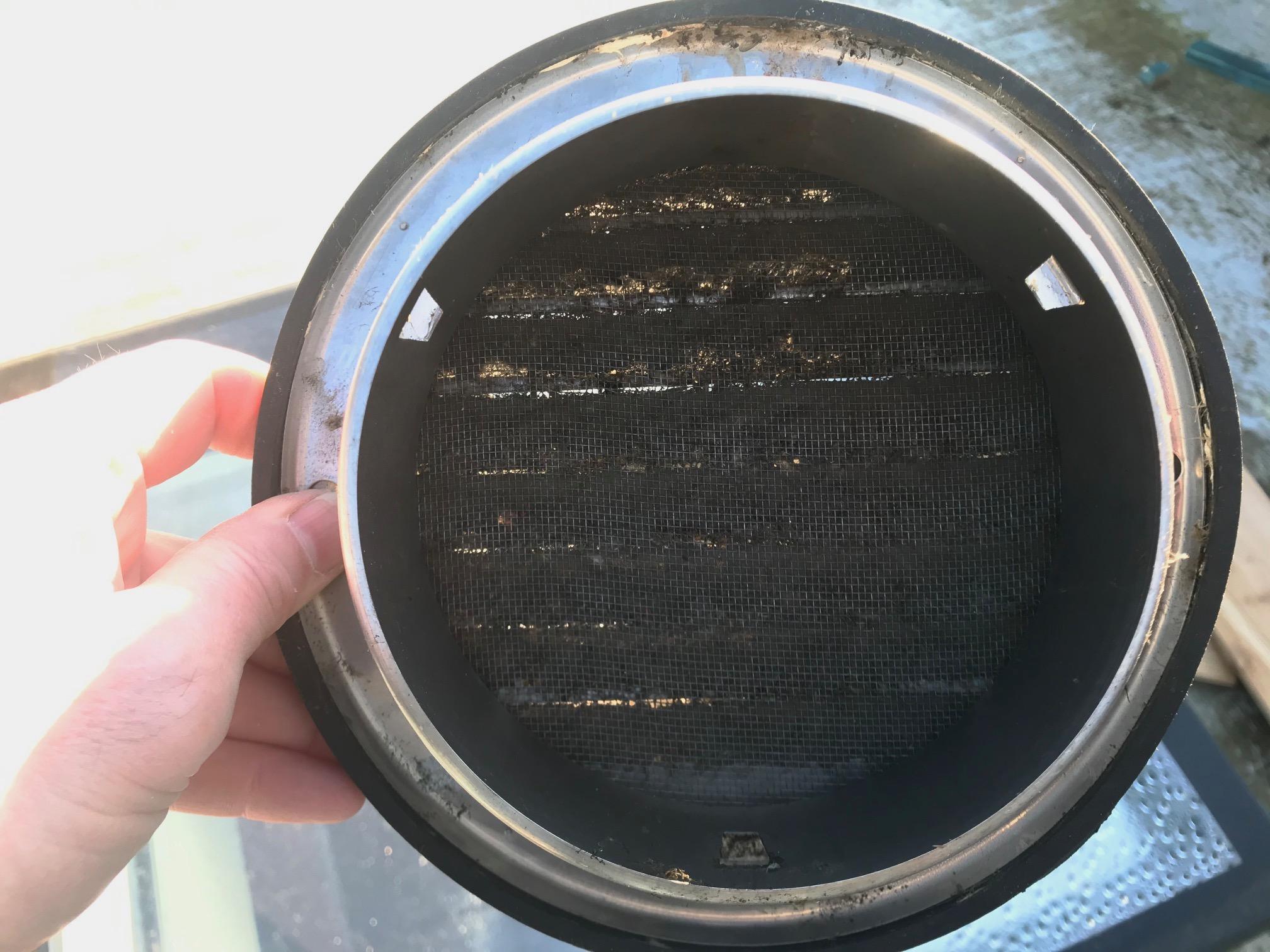

PeterW Posted February 6, 2021 Posted February 6, 2021 Just now, Adsibob said: I’m in the process of designing my MVHR layout and this is definitely something I want to avoid. What are the recommendations for siting inlet and exhaust? How far apart should they be and can they both be in the same side/orientation of the house? @readiescards, did you ever solve this? To ensure they aren’t off balance they need to be on the same wall. Try and get a minimum 1200 horizontal distance between them and vertical separation if possible. Also make sure they are accessible (or don’t have fine mesh on the intake) as you will need to access them to clean them otherwise.
Nestor Posted February 6, 2021 Posted February 6, 2021 (edited) 11 minutes ago, PeterW said: Also make sure they are accessible (or don’t have fine mesh on the intake) as you will need to access them to clean them otherwise. Supply and extract on same external wall. 2.5m apart, extract 1.5m higher. Never had any cross contamination. Fine mesh supply clogged after 9 months. Edited February 6, 2021 by JamesP
