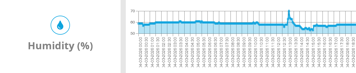

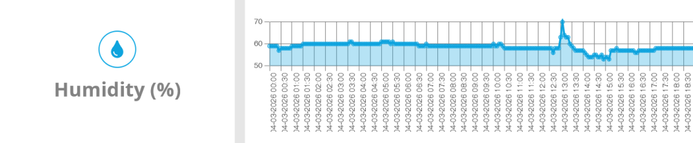

March 18Mar 18 My faulty Brink Flair unit has now been returned, and I bought and installed a DucoBox Energy Comfort 325. All of the problems I attributed to the Flair have now gone away. This is as good a like-for-like test as you're going to get, everything is the same - same house, same ducting, same vents, only the main unit has changed. Just for completeness, I want to mention two additional (objective, measurable) tests I did on the Brink Flair in the last days we had it, using a CO2 and humidity monitor. Why didn't I think of this earlier!! I placed the monitor inside one of the supply vents, luckily we have two through-wall vents which are perfect for this (https://www.ventilationland.co.uk/en_GB/p/uniflexplus-wall-manifold-rear-connection-1x-o90-mm/9744/) so the whole monitor can sit in the incoming airflow. We then left it for a few minutes so the values could settle down and we could get a general background reading: the RH was about 55% and the CO2 was about 450ppm. First test was a humidity test: I boiled a kettle in the kitchen and let the steam be sucked into the extract valve. The RH jumped to 70%, then went back down again. I also showered, and again the RH shot up to 70% (see attached graph). Second test was a CO2 test: I disconnected the flexible noise dampener which is connected to the Flair's extract port, and breathed into it several times. The CO2 reading at the supply vent briefly increased, from about 450 to 485, then went down again. I tried this again with my partner, and the CO2 reading went up to about 540 PPM. (This one is difficult to show on the graph though, as the unit only logs every five minutes, so the brief peak isn't logged. It's difficult to keep breathing into the extract!) This can only be because there was a leak inside the unit. This does echo the results of my smell test, but is more objective and can't be written off as me having some sort of super-nose! I consider that to be proof that the Flair was faulty, despite Brink's inistence that it wasn't. The new Duco works as expected. I've done the same tests, and showering makes no difference at all to the moisture levels of the incoming air. It's been in for over a week now, and the RH in the house hovers around 44 to 54%. Even while boiling a big pan of potatoes there's no moisture on the kitchen window, whereas with the Flair it would be dripping wet. With the Brink Flair the humidity in the house was always high. The 55% mentioned above was only acheived because we had left the above-window vents open, and aired the house out every day by opening the windows for several minutes. Until we started doing that it was always above 60% and would jump to over 70% when cooking/showering. I must say I'm really disappointed with Brink. They showed little interest in the problem, I had to nag them constantly, and were almost totally unresponsive, and it seems they closed my 'case' several times. If I hadn't kept the pressure up they would never have responded. Which is a shame, as I really liked their products otherwise. Edited March 18Mar 18 by Jolo Made link into an actual link
