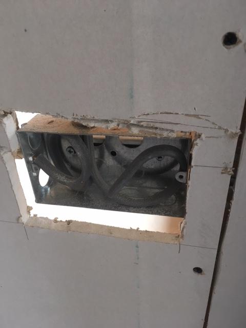

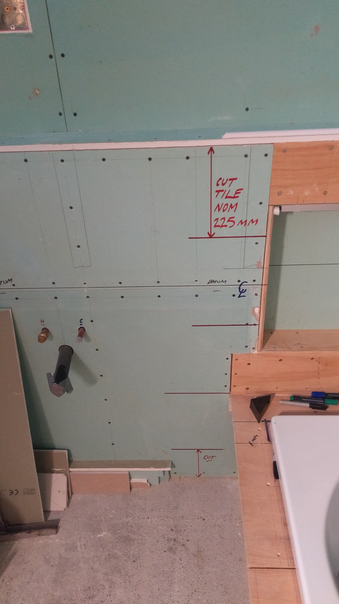

Plasterboarding is underway (boarders do skim too so all one contractor). We are using regular stuff on the ceilings but Gyproc Habiito on the walls.
My chippe and sparky pointed out to me what they considered to be poor workmanship on the boarding. My project manager just says he looks at a finished job not a part done one. He mentioned holes to plasterers who said they would be taped and we would never know but I am worried we have huge holes around sockets, I can put my hand in one, some of the mvhr outlets have been cut far too big and the pipes taped on a skew....I can see into the roof void and the membrane holes are so big. Boards in corners have been damaged when put up and holes taped over.
We know nothing about plasterboarding other than having had work done in our previous house it was a much better standard. Should I ask them to re do problem areas before they get to skimming.......and one more thing would you expect a large ceiling to be skimmed in one go or in sections.
Some pics attached.
Thanks for any help.
Liz

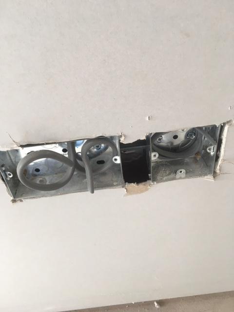

Gaps around boxes are a no-no.  The boxes should be tight to the plasterboard, or ideally project into it slightly, so there is no gap.  We packed all ours out so they projected a few mm into the plasterboard layer, to both make sure there were no gaps and to make it easier to mark the box cut outs on the boards (just put the board in place and bang it over the box, and it leaves an imprint for the cut out)
The workmanship looks bloody awful, and I think there is a strong probability that you will get cracks in all those areas with big voids.
Posted
Sorry but that is as rough as can be. I would be marching them off the job if they are not going to re do the rubbish bits.
If they just skim that, round the sockets the plaster spanning mid air will just break off when the sparky screws a socket home.

Fack me....Edward Scissorhands would have cut those out neater :S
Show them the door. Rebook the tiler and take the hit. These issues will come back time again with cracks and cave ins. Have you checked how many PB screws have not been driven fully home? Eg not proud so you can feel them but not torn through the PB surface paper ? 'Heads popping' will last years. :(. My current customers house looks like someone shot the ceilings with a tommy gun.

Just had another look at your post on my laptop I can clearly see what has happened
they have not used Habito boards before Judging by the score marks
They have tried to cut the sockets out with a knife or serated knife
fine for any other plasterboards
Nor Habito
Jigsaw only for cut outs
As Nick has pointed out the screws arnt counter sunk
They may be using standard drywall screws
Not the Habito screws

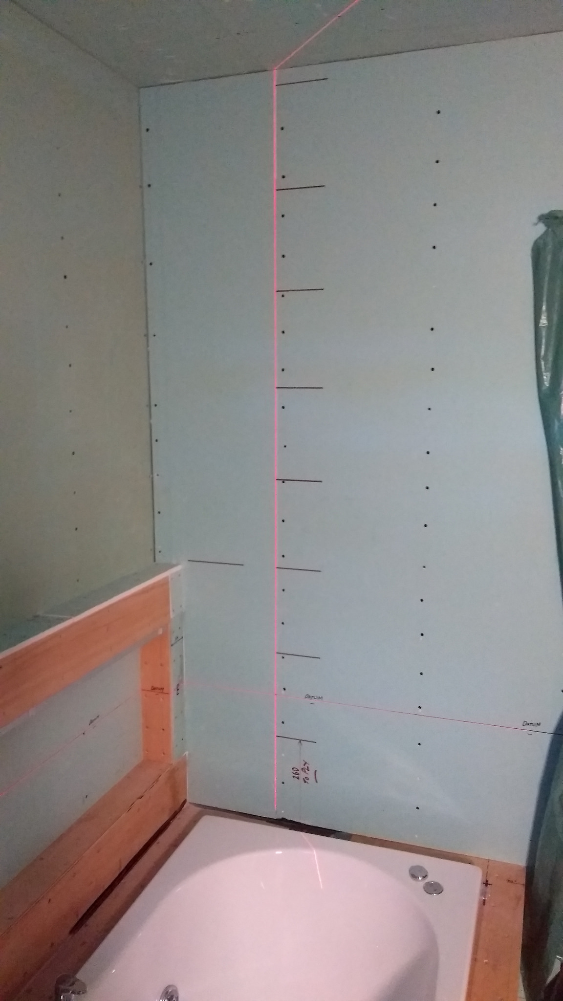

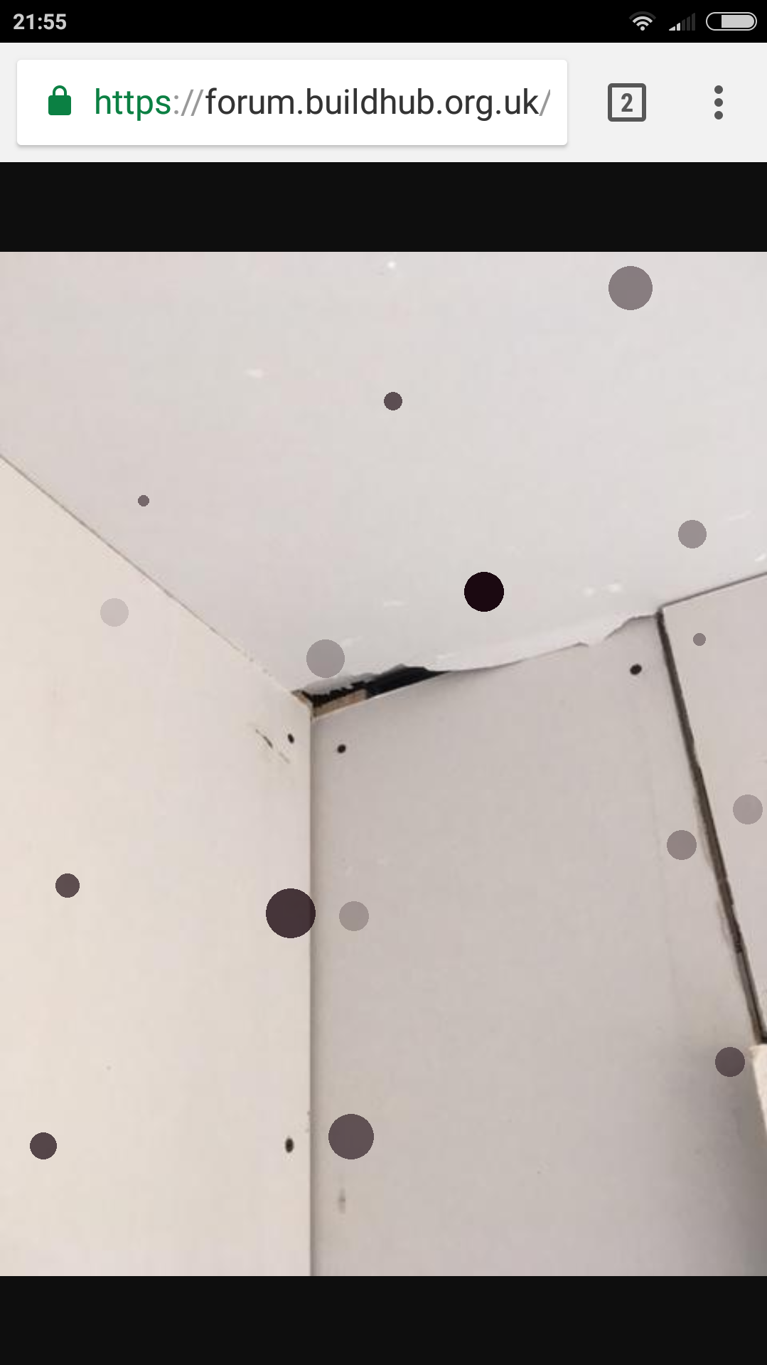

Apart from what has already been said there looks to be a shortage of screws in them boards esp the pic showing the corner and the roof. Hard to tell if the white marks on the ceiling are screw holes filled over. You should have a screw every 300mm along a stud or joist.
Should look more like this

First thing is ask to see the fixings box or the invoice - Habito screws have a different part number and a different head design. Check here
http://www.british-gypsum.com/products/high-performance-screws-for-use-with-gyproc-habito?tab0=1
If the screws are wrong, get them removed and the boards replaced - scrim and splash isn’t a replacement for proper boarding.
Secondly, bin the board team ... that’s not acceptable workmanship and they need to go.
Thirdly... take your PM somewhere quiet and explain the facts of life, and how you’re paying his mortgage and he works for you - shortly before asking if he’d like to leave at the same time as the boarders ... anyone can pick a trade from google ..!! He needs a wake up call ...

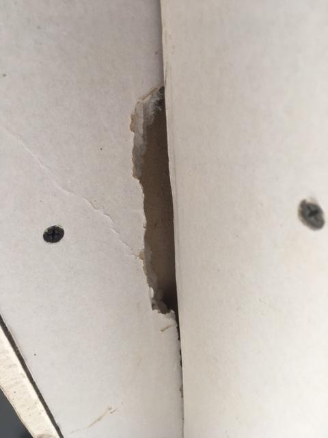

I just cut a hole in a plasterboard wall to find out what is behind it and it is narrower than the vertical gap between the two sheets in the corner picture. They don't look flush either?

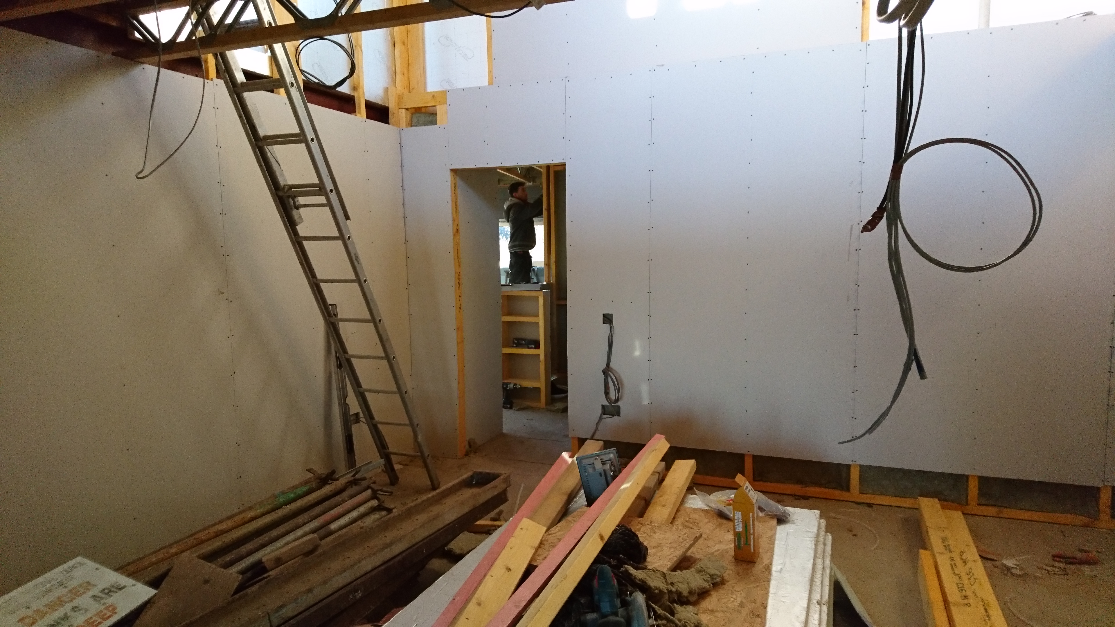

That's awful - and agree on lack of screws, although our plasterer had a good chuckle at how many we put in - says 'o fooking chance that'll move' when skimming.
You can see how many screws we put in here.
Posted
I'm a mere DIY'er but ffs have some pride! If in doubt put more in. Tbh I think I went 200mm ctrs then took on board @Nickfromwales comments and have been doubling up:
