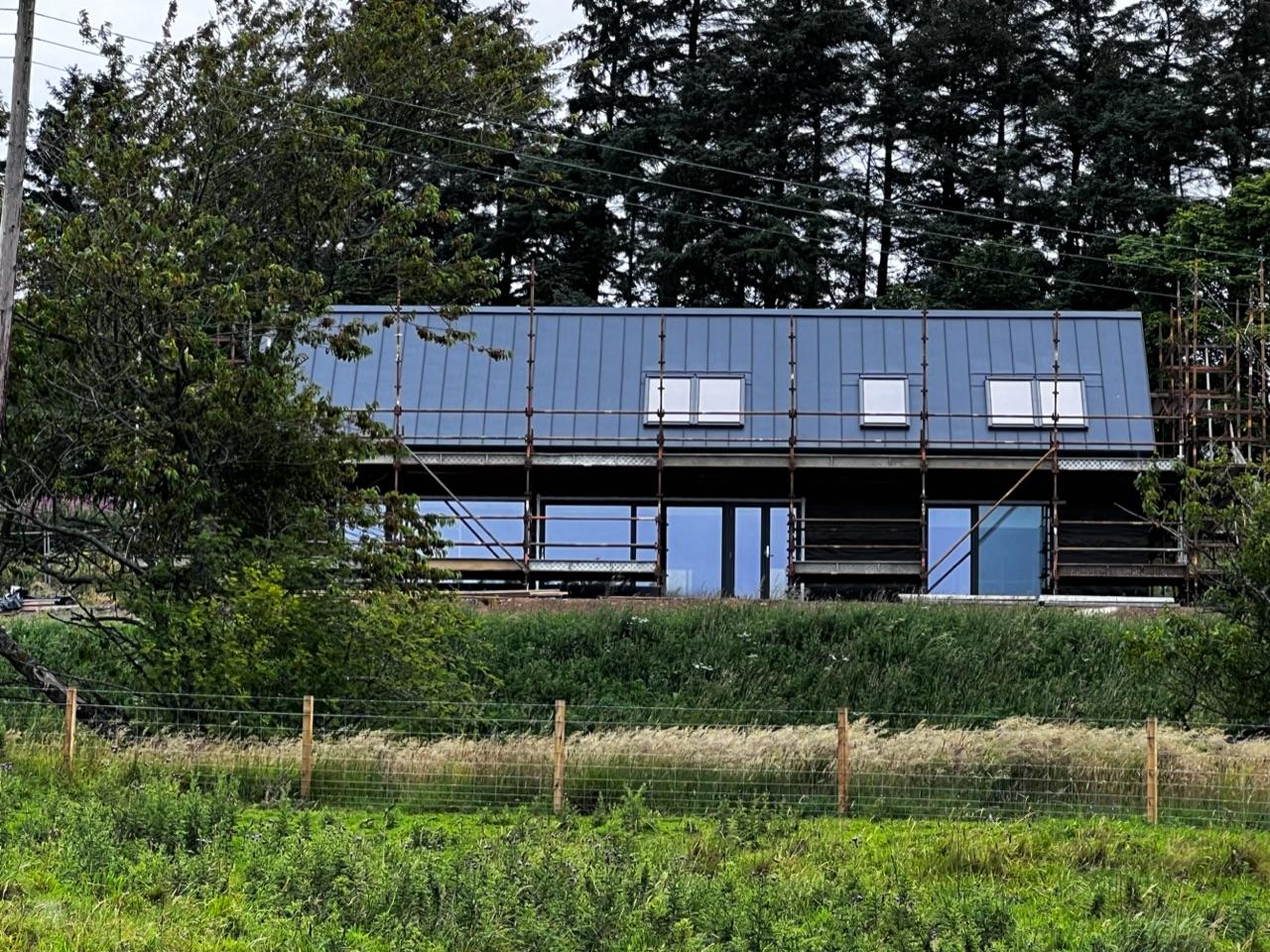

Kelvin Posted July 17, 2023 Share Posted July 17, 2023 Our ongoing replacement glazing unit continues. First it got broken, then the replacement was 2G instead of 3G then the replacement of the replacement has a slightly different tint to the rest of the windows. They had this IGU made in the UK rather than Europe. They said it would be an exact match where it clearly isn’t. Would you accept this? Link to comment Share on other sites More sharing options...

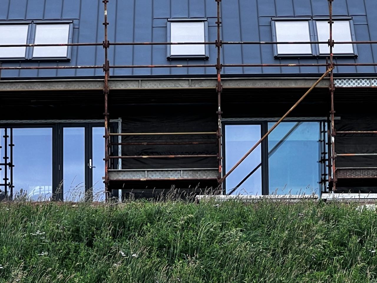

Kelvin Posted July 17, 2023 Author Share Posted July 17, 2023 (edited) We have one person that can’t see it and another saying it looks terrible. It looks terrible to me too. These are Low E 3G units. The one on the far right has a greenish tint and the rest have a blueish tint. It’s pretty obvious to my eyes and much more obvious to the naked eye. You can only really see the difference when you look at it straight on and from a distance. Close up it looks more or less the same. Due to where it is on this elevation you can’t really see it from the 3/4 view looking from the East which is how we’d generally view it. To the west is the neighbour’s garden. Ironically when we drove up to the plot the other night we commented on how much we liked that blueish tint on the windows Edited July 17, 2023 by Kelvin Link to comment Share on other sites More sharing options...

Vijay Posted July 18, 2023 Share Posted July 18, 2023 the lower right looks very different to me? Link to comment Share on other sites More sharing options...

Kelvin Posted July 18, 2023 Author Share Posted July 18, 2023 No not paid for it. Everyone I’ve asked can spot it with the naked eye. We’ve had to compromise on so many things that can’t be fixed that when it comes to something that can be I don’t think we should. Having slept on it I’ve decided I want it replaced. 1 Link to comment Share on other sites More sharing options...

Gone West Posted July 18, 2023 Share Posted July 18, 2023 11 hours ago, Kelvin said: Would you accept this? Short answer is no. The difference is far too obvious. Link to comment Share on other sites More sharing options...
saveasteading Posted July 18, 2023 Share Posted July 18, 2023 Any two production runs are very likely to be different colours, all within tolerances. Or perhaps that unit is at a slight angle and reflecting differently. I have had issues with windows , metal cladding and industrial doors, floor coverings, paving slabs, that nobody else noticed ( or cared about) until i pointed it out. So to some extent relax, it may only be you. It is difficult to impossible to overcome this by changing units again. There are visual tricks, mostly distraction, so that nobody else notices this. But i fear that you will not be able to unsee it....perhaps with time and other things to think about. 12 hours ago, Kelvin said: Would you accept this? Yes. I'd kick up an overstared stink, prtendinb j didnt know what jve jusg said, then accept a discount. On balance, arent the windows gorgeous? Especially inside. Link to comment Share on other sites More sharing options...

Kelvin Posted July 18, 2023 Author Share Posted July 18, 2023 52 minutes ago, Dunc said: Does it look any different from the inside looking out, and is it in the same room as another different tint pane? How often would you look at the house from the outside and be able to see both sets of glass? Internally it’s fine. Every time we drive up the road to the house. The way the light hits these windows highlights the tint and therefore the difference. It’s less noticeable because there’s a tree in the field that partially obscures the view. Link to comment Share on other sites More sharing options...

craig Posted July 18, 2023 Share Posted July 18, 2023 Clearly this window and it is a different coating that has been used. 1 Link to comment Share on other sites More sharing options...
Temp Posted July 18, 2023 Share Posted July 18, 2023 15 hours ago, TonyT said: Can’t see anything different. Ground floor far right hand window. Link to comment Share on other sites More sharing options...
