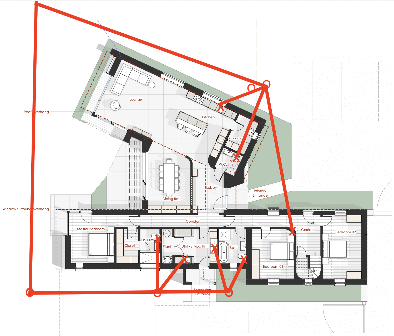

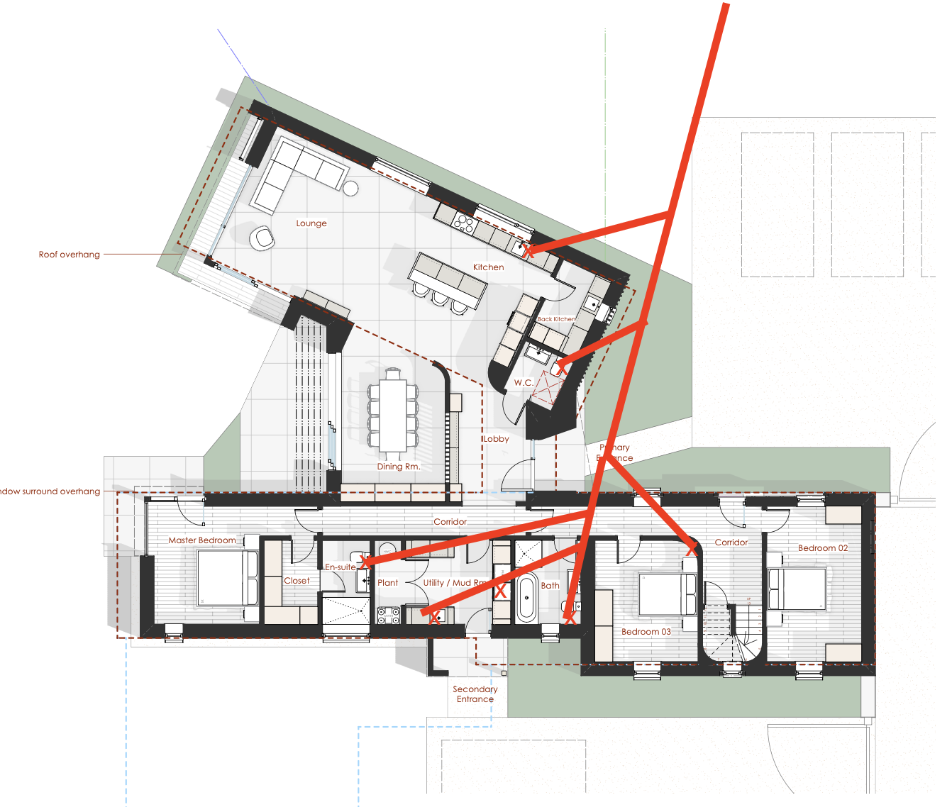

I’ve found this guidance, https://info.labcwarranty.co.uk/hubfs/Technical downloads/LABCW Y-junctions under buildings.pdf So this means the top option should be achievable as long as I include access/ rodding points. The treatment plant will be as close to the building as permits. It has to be on that north side due to land ownership/ a 200mm water main elsewhere
Noted, I’ll redraw. The site is sloping, but not that much and the fall slipped the ‘design’ Treatment plant will be to the north/top of these drawings. Thank you
Hi all, In the wait for planning and before wanting to commit to professional input for building regs drawings, I’m just starting to plan services etc around the house. The current thing I’m trying to work out is the runs for the soil pipes. These will eventually head out to a treatment plant (to be specced). Out of the two designs below, which would be preferable? One option minimises runs under the (insulated raft) slab and has multiple inspection chambers to pick everything up, the second utilises 45 deg branches. One option allows rodding access from both ends; the branch option only allows rodding from one end. This will need toilet, etc., removing to access? Any thoughts on which is best? I can’t seem to find any guidance about minimising runs under the slab but common sense says less is more. Let me know if there are any suggestions, and I'll resketch! Thank you all Thank you all

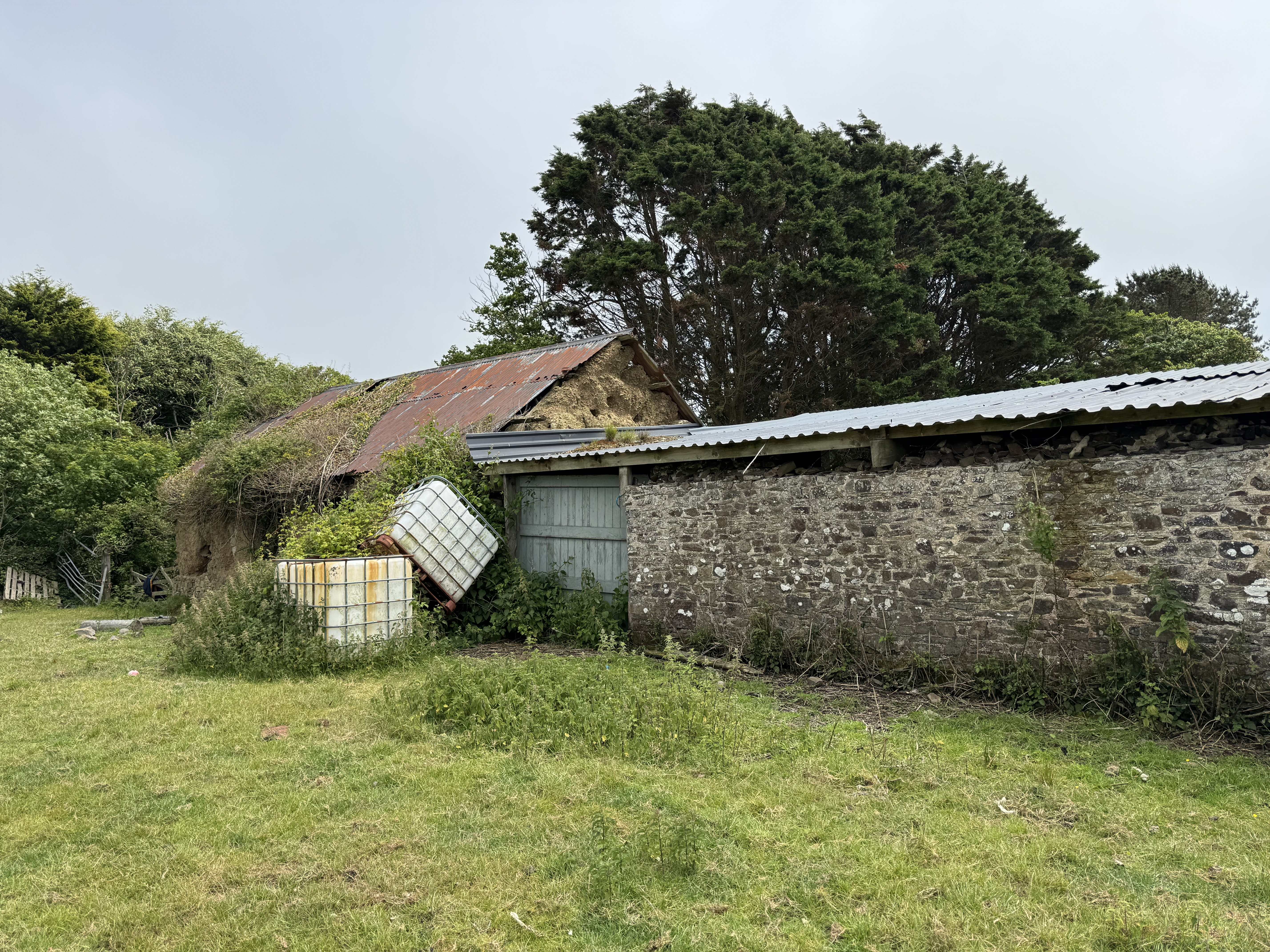

Thank you all! We are lucky to have some upright trees around us! Whilst in principle I would love to retain as much as possible, realistically there is a fair amount that needs attention. See examples below.
That's the good bit! Depending on planning, it may be a full rebuild, and ultimately that would be the simplest way🤞

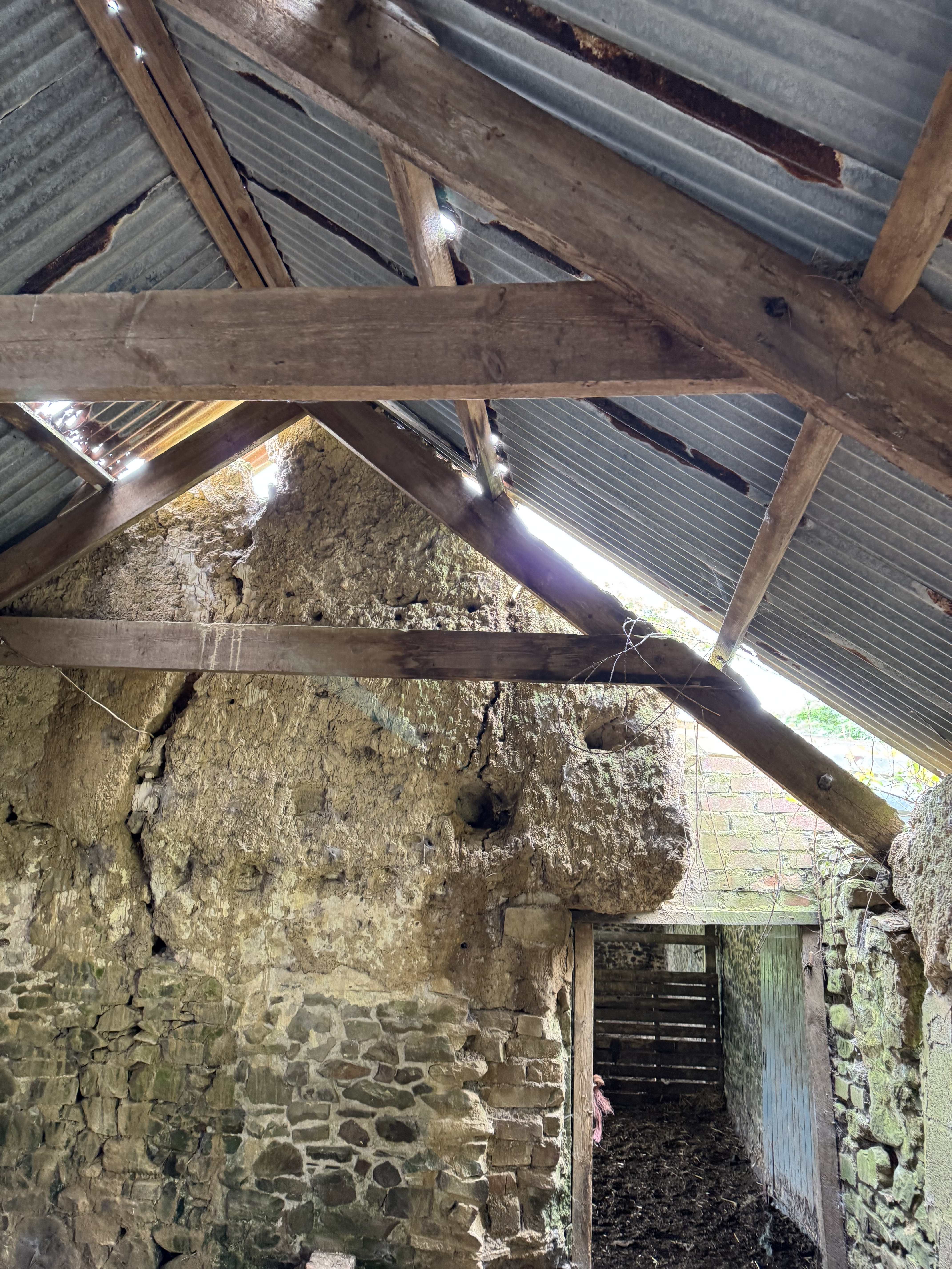

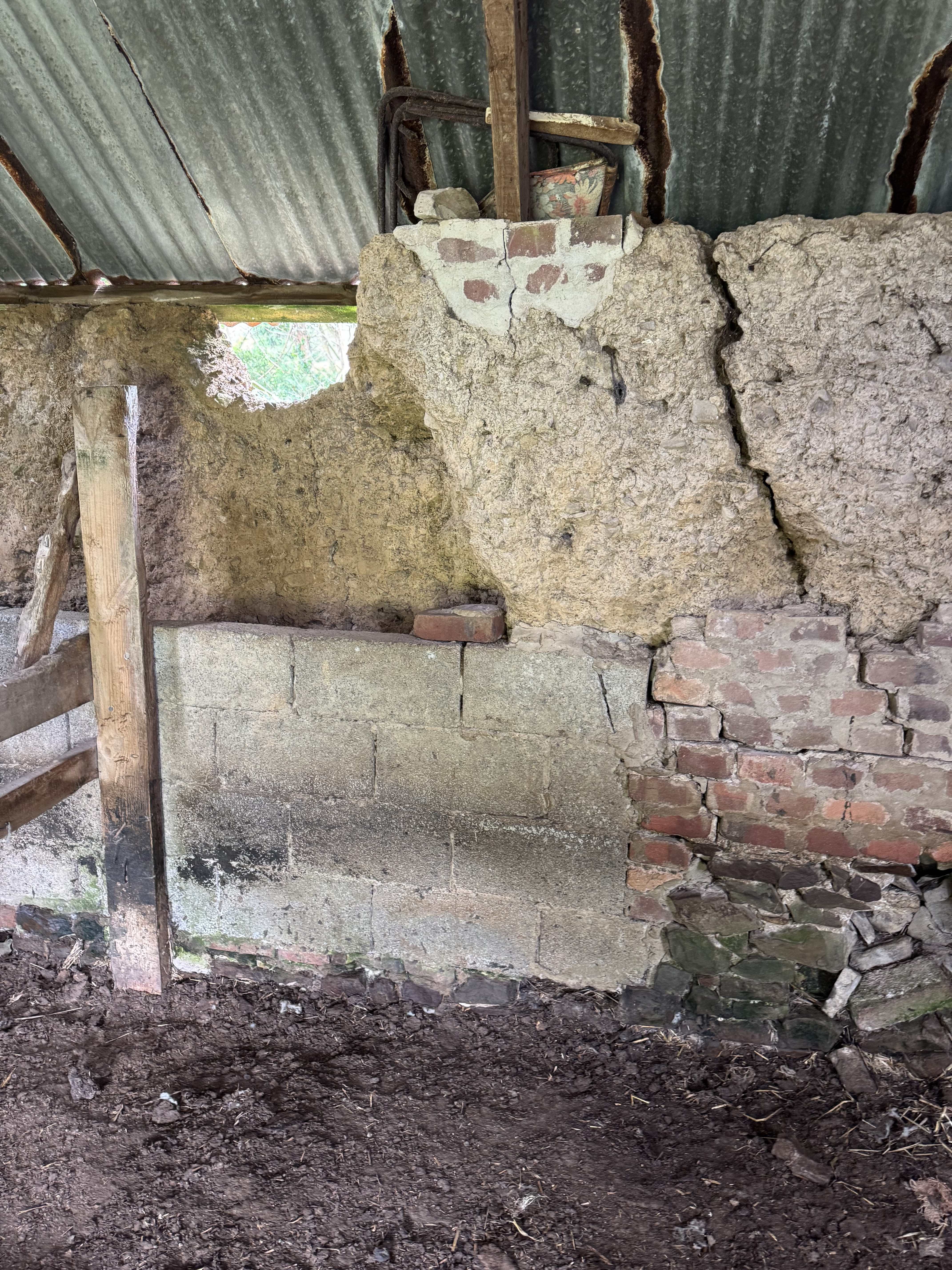

Hello all, Whilst I've been on the site a while, I thought I would introduce myself and the new exciting (to me) project that we are at the very early stages of. After the fun and games of the purchase process, we are now the proud owners of a barn in Cornwall and today, we have also received our class Q notice. The barn now has permission to convert, a secondary class Q and we are in the midst of a redesign to go back for full planning permission under betterment. As you can see from the photos, a fair bit of work is needed.. But we feel very lucky to be in this position. Current status is that the previous tenants (Rams) have been evicted and we are moving on to getting utilities to the site! I will probably start a blog if I find the time! May the fun begin!
