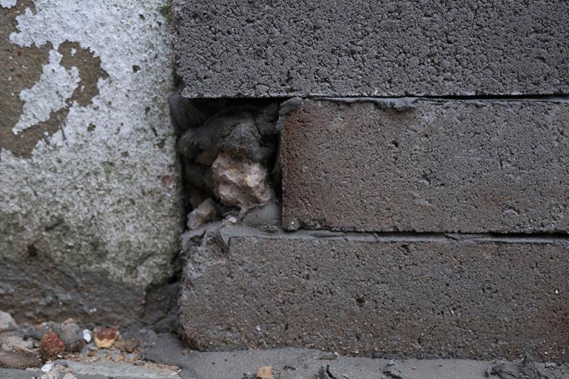

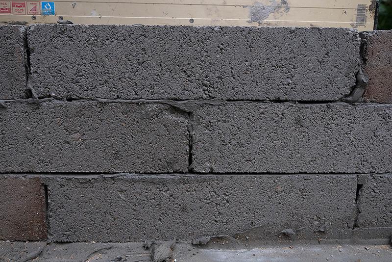

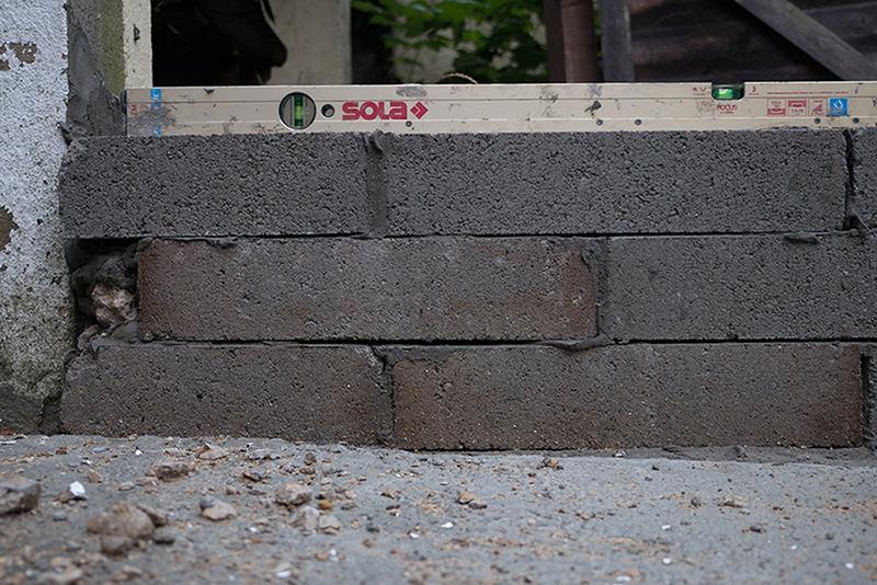

I'm have a floating extension built, it's early days. The builders have put up the columns & started to build a load-bearing wall but when I came home & saw the work, it didn't feel me with much confidence. I've attached pictures. There are gaps in the mortar & the fact they have used rubble for some of the brick work can't be right. I wanted to ask people with more knowledge about this than I have. Should I stop this job & find another builder?

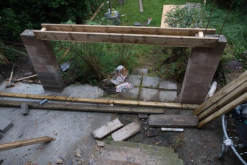

Yes, they're going to cast a lintel. The last 2 pics are the start of the columns the extension will stand on.
There is virtually no Mortor between blocks, stop it now.
I agree, although no expert, I would not be comfortable or confident that their work is going to improve beyond this standard as the project unfolds. As mentioned, there appears to be insufficient mortar between the blocks and as for the "rubble" used as back filling, I'm afraid it all points to a shoddy and cheap approach by the builder. Tell him so and agree to part ways.

What are though columns bearing onto?
Thin mortar and random inserts do not instil confidence.
What is the right hand column standing on….. all looks pretty sketchy to me and I am pretty bloody sketchy.
Hard to tell from photos so some of my comments might be wrong but..
The foundations look suspect/unclear to me. Have they reused an existing hardcore patio base or did they dig trenches?
The design looks odd. Two pillars like that are very vulnerable. Would expect at least one to be tied into a wall. Are Building Control involved? Have they seen drawings or inspected the foundations?

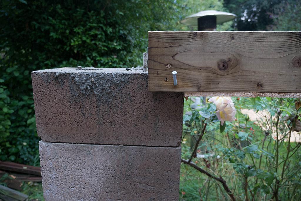

The form work for the lintel looks wrong. Doesn't extend far enough to the left? Bearing ends should be 100mm (?) at least so not long enough?  The wood  spacer blocks look to be in wrong place and will create voids in the lintel. Perhaps it's unfinished or not what they plan to use?

I've never seen a concrete lintel that big. Is it going to be reinforced with metal bars? How does it compare to your structural engineer's design? You have got a structural engineer right?

Oh god no. you could push those piers over. Unless those rebar columns are tied in to piles below the base of the block work? I don't see any evidence of footings?
As other have said it's difficult to tell on this without drawings. When you wrote floating extension I envisage something more like a cantilevered 1st floor with steel columns for support.

Looks like the lintel they intend to cast is only going to have 25mm of bearing too.

I disagree somewhat about the mortar beds. What we see is not particularly pretty, but in close-up, I don't think they are overly thin, and a knob-end filling in that gap, whilst not the pinnacle of best practice, is not unusual. The important thing is, is it all straight and plumb?
But has the building inspector been involved in this at all? It may come under permitted development rights, but it still has to be built to a satisfactory standard. Who designed it? Others have already asked, but what do you mean by a floating extension? Surely you don't mean one just sitting on the ground, do you? I ask, because suitable foundations are hard to spot in any of your pictures. No sign of any trenching, or of a raft.
And as has been said, if that lintel shuttering is complete and all there is to it, the finished lintel will have badly inadequate overhangs for it to bear upon the columns. In fact, I would feel better if those columns were buttressed in some way, not just a stack of unsupported blocks, one on top of the other. Does the rebar go through into any foundations? Are they going to be tied in to the adjacent structure, and if so, how?
With the apparent lack of foundations, and inadequate lintel overhangs onto seemingly unsupported columns, I for one would not want to stand under that lintel.

I could be wrong, but I can't see any foundations. If the rebar isn't connected in to foundations, they may be strong, but the columns will have no stability.
It all look questionable. It looks like the columns and yet to be cast horizontal transfer beam are supposed to stop the extension swaying sideways. The right hand column has the rebar protruding.. as though you are going to make a rigid connection to the "lintel" The rebar sticking out the top of the column on the left is short and won't work to form this rigid type connection if the columns and "lintel" are to behave like a portal frame.
It may be that it has been designed so that the columns act as vertical cantilevers with the lintel just "resting" on top. In this case you will need some pretty "beafy" founds.
I would get your SE out pronto to have a look.

even presuming there are founds big enough for those columns -which there are no signs of
you want to see even mortar joints and if required to get height right ,then cut blocks  and keep joints even
I am guessing his thought process is that using "figure of 8 "blocks filled with concrete  will make good pillars-- and he don,t want to use a bought prestressed lintel  because he cannot lift it up there without equipment.
 the webs to hold shuttering together means the lintel will not go far enough onto blocks and will be very thin at those points--
maybe if he had used threaded rod and nuts nd had lintel ends of pillar  and was twice as deep --but not as it is
looking at the wood shuttering -the finished beam depth will be only4-5" as shuttering is only 6" deep and overlapped onto the block
-you wouldn,t even use a solid granite lintel that thin for that span -needs to be twice as deep with lots of rebar in it
 get professional advice--as in you pay for it  and pull that down
